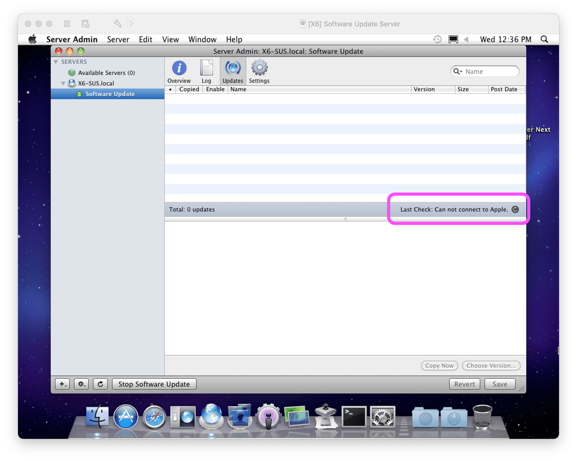

An update here. I got 10.6 Server running and it turns out that the file these Software Update Server instances connect to on Apple's servers now returns a 404... so Software Update Server no longer works :-/
I guess I will have to try that reposado project I linked above :-/
