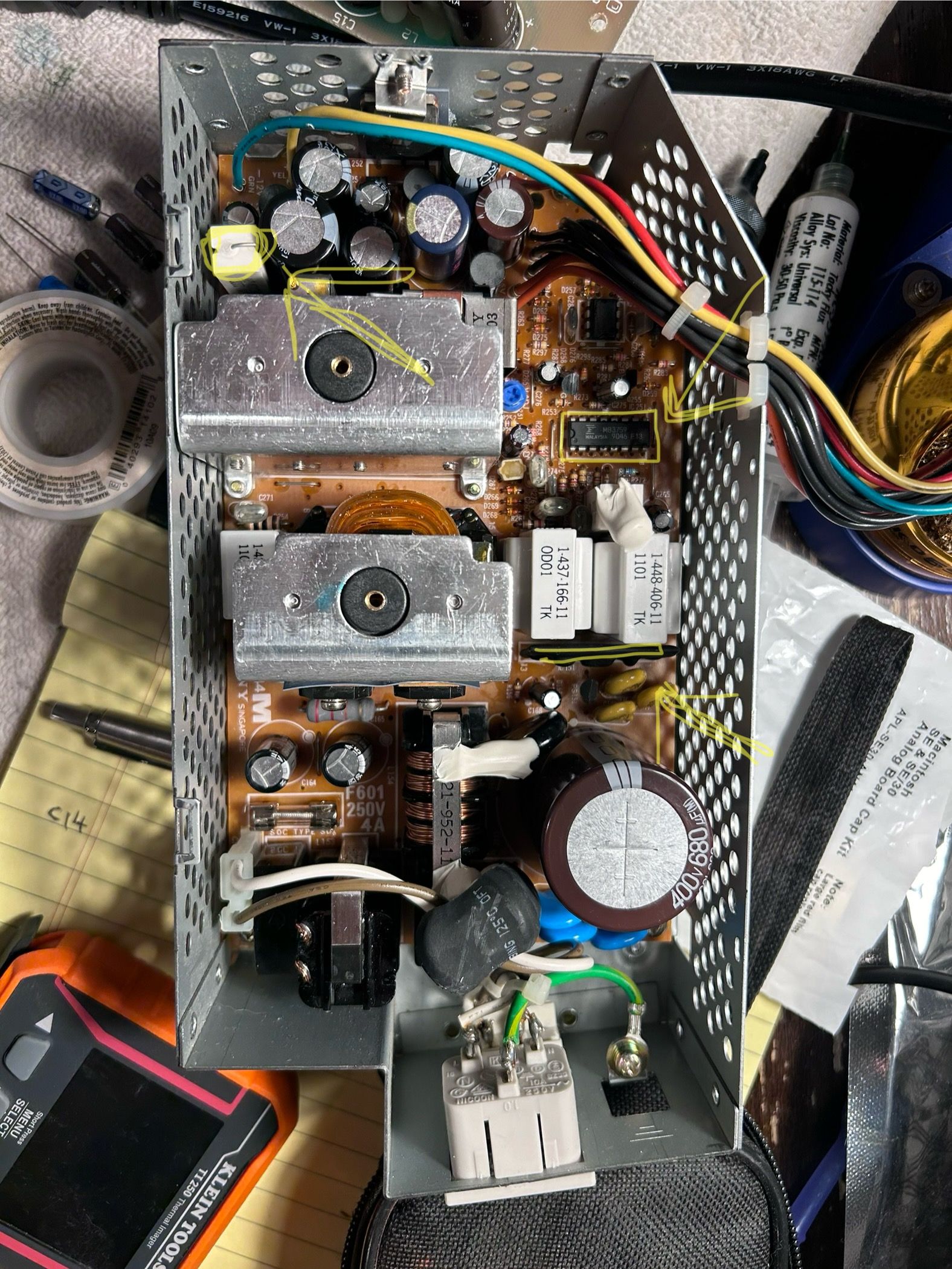

The unit was closed up with the clip and gray heat pad in place as if it was ready to go back onto the analog board. When I discovered my mistake, don't believe it was hot, but just a bit warm and definitely an "electrical smell". Not super strong, but definitely present.
I did leave it alone all day and retested that evening, still bad.
Thermal camera! Good call! I forget that I have one. I looked carefully and saw three points that were heating up. I circled them in the attached picture.

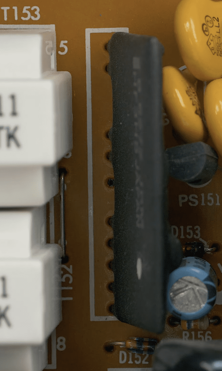

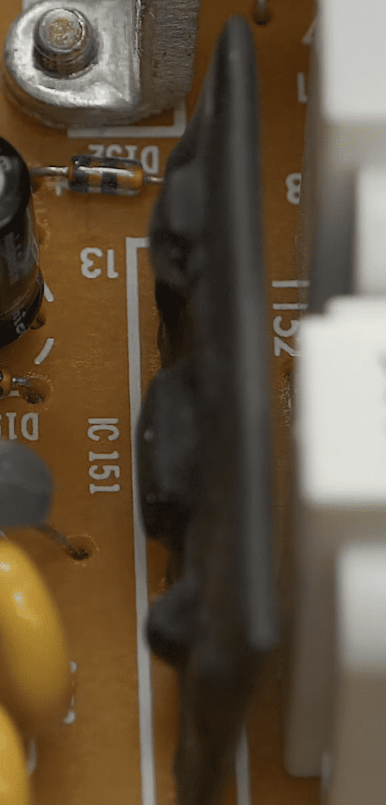

The resistors won't matter unless they are visually browned or blackened with heat.
The the black IC151 board shown was said to be hot, at 112°C, but I think that is normal...

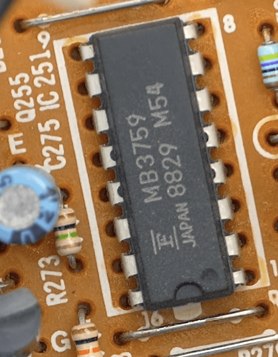

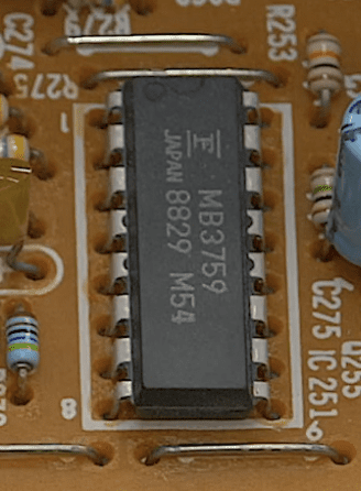

IC251 probably shouldn't be hitting 100°C (unless all your measurements were °F, and in that case, it would be 37°C, which is nothing of concern at all).
You didn't mention IC253, but it shouldn't be getting anywhere close to 100°C either...
View attachment 24089 View attachment 24093
View attachment 24090 View attachment 24092

I should have said, my temps are indeed Fahrenheit.
2,326
1,884
In that case, none of those temperatures are "hot."
