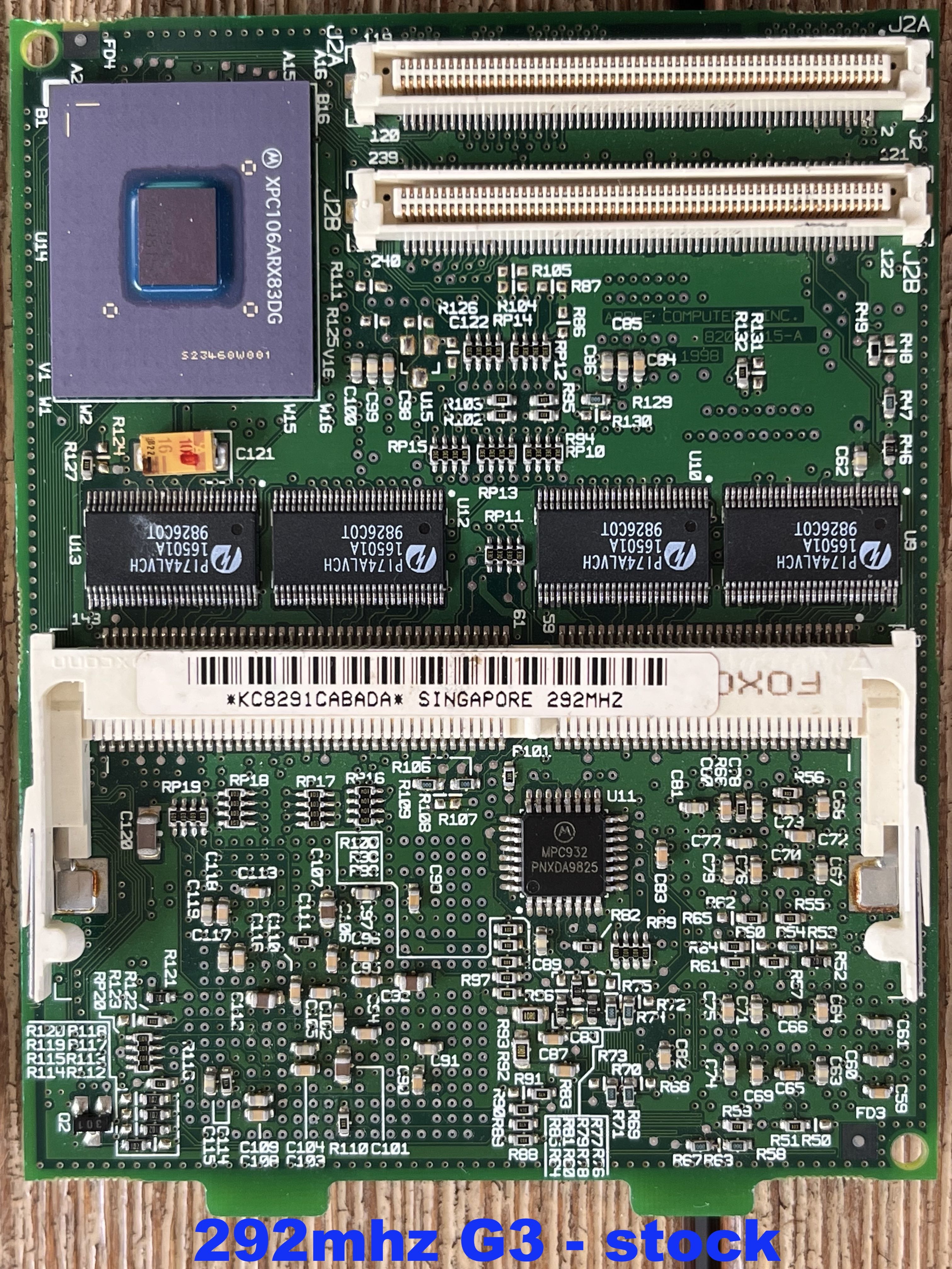

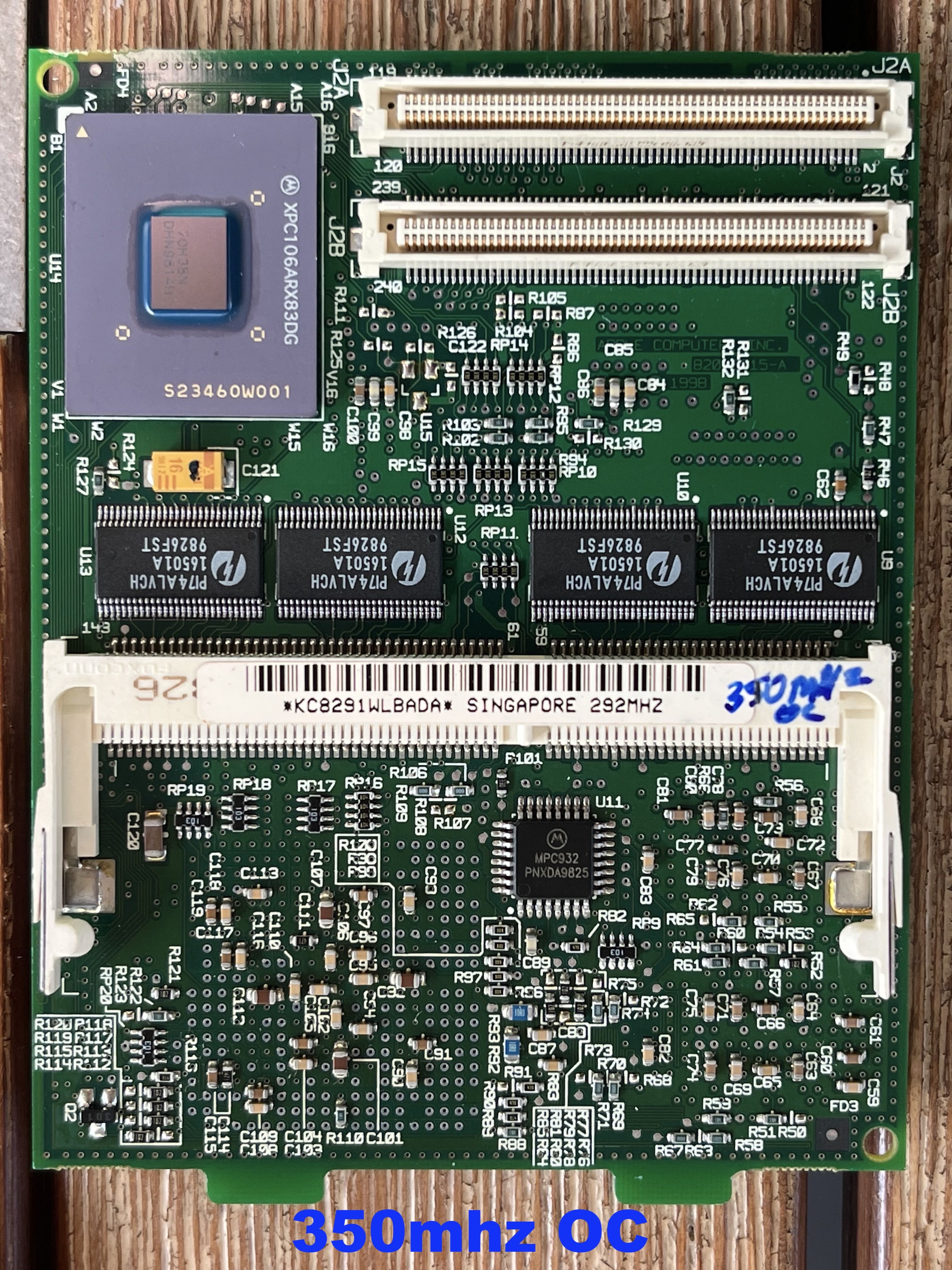

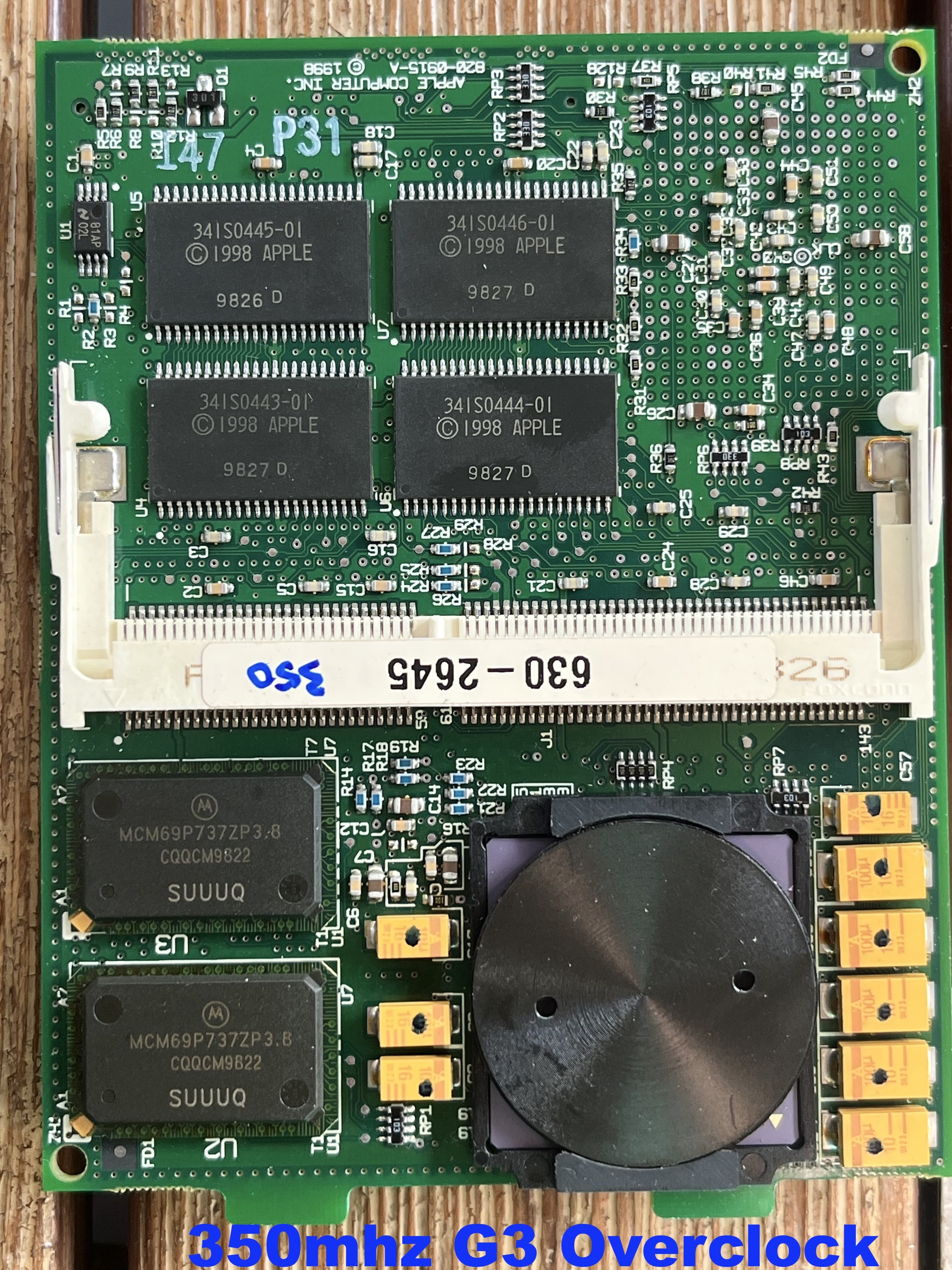

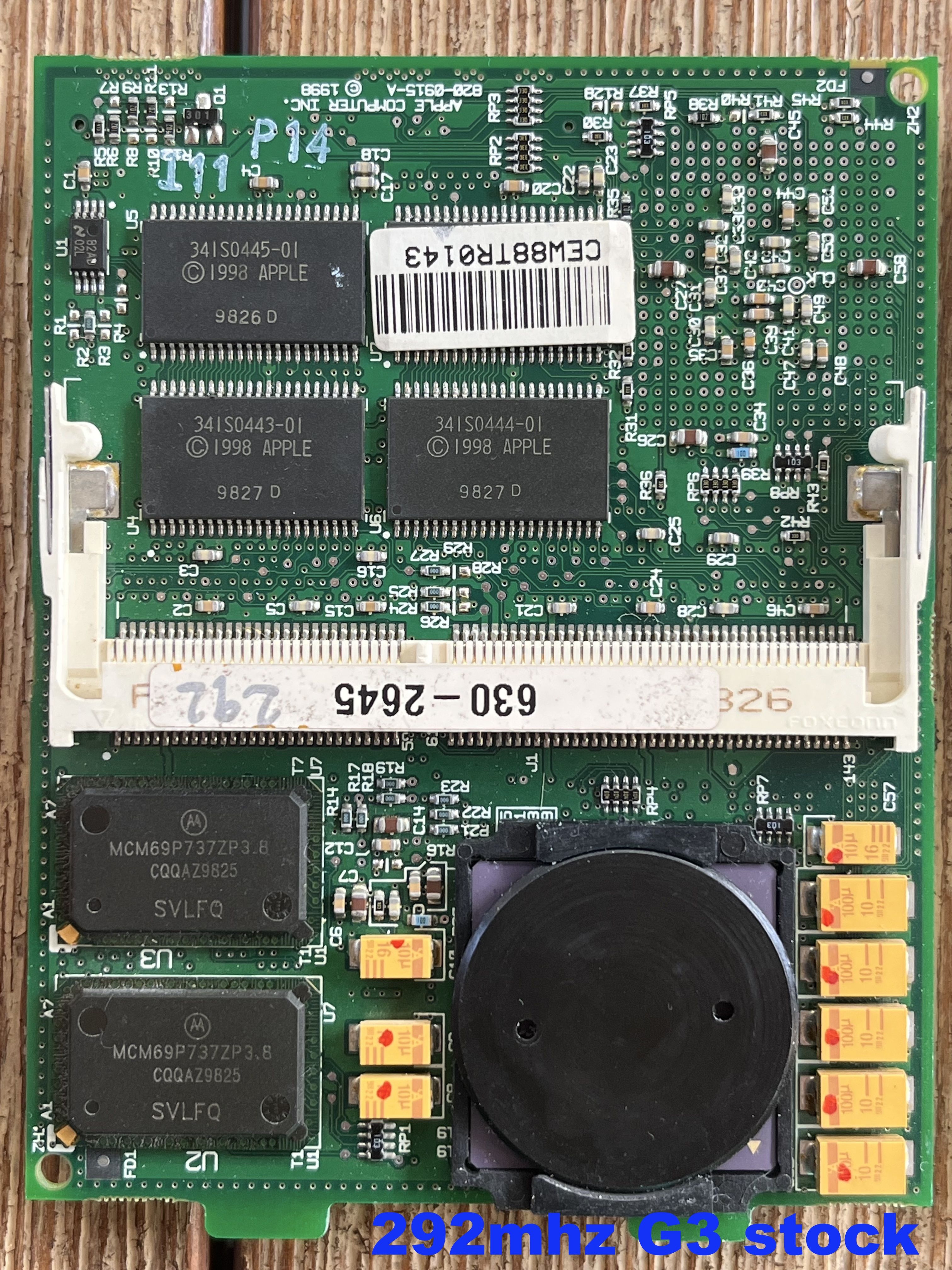

This is PowerBook G3 Wallstreet CPU, one is stock 292mhz and other one is 350mhz appears to be overclocked (overclocked from 292mhz to 350mhz), I thought I'd benchmark it - but it one came up very small amount difference.
Could you look in photos carefully and see what was changed/overclocked as I cannot work it out - both cards appears to be the same.
As you can see the multipliers on bottom left - R112 to R120 - those will be to multiply. On both CPU is the same.
also; bus speed multiply is R77 to R84 - one is for 83mhz and 66mhz - both CPUs are the same as both is 83mhz..
What I found about this 350mhz - it will not accept more than 256mb RAM as it will throw up memory error at boot up - Those memory cards are good working order as they're working in other CPUs.

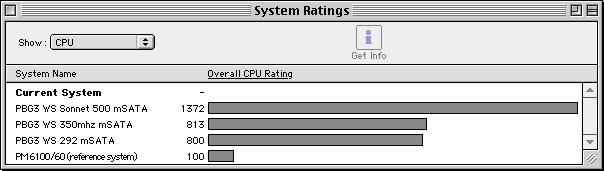

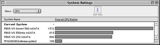

Screenshot of the benchmark results.
