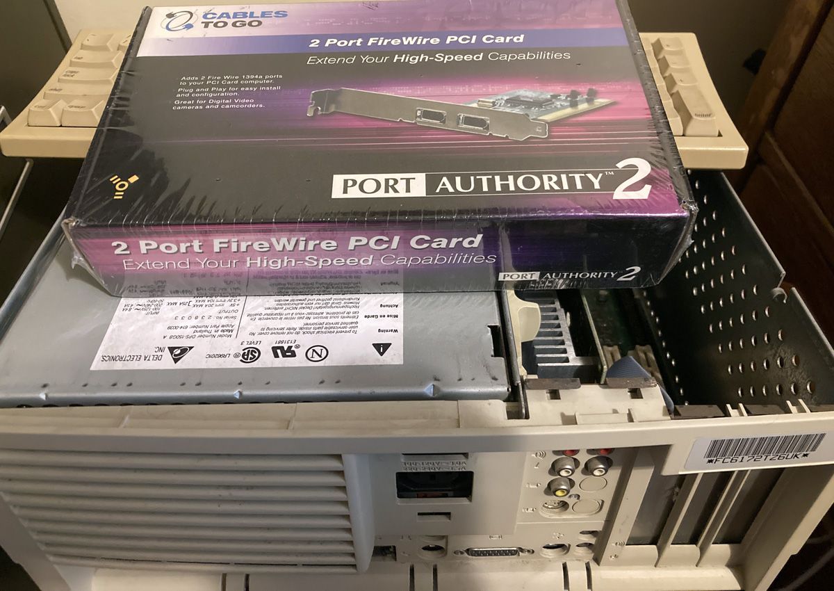

Power Macintosh 7600/120 604 with keyboard and mouse
-full of dust, cleaned
-Power button shattered, 3D printed replacement
-Internal Quantum loud and not recognized
-BlueSCSI external boots fine
Testing to be done:
-Alternate graphics cards
-Firewire cards
-USB cards

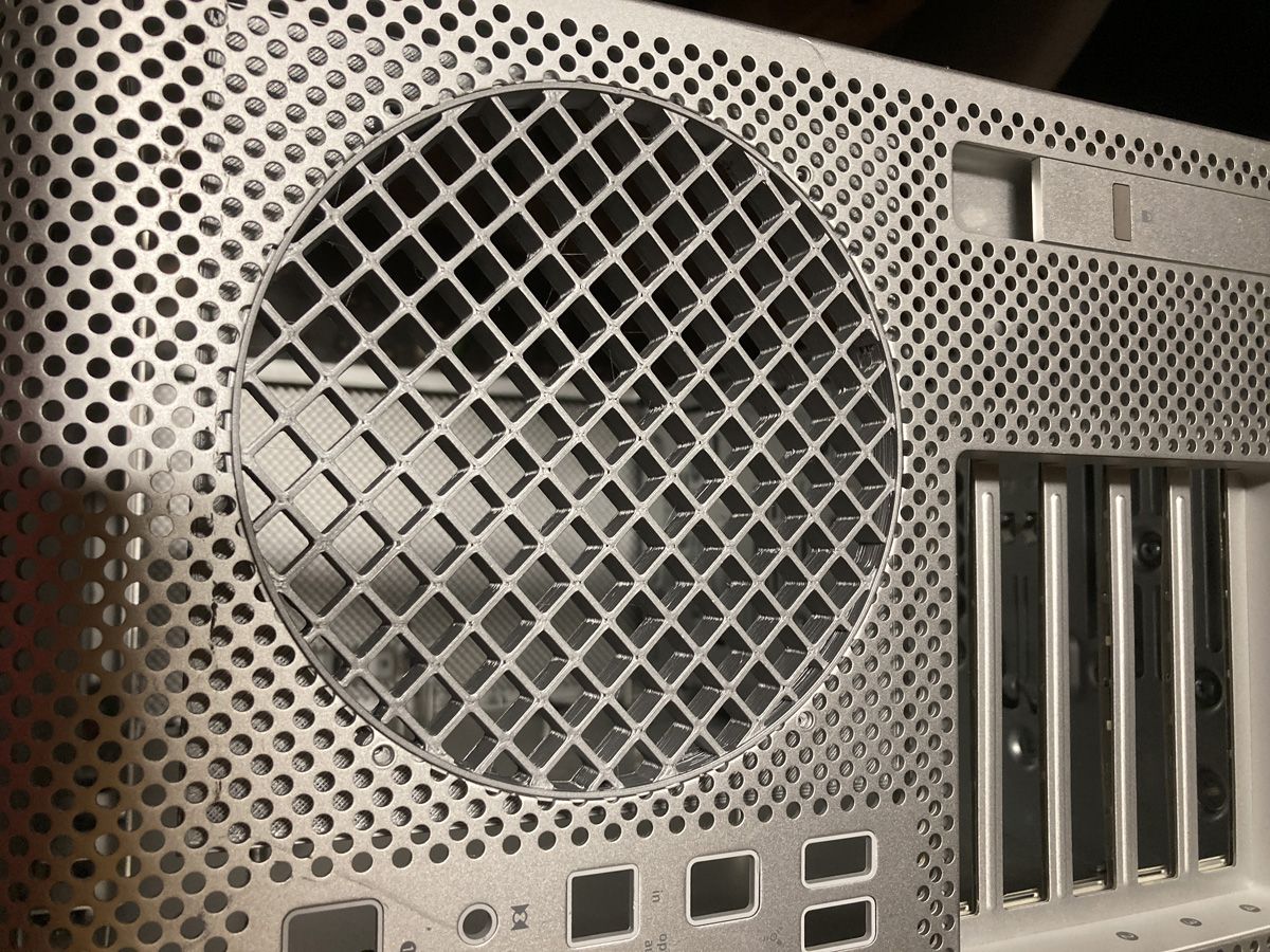

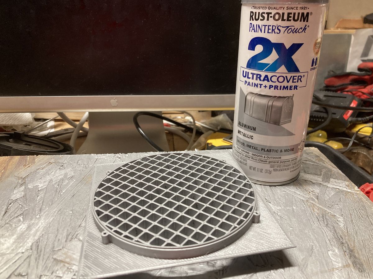

MacPro4,1 case missing door and rear grille
-3D printed grille, painted, installed

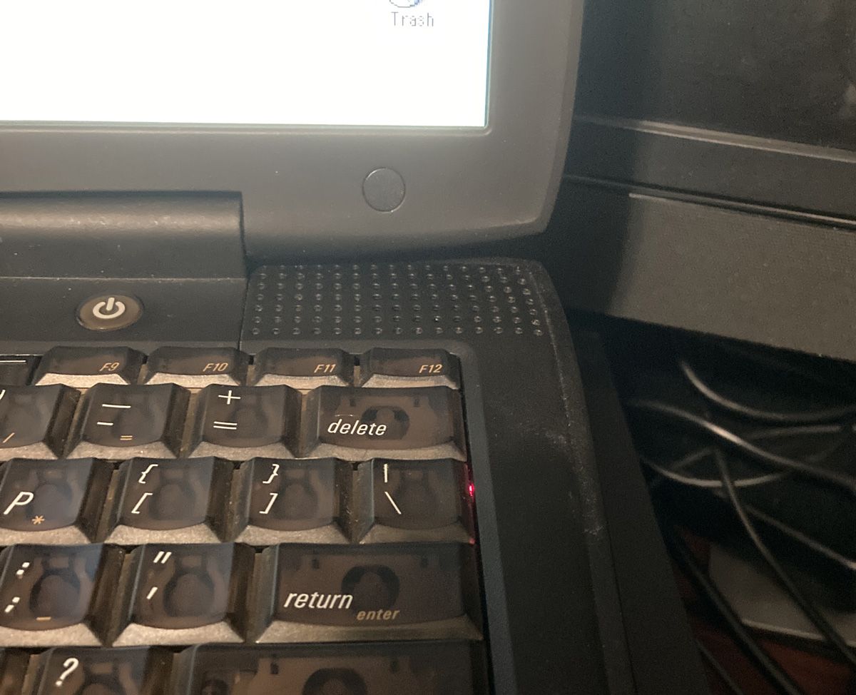

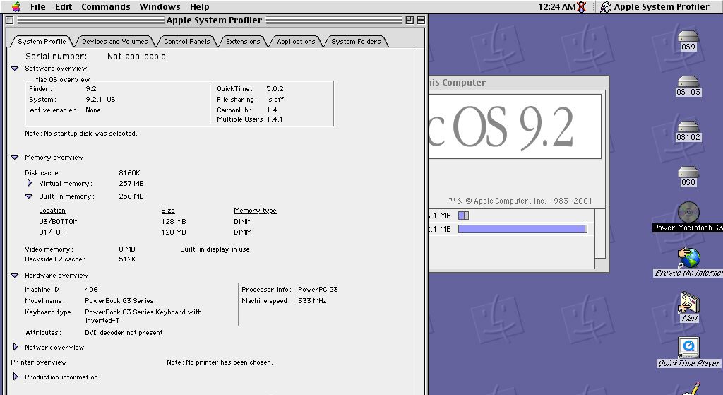

-PowerBook1,1 G3 Lombard 333MHz, no hard drive
-Borrowed power brick from 3400c
-Would not power on, battery shorted? Removed battery and get chime

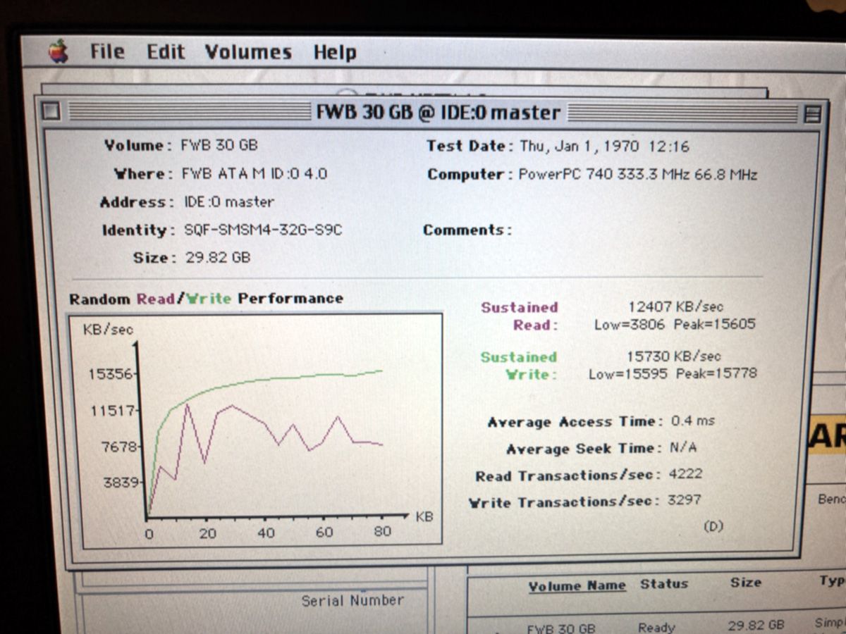

-Installed CF adapter (see the red light on the side of the translucent keyboard)
-Installed OS9.2

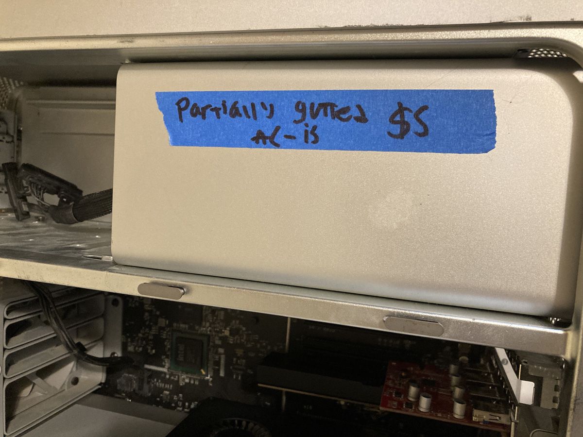

$5 Free Geek Minneapolis

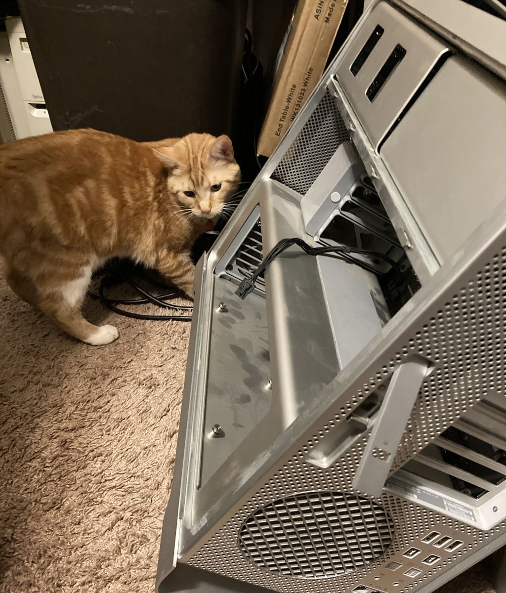

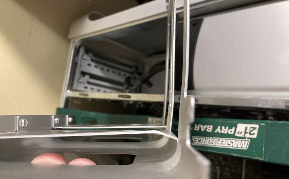

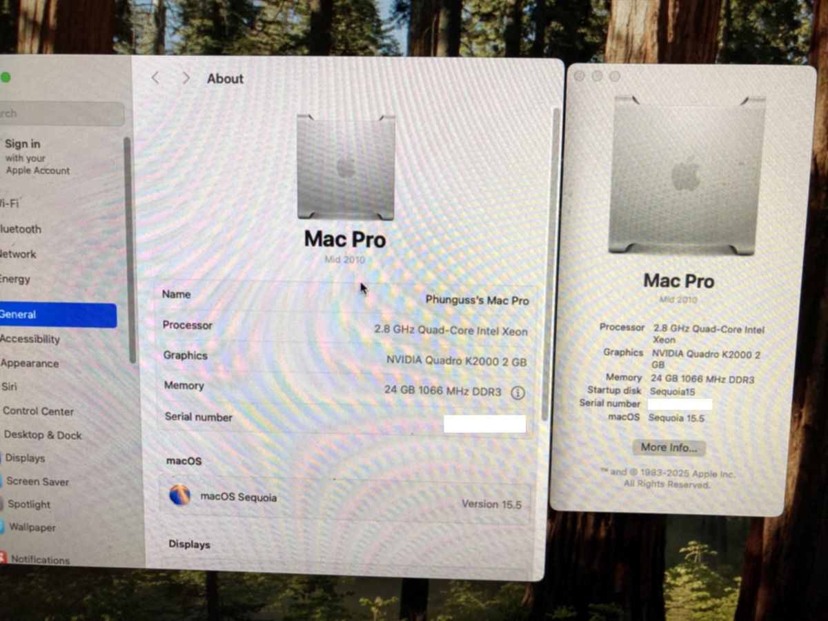

-MacPro4,1 "Partially gutted, as-is", loose parts rattling around inside, optical drive tray will not come out
-4GB RAM, no drives, no drive trays, HP FirePro V3800 graphics (untested)

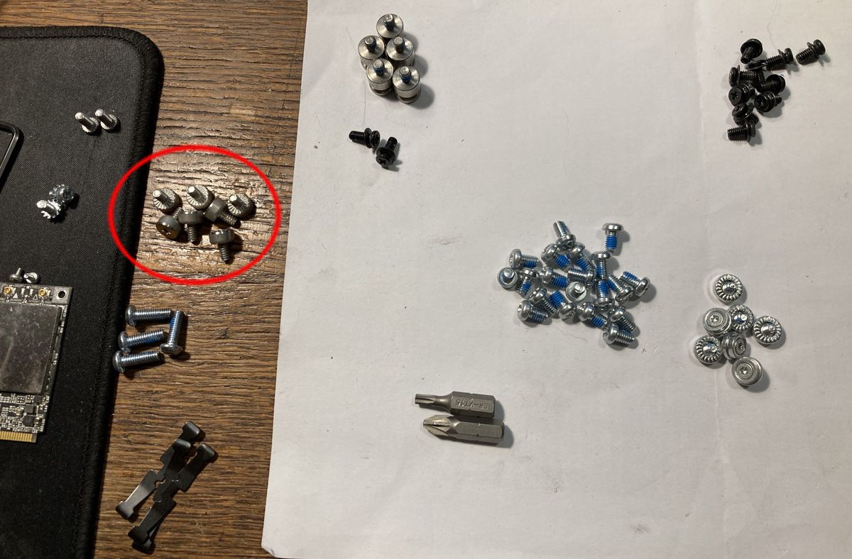

-Stripped down, found 7 loose hard drive screws. No other missing parts.
-optical tray was bent, but recoverable, removed burrs
-Upgraded wifi from b/g to b/g/n
-Installed NVME drive
-Installed USB3 card ($1 Free Geek)
-Upgraded RAM to 24GB
-Installed Quadro K2000 (keplar) video card
-Installed Sequoia 15.5, Mojave 10.14
Had to have a "cat scan"
Loose screws found behind mobo
Bent optical drive tray, but fixed it.
