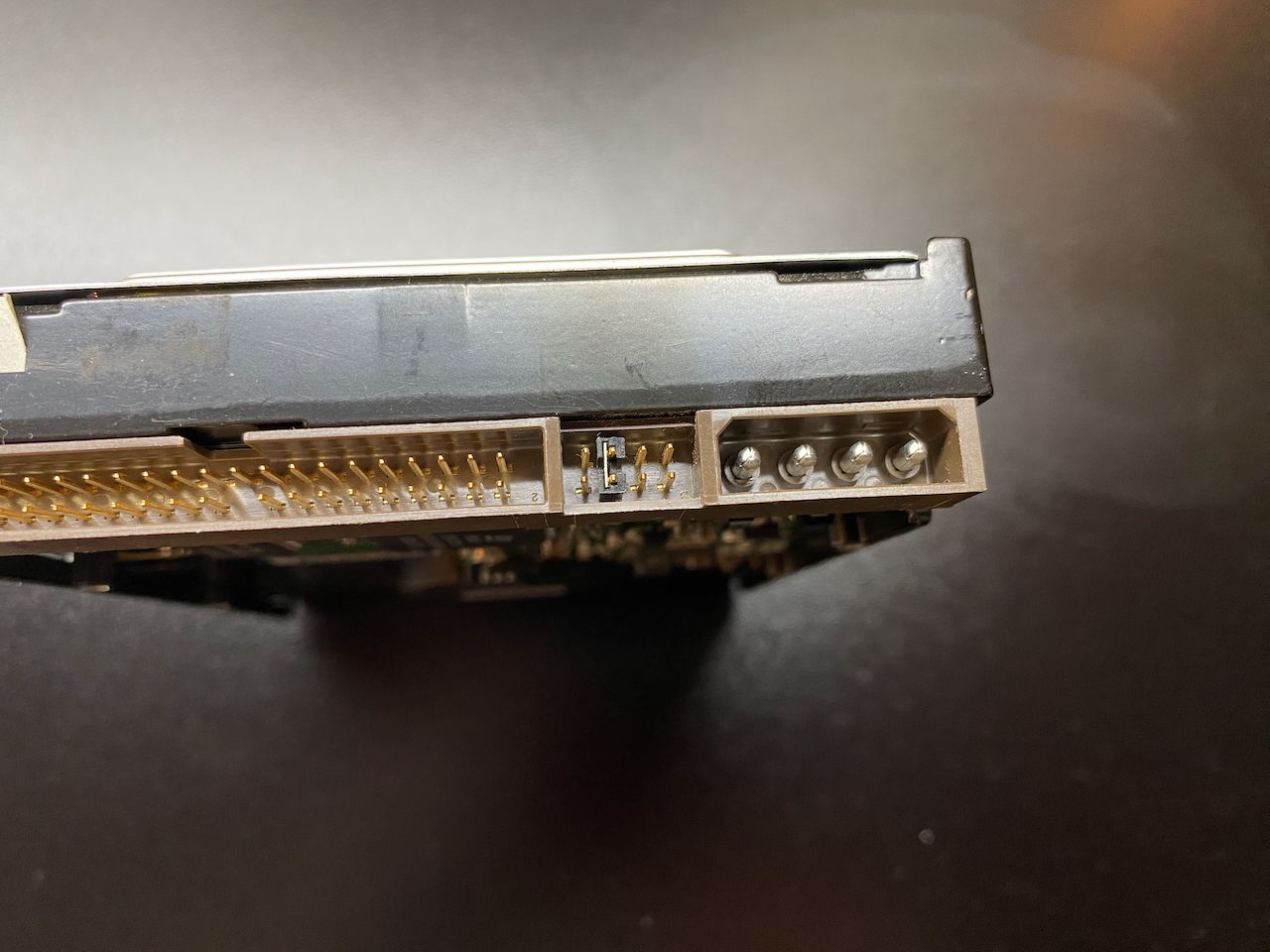

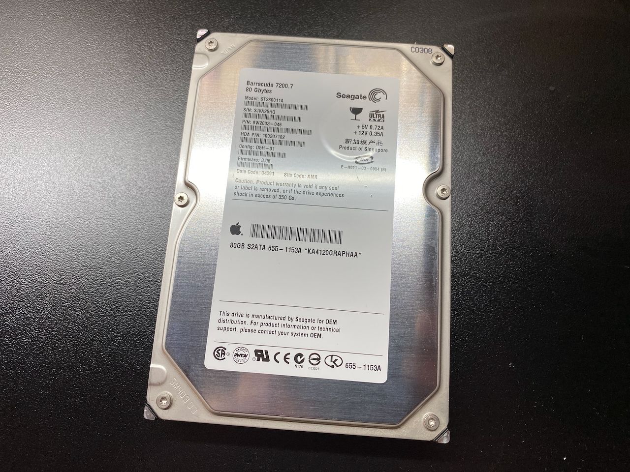

There is no information on the original HDD about its jumper settings, so I have no idea what it was set to from the factory 🤷🏻‍♂️ Guessing this is probably Cable Select also? No idea. Some photos of the original HDD with Mystery Jumper™️:

I've tried both of those options using the existing controllers, if that's what you mean. There is no way to swap the IDE cables around in different ways, given the extremely limited space inside the machine.
There's a very short cable for the hard drive that connects to one controller, and a longer one that goes to the optical drive.

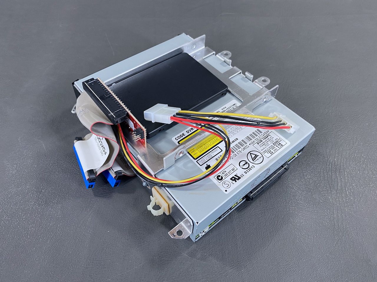

Following up here to say that after one final re-attempt to install Panther using the drive configured to cable select mode, the iMac has now been working flawlessly. Boots up quickly every time, wakes from sleep with no issues, and is also super speedy (and much quieter) now with the SSD.
Not sure why this didn't work the first several times, but not gonna ask any questions! Links to the products I used to get this working are listed at the bottom of this page, for any future tinkerers.

I'm glad you got it working! I also struggled with this. I even thought I went to the "easy" and expensive route by buying the SSD from MacSales.com. I thought it must be an actual IDE SSD, but no, it turned out to be a regular SSD with one of these adapters. I ended up spending several hours trying to get it to fit in the iMac. And I barely succeeded, the IDE cable barely reached the logic board. I even tried crazy solutions like removing the actual board from the SSD enclosure. The board in the SSD is like not much bigger than a compact flash card 🤣. But the adapter was just so big and unwieldy I couldn't get it to fit anywhere safely.
