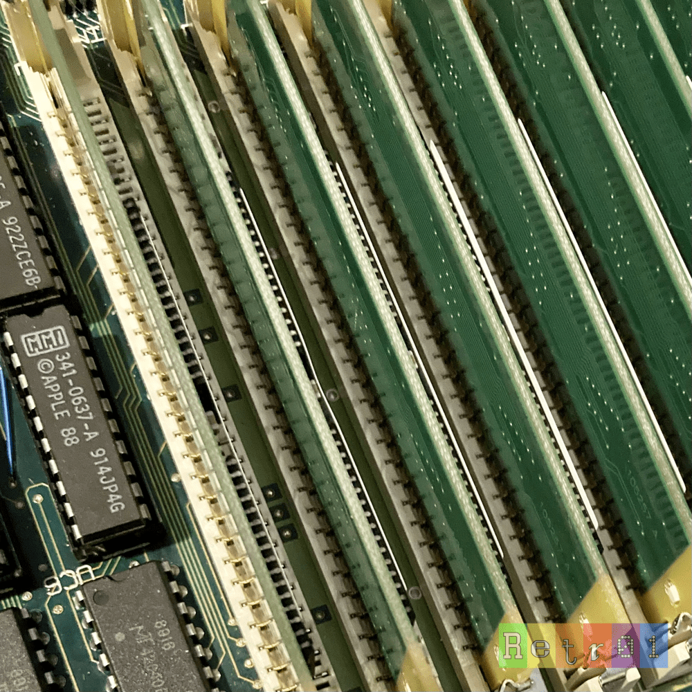

Yesterday, I received the boards for my SE/30. I put together my SE/30. It took me a while. By the time, I turned it on I was greeted with a checkered screen:
I stayed up all night, working on my precious SE/30. Before the "smoke test," I pampered my SE/30 with the Rominator II from Big Mess O' Wires (BMOW) and 128 MB of RAM (16 MB SIMMs from Keystron). By the way, I want to clarify that a new battery is installed now.

can we ensure the aged slots are making contact with the ram and rom?
I've added a layer of solder to all my sticks to alleviate these symptoms.
(maybe not the case here BUT... usually is an issue)
New SIMM sockets. Professionally done. Test passed. But I indeed could double-check. I want to rule out bad RAM SIMMs, although that's rare.
I doubt the ram would be suspect, those new modules are using the appropriate PCB thickness (I'm assuming here).
Reproductions like the ones I built are only available in 1.2mm (1.6mm is too thick) so adding solder to the pads is the only guarantee even new sockets will touch the pads.
For the screen to boot as such though I'd think the ROM, unfortunately BMOW ROM also has the same thickness issue.
Yeah, BMOW Rominator II is about 1.2 mm thick. I noticed the ROM SIMM 64-pin socket has a mechanism that pushes the contacts from the left side to be snug. :geek: Still, need to solder on the Rominator contact pad on one side? :unsure:

Wanted to quickly show you how I do it, there's nothing wrong with you trying this, most solders have a bit of give with insertion so it will ensure at least that THIS isn't the issue.
Thank you for showing me @Drake. :)(y) I wonder, is that method ensuring the solder is applied evenly across all contacts on the bottom of the SIMM stick? :unsure:

So, I noticed that the Rominator SIMM isn't pushed all the way in, even with the new metal clipped 64-pin socket. I noticed there is a gap from the chip side of the stick to the inside edge of the slot while the SIMM stick is still not upright vertically 90 degrees perpendicularly to the logic board:

Well, I could not find the heavy-duty paper clip at my place. So, I attempted shimming black thin plastic pieces on the back of the Rominator SIMM stick on the sides. Added rubber bands to push it a bit more upright. That did not work out, either. 😖 I asked a friend of mine to print the plastic clips by @PotatoFi.

Right. I went back to the original ROM for now. The problem is that the BMOW Rominator will not seat well in that 64-pin SIMM socket even though the socket is brand new. The original Apple ROM stick is thicker than the BMOW Rominator ROM stick, so it seats fine.
Once I get the printed clips, I hope to seat BMOW Rominator better. :)🤞
