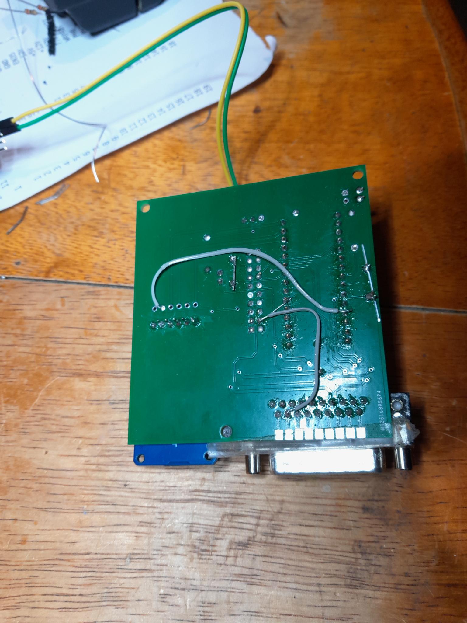

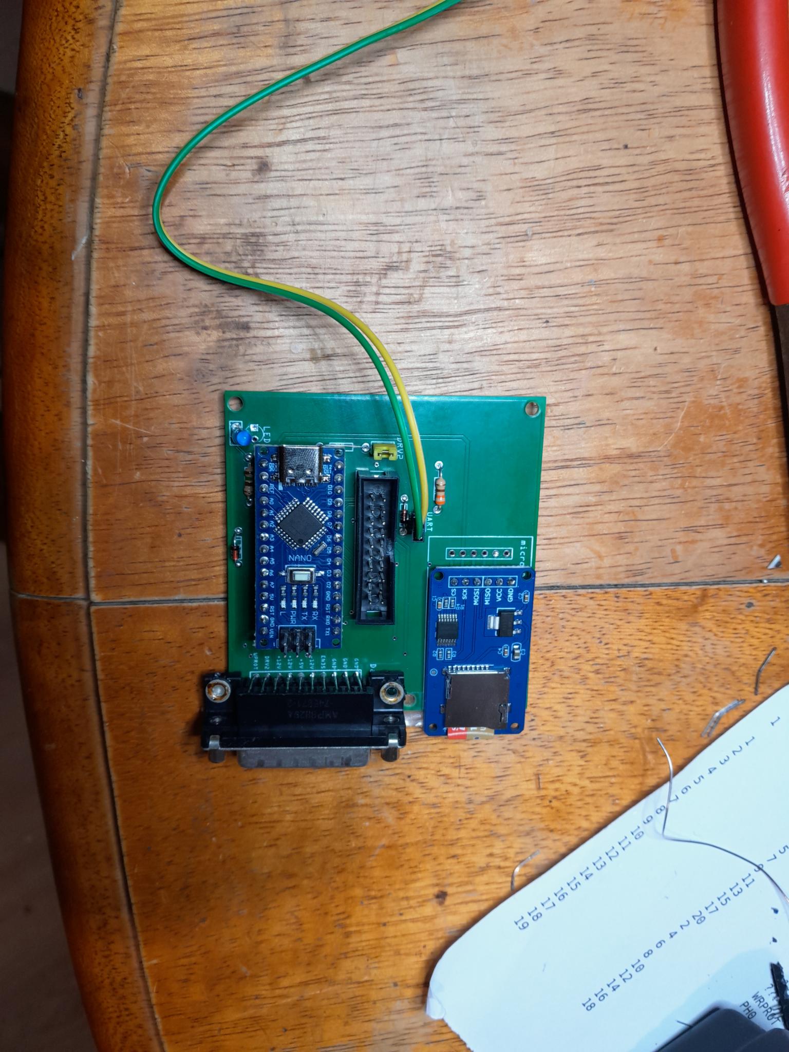

The prototype PCB shown below had issues, so I'm waiting for revised boards to arrive before releasing anything, but it should be a matter of weeks.

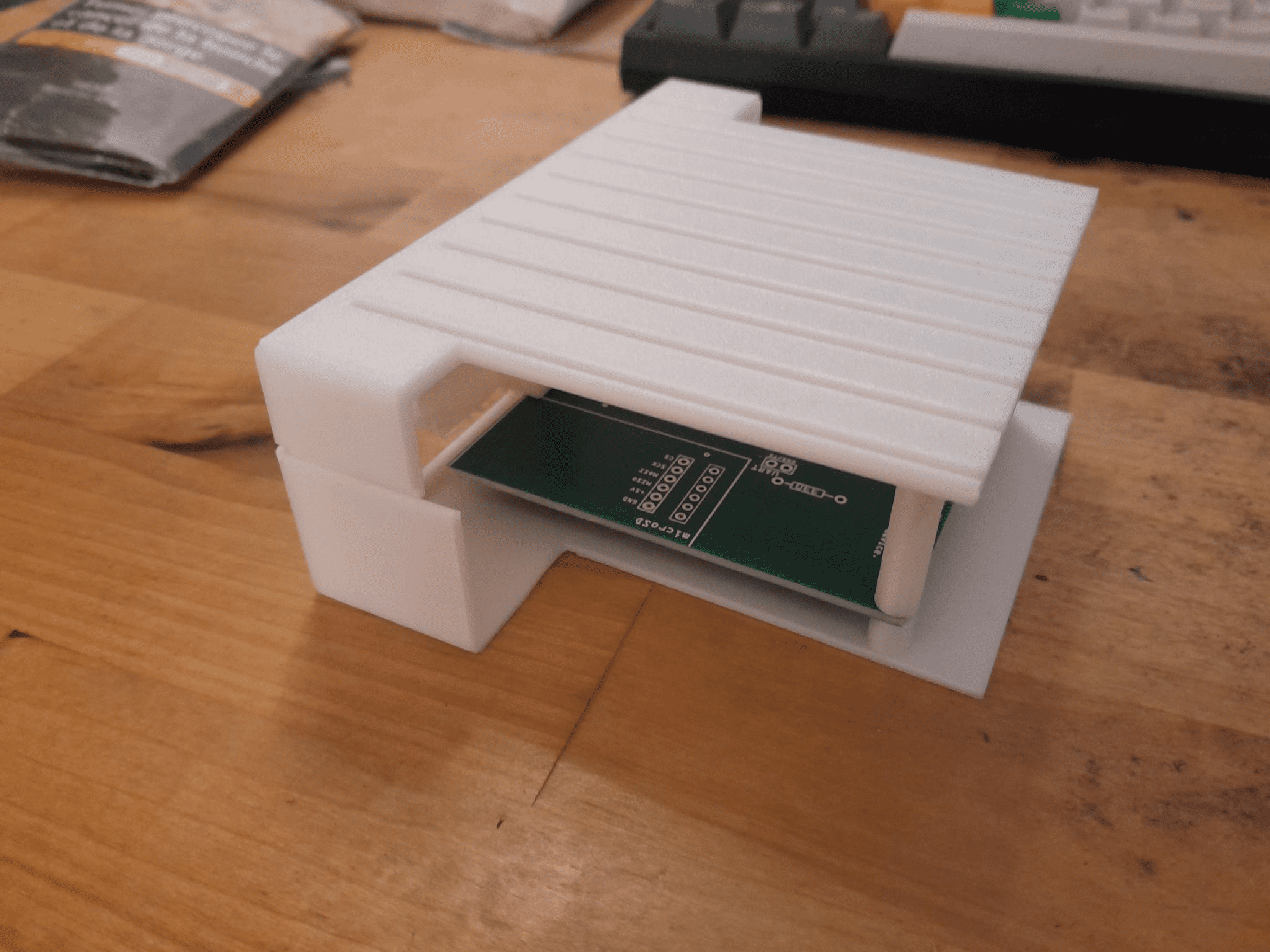

I plan on providing an enclosure matching the Unidisk 3.5's (just a bit flatter).

Here are pictures of the first PCB (complete with bodge wires):

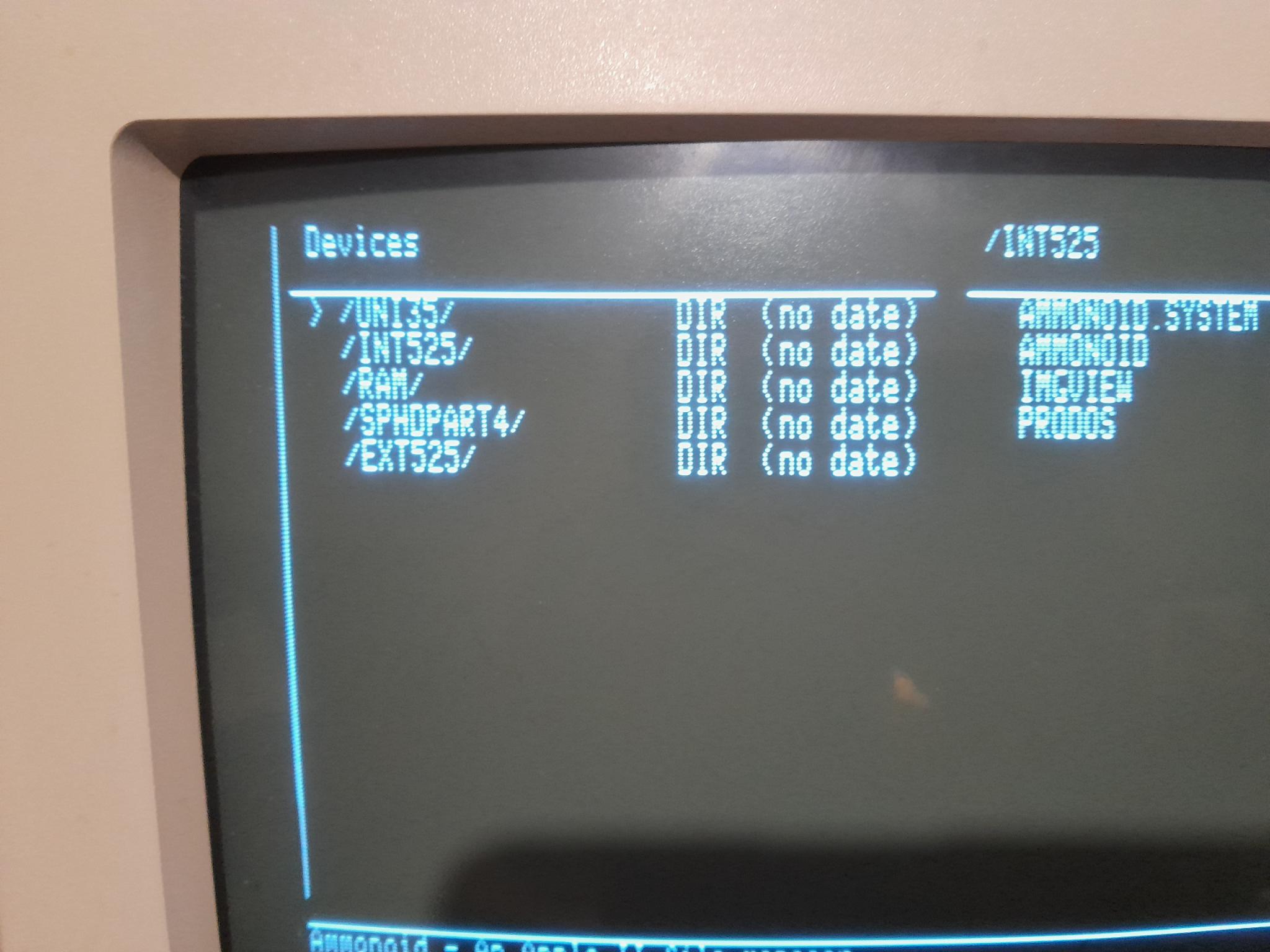

And here is a picture of my file manager, listing all the available volumes on a //c + Unidisk 3.5 + BurgerDisk + Disk //c:
