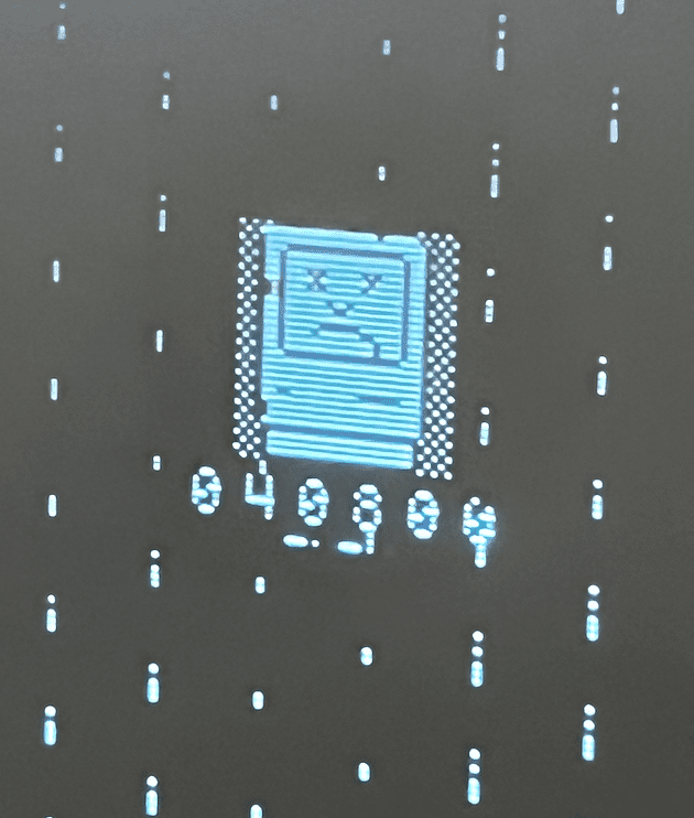

... you've spent a good few hours preparing to record something for work featuring your 128K Mac... and then...
...the DRAM chip at G8 goes and takes a dive...
I don't have a handy supply of 64K bit DRAM chips floating around unfortunately... well, apart from a few restored C64's.. hmm... 🧐

Yup, original DRAM chips.. 35+ years of reliability then *poof* - outrageous! :) Anyway, here's the culprit. I struggled to get him out (ground plane!) so ended up snipping the GND leg and removed rest with flux and wick.
Put a socket in and a replacement NEC brand 64Kbit 150nS chip that I found in my piles of C64 stuff. Powered straight up without issues. Yay.
