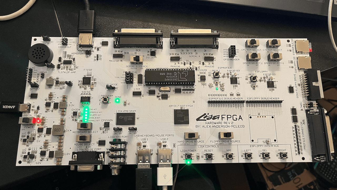

Over the past 8 months or so, I've been working on implementing a fully-functional Lisa inside an FPGA, and I'm happy to announce that I'm just about done with the project!
I've designed a custom board that contains the FPGA and all of the Lisa connectors and interfaces that you need in order to hook it up to the outside world. I've also added some nice modernizations, like HDMI audio/video output, USB keyboard/mouse input, onboard ESProFile-based hard disk emulation, and overclocking up to about 4x the Lisa's stock clock speed. There's also facilities for onboard floppy disk emulation, and I've written some early code for the floppy emulator, but I haven't tested it and I don't want to 100% guarantee that I'll be able to get that working. You can always just plug up a Floppy Emu or real floppy drive and be fine.
I've tested the FPGA-based Lisa implementation quite extensively, and it seems like it's really rock-solid at this point. It can run every OS that's supported on the Lisa (including obscure ones like GEM), and doesn't really have any limitations compared to a real Lisa.
It's not on there yet because I want to apply all of the finishing touches first, but once everything is 100% done, it'll be open-source on GitHub like all of my other projects. I need to test the final revision of the PCBs before I get to that point though.
Speaking of the final PCBs, I'm going to be at VCF Southwest here in a few weeks, and I was thinking about ordering a decent-sized run of fully-assembled boards to sell to people at the show if there's enough interest. Keep in mind that this may not happen at all depending on when I'm able to get the order in and how long they take to make them, but I think it's worth putting out there in case there's interest. To judge demand and see if this is even a good idea in the first place, are there any people on here who are going to be at VCF Southwest and would like one?
If you want more details about the development process, head over to the LisaList2 forums where you'll find quite a few posts (I think about 100 by now) documenting the entire process from the very beginning until now. I'm also going to be doing a presentation on this project at VCF Southwest, so feel free to come to that if you're there and you're interested!
And one more thing: If you want to see it in action, here's a YouTube video giving a quick demo of the board and an explanation of its features.

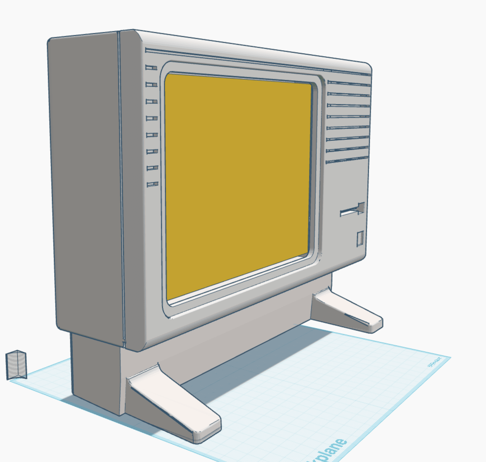

Got my board on order from @jcm-1! I was thinking about some of the other projects that have stuffed vintage (or modern) guts into new cases and started scheming with ChatGPT about ideas for a way to pay homage to the Lisa while enabling this modern hardware that Alex has created. This is the design it helped me visualize:
While the back and the side vents aren't great, The Lisa FPGA inside of a 3d printed case like this would be so cool to have on the desk. Unfortunately, my 3d modeling skills are the equivalent to a toddler, so the model I ended up with lacks a lot of the polish of the rendering by ChatGPT:
The colors are different to help me visualize the different parts. But the dimensions are sized so that they should fit a 9.7" iPad LCD (I find them to be easily procured along with controller boards to work as HDMI displays). The downside of this size is that the overall width is 330mm. Too big for most 3d printers, but I plan to try to provide a split model that allows me to print in halves and then glue together. Hopefully with the ability to make the seam not super obvious. I also added a small inset for an apple logo, that should fit nicely a logo from a SE, Classic, etc.
Anyway, Once my board comes in, I'll think through the mounting and inside component layout.
I also did a quick check on JLC3DP for the parts and they are pretty hefty for resin prints, but one of these in clear resin to go with my Clear SE/30 would be pretty cool. Unfortunately the total in clear resin was around $250 (not entirely terrible, and it's possible with model optimization I could get that down. I believe resin is priced largely based on the volume of material. I could probably do a better job minimizing unnecessary material. I might just print the front bezel in the cheapest resin they have to avoid seam lines and paint it all when done. We'll see.
Anyway, if anyone is an actual 3d modeler who can produce a model like the one in the mock-up, I would love to partner to try to make it printable.
I like the AI generated images, but the ports don't match the example board photo previously posted. Without the Gerber, it would be difficult to model an enclosure to match the ports, unless you intend to totally enclose the board and have jumpers or port extenders to the external case. I could spend time modelling the board based on the photo, but it would be much easier to wait for the Gerber.
Yeah, I was planing on simply mounting the board to the back side of the case, but the challenge with the FPGA board is that it has ports on all 4 sides. I'm thinking of mounting it with the USB ports being exposed through openings on the bottom, the HDMI port being the opposite side wouldn't be an issue because that would get routed internally to the LCD. The only other port I would likely need initially would be the power USB-C port. I would likely put a a power port that would power the LCD and the USB-C port off one power input. If I can have the power port be a USB-C port and have it split to power the board along with a USB-C trigger board to provide 12v to the LCD... I just don't think USB-C can be spliced like that. Worst case I extend the USB-C with a pigtail extender and have a separate 12v DC barrel jack extender for the LCD.
For now, I've got it modeled as a generic shell. I'll figure out mounting and wiring once I get the board in hand. I think the Gerber is available in GitHub, but my toddler level 3d modeling is based on measuring things with my calipers to position them. Someone who could import the Gerber and get a better sense for where things go would likely be able to do this much more quickly.
Also, there are things about the AI renders that I like, but that make 3d printing much more difficult, so some of my design is based on those compromises to avoid too much challenge in getting a clean print. Think things like trying to avoid supports on the final exposed surfaces. Some of that will mean more supports to allow the finished surface to be cleaner.

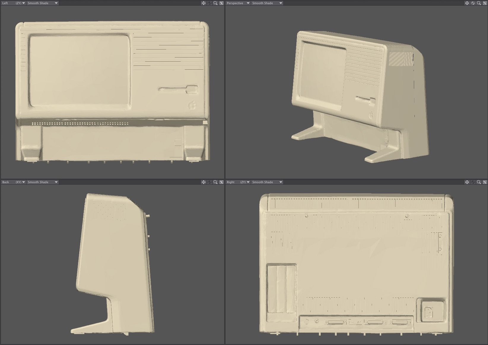

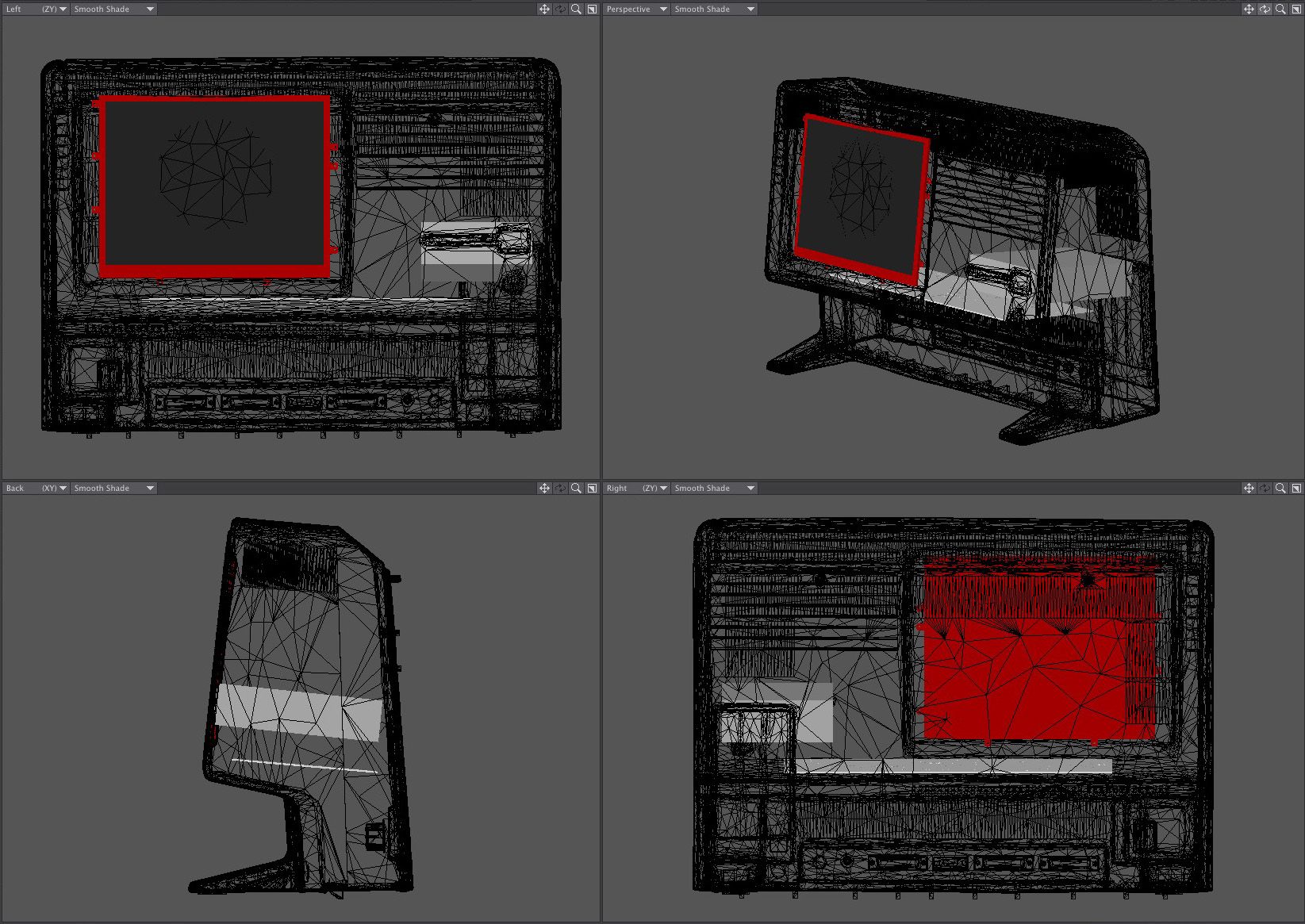

This is awesome. I love that it’s essentially a direct replica just shortened due to the lack of CRT. I was torn on my rendered version because I liked the modern take on the vintage style. Slightly cleaner, which would help with the 3d printing. But not at story to the original.
I also wondered about the port locations and I’m guessing it came down to convenience and possibly the fact that all the poets would have been nearly impossible to fit on one side.
I also was considering the idea of modeling a standalone case for it that would expose he ports on all sides, openings for the switches, and push buttons for the bottoms on the board. Then, trying to design the Lisa case to allow the standalone case as a backpack of sorts with openings for the HDMI and power to connect between the two.
Two benefits there:
1. People that don’t want the full case wouldn’t have to run a bare PCB on their desk.
2. People that didn’t buy the LisaFPGA could get the cheap iPad LCD and controller board and make a LISA monitor. They could throw in a raspberry pi and use the Lisa emulator to get a similar experience.
Not sure if we should start a separate related thread for the case design, instead of continuing here. I like the idea of it being an iPad monitor, with the option to add either FPGA or Pi. If I reduce it to 90%, the iPad screen fits better, but the floppy would have to come out the side like a //c.

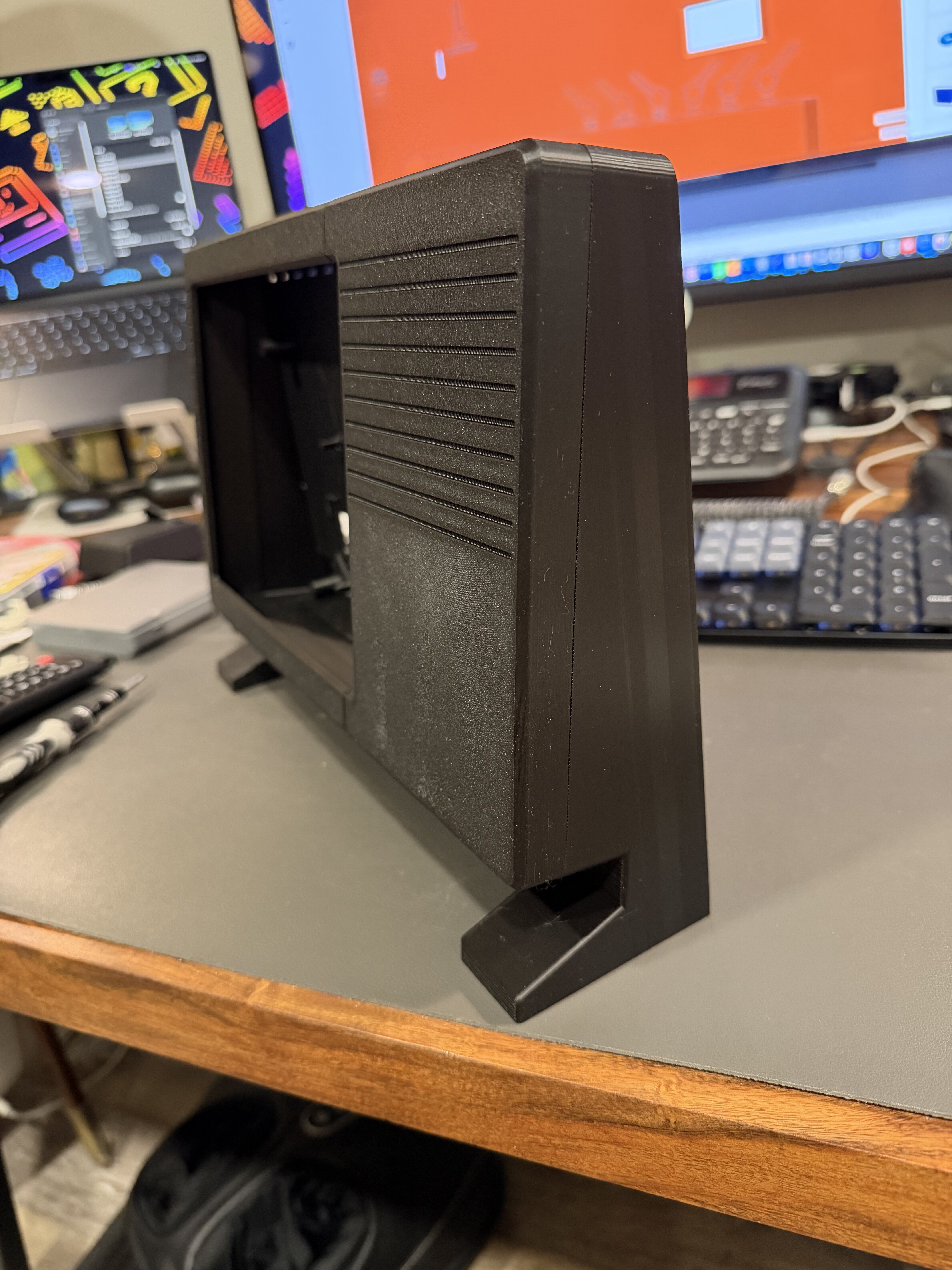

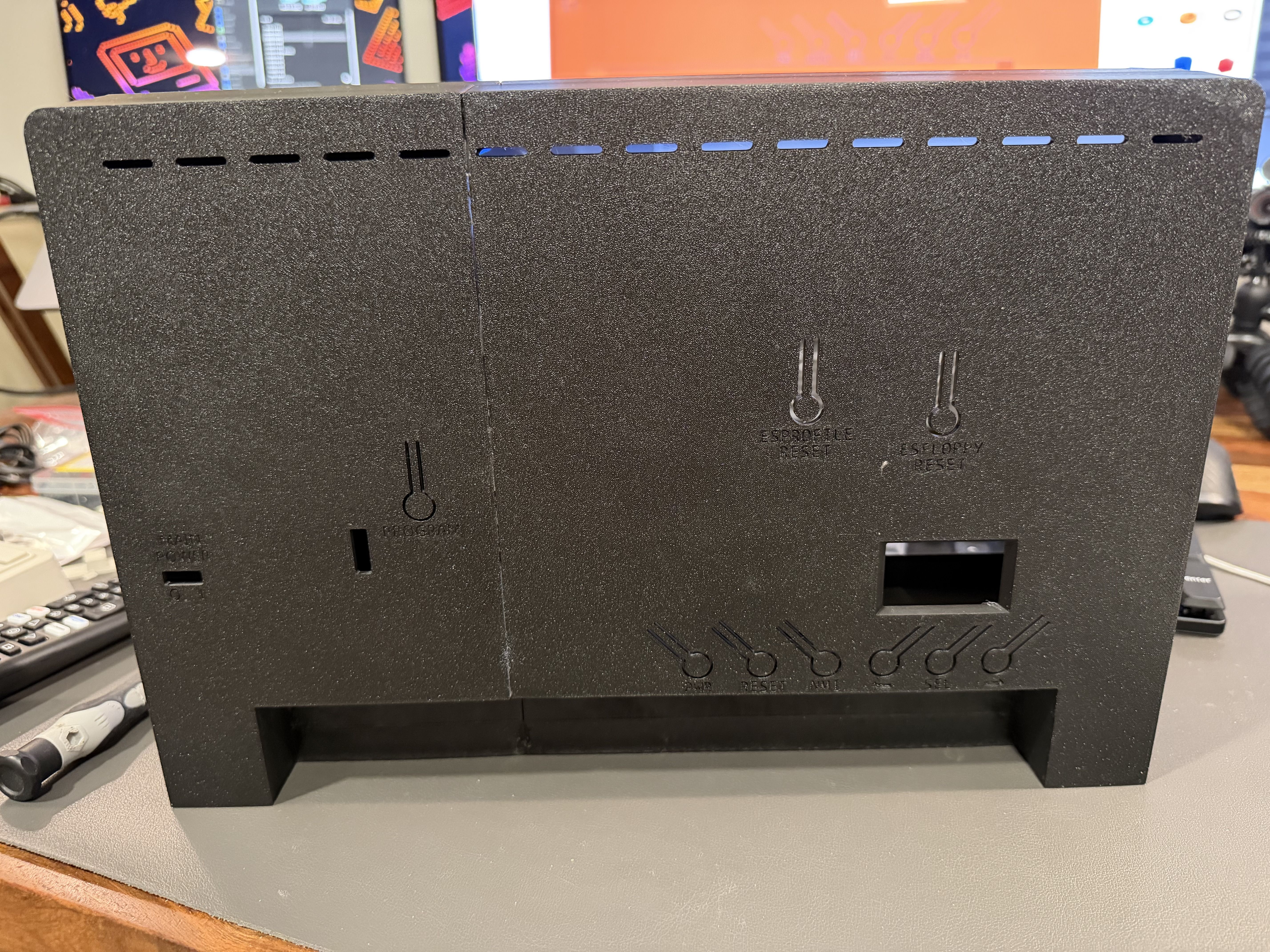

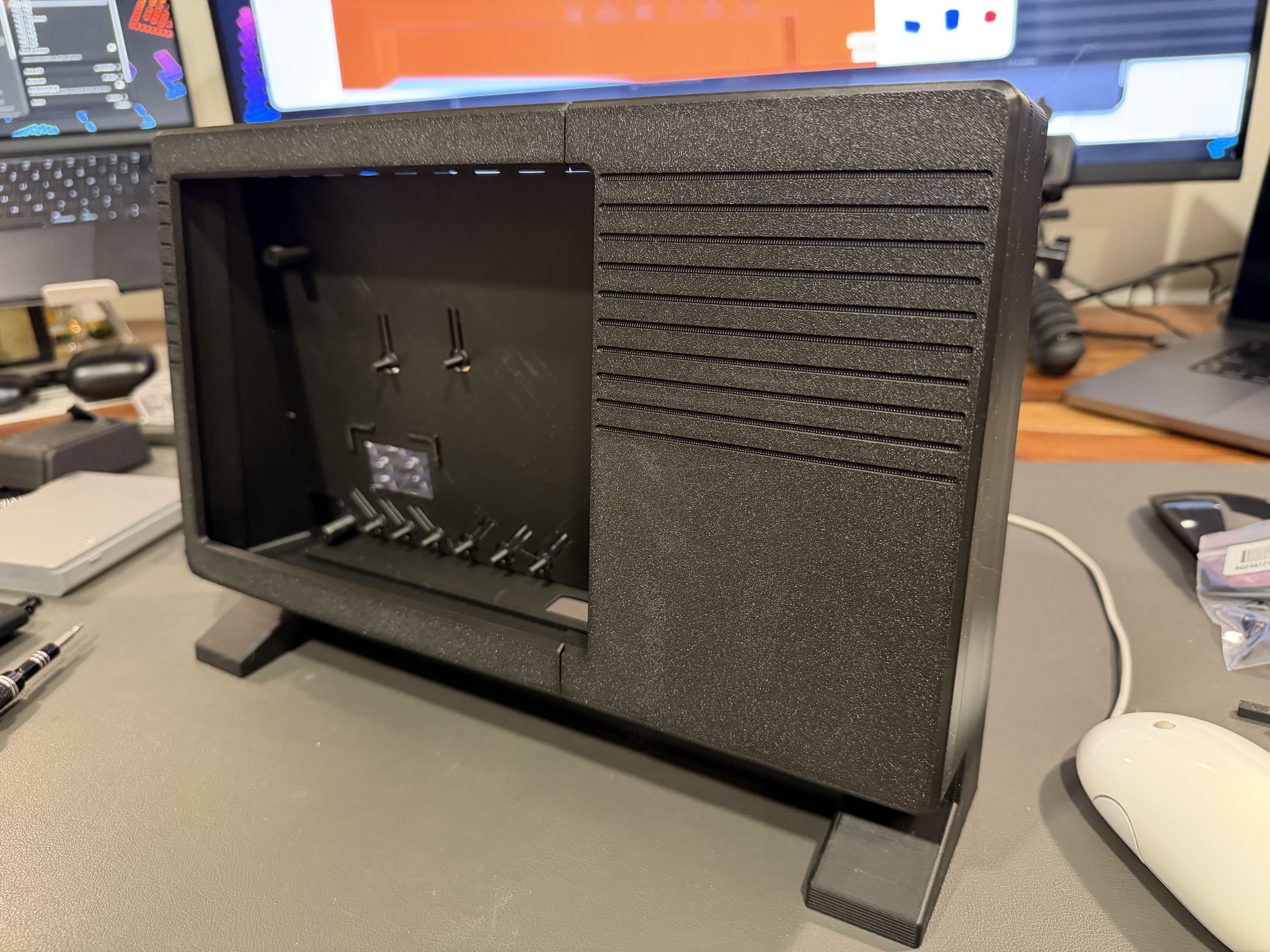

OK, I've been working on a 3d printed case for the LisaFPGA - something I could stuff an iPad or similarly sized LCD in and make an all in one, flat screen Lisa. The design is coming along, but the challenge I faced with my original plan of an iPad screen. The good: 4:3 ratio, readily available, fairly cheep. The bad: the 1024x768 resolution is not supported by the FPGA, and presents some scaling difficulties

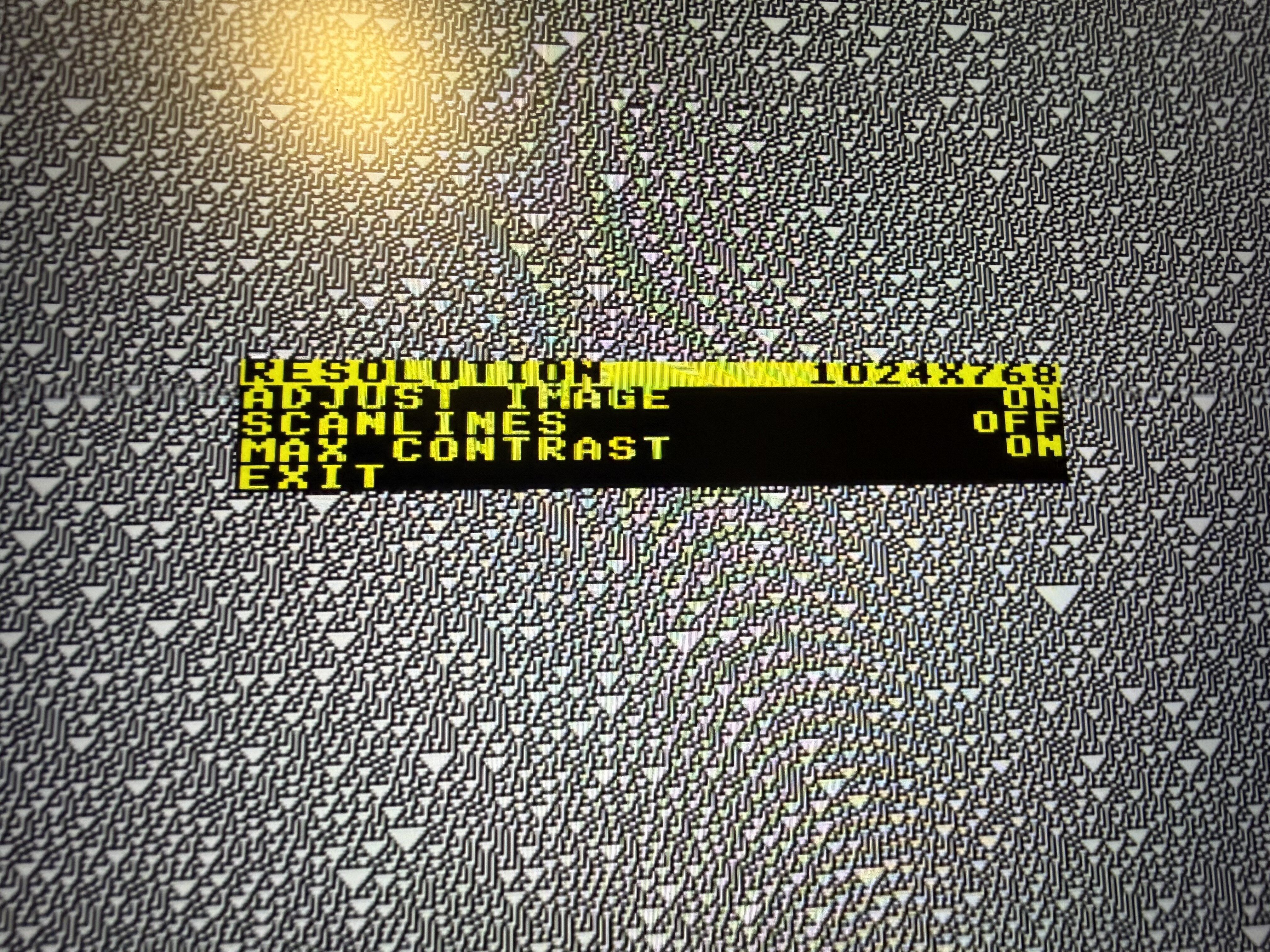

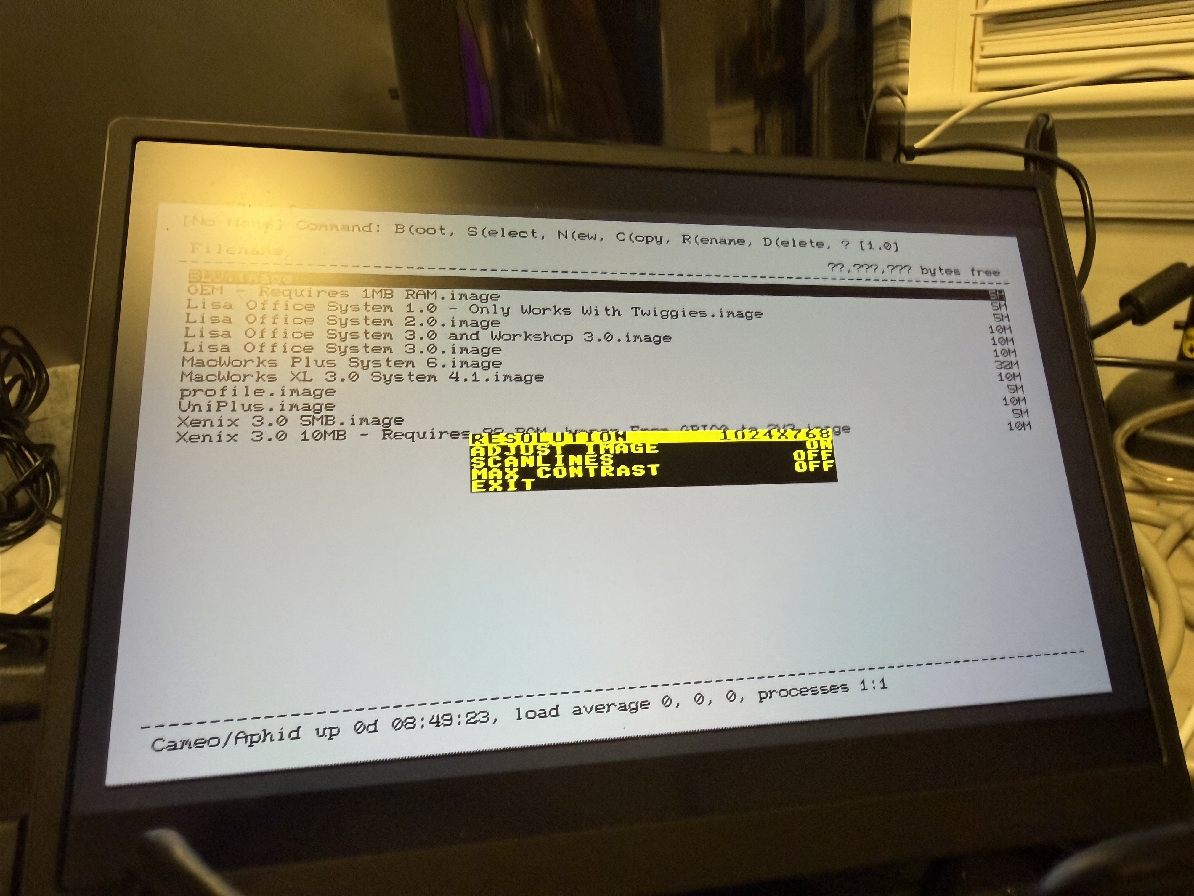

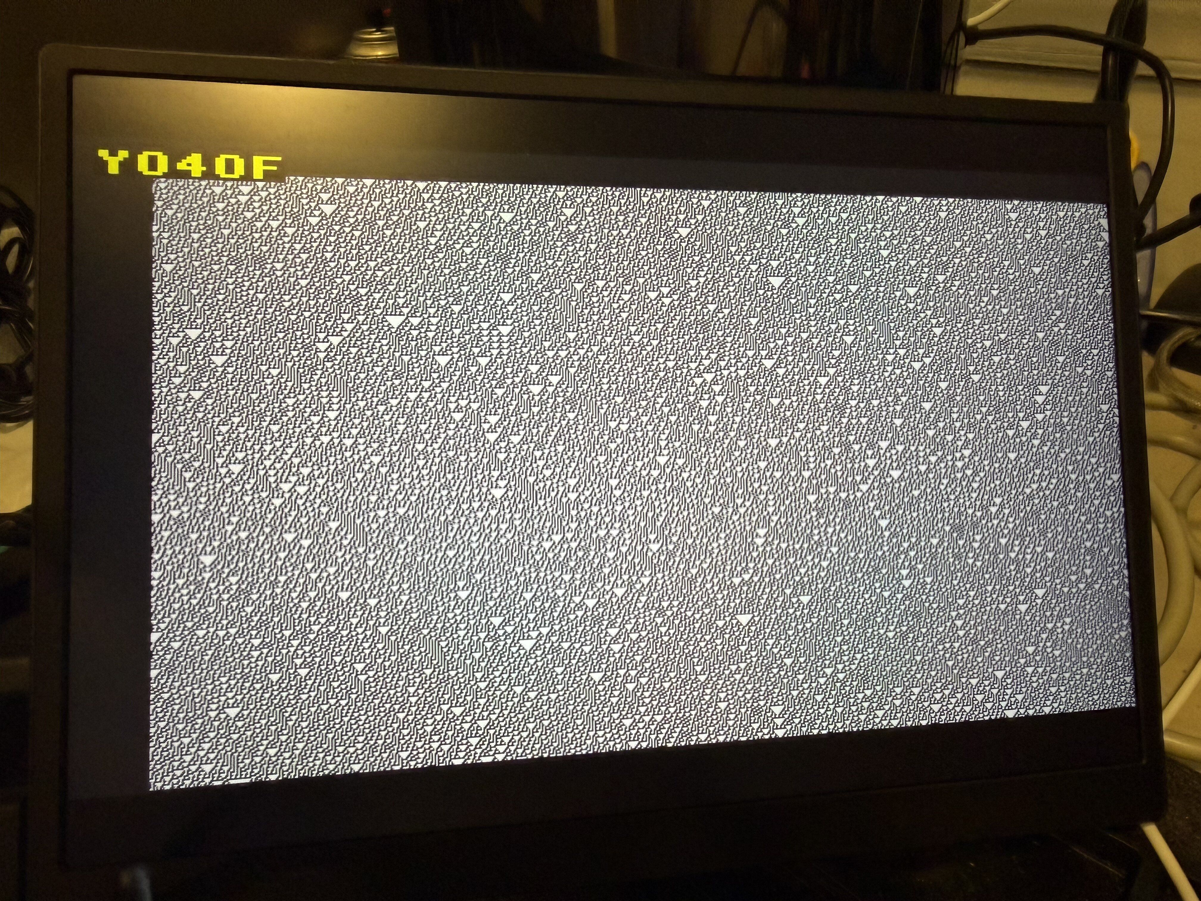

However, I wanted to see my options, so I took to the challenge of modifying the FPGA programming to swap the 1080p60Hz jumper setting to replace it with 1024x768 @65Hz to see if I could get it on the iPad screen. I was eventually able to make that work (with the help of a Bootcamp install of Vivado on my 2013 Mac Pro). However, my initial approach to scaling left the vertical lines differing in width, bars down the screen for the "gray pattern" background and overall just not a good looking output. I added dithering to the scaling and that produced and acceptable image, but it still is clearly not as nice as the 1080p scaled output.
So, I looked around a bit and found a 11.6" 1080p widescreen LCD that is roughly the height of the iPad and would still fit in my case design. For this, it would use the better scaling of @AlexTheCat123's 1080p output, which is great. The downside is the default 1080p output is centered and letterboxed in the screen. For my design, I would need it to be left aligned due to the placement of the cutout for the viewable portion of the LCD, wanting to match the aesthetics of the Lisa. So I modified the FPGA code to left along the image. The problem with this approach is that for the 1024x768 image (which has small dead areas above/below and to the sides of the image) and the 1080p image (which has dead areas beside the image), I may need to make adjustments to the location to center it in the screen opening. I could adjust it in the code and get it dialed in, but every time I make a change, it was ~1 hour to re-run the synthesis and implementation to be able to deploy to the device for testing. If I have to do that a bunch of times, it will be annoying. Also, if others try to replicate the process, and need to adjust, they'll need a PC the hassle of signing up for an AMD account figuring out how to compile, etc.
So, what if I could make my modifications accessible in a way that preserves AlexTheCat123's original out of the box functionality, but gave users a way to switch one of the video outputs to 1024x768 (or possibly other resolutions, although there are challenges with supporting multiple), or to adjust where the image was output within the leterboxing? I realized there's some buttons for the ESFloppy functionality that weren't currently being used, but I wondered if I could use those. Well, I stole the SEL button from that to serve dual purpose. A short press will control the ESFloppy (which currently doesn't work, but my code won't interfere with that), but if you do a long press, it will bring up an on-screen menu on the HDMI output with options to toggle the output resolution, adjust the picture location, toggle scan-lines, toggle contrast.
I'm hoping to clean up the code and submit a pull request to get this added. I think there could be other things added to this menu for adjusting functionality without having to access the physical switches.
I'm waiting on my 11.6" screen to arrive and do some testing with my case, but hoping to have a rough print assembled and tested sometime this week or next. If it all works well, I just need to find a 350x350mm print bed printer to use to print without slicing and gluing.
