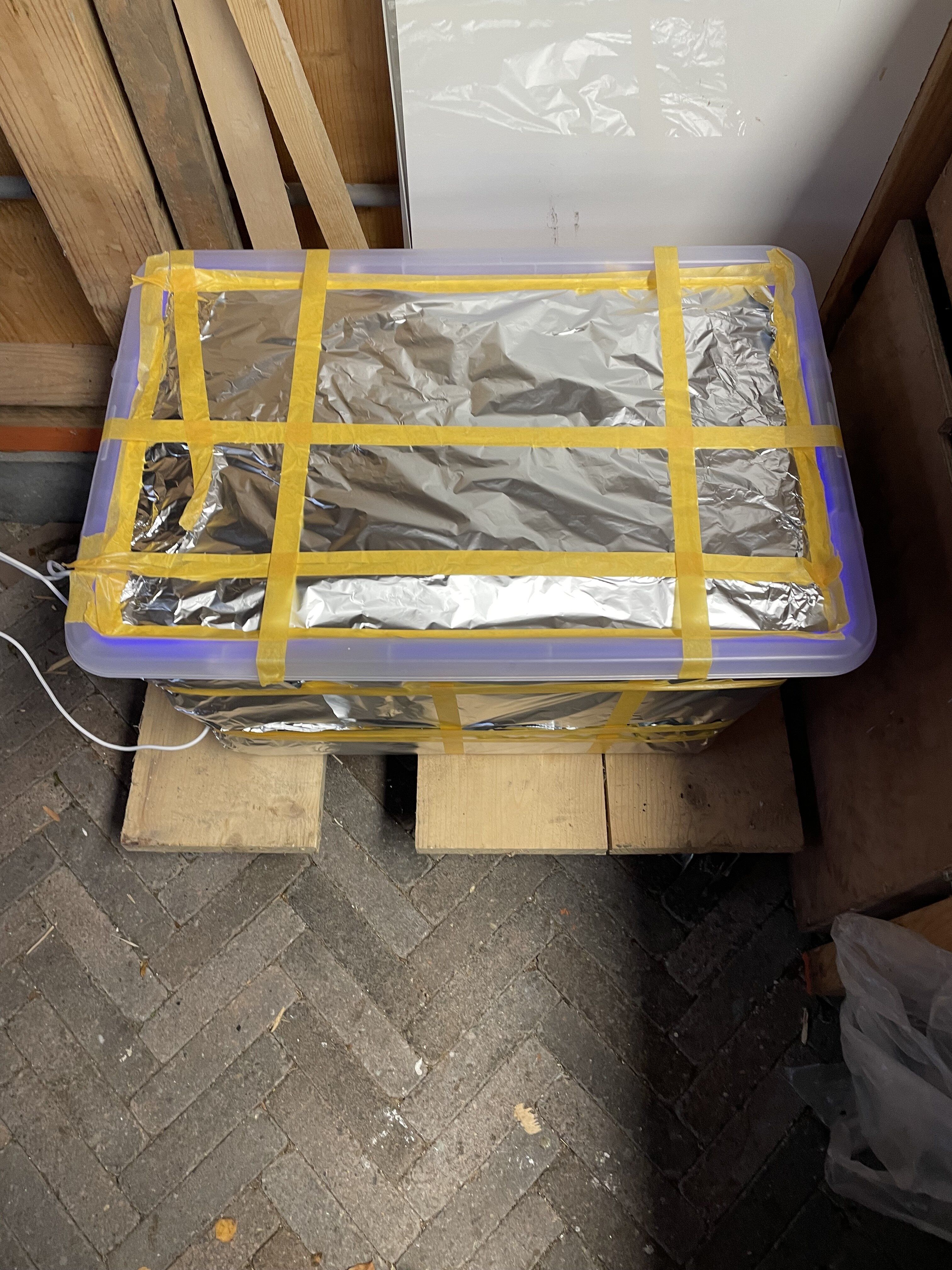

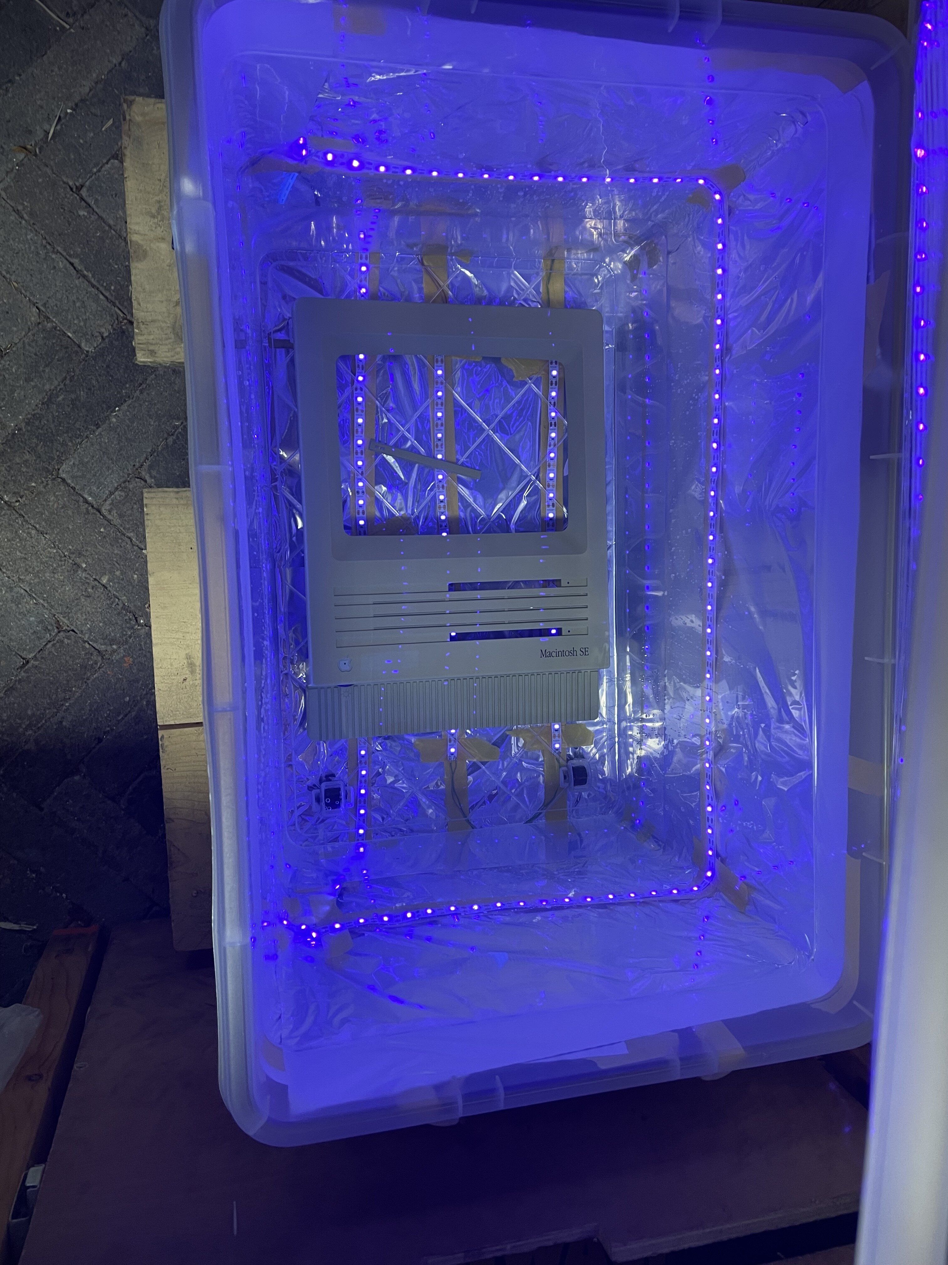

I prefer using a UV box because I've had inconsistent results from sunlight. The UV box resolves this. I made one with a large tote lined with reflective material. LED UV lights are wrapped around the inside sides and on the top. With this I do not cover the parts with plastic wrap, I just leave them in the box for 24 hours then check. I wash all of the cream off, check everything, and if necessary treat again exactly the same way.
