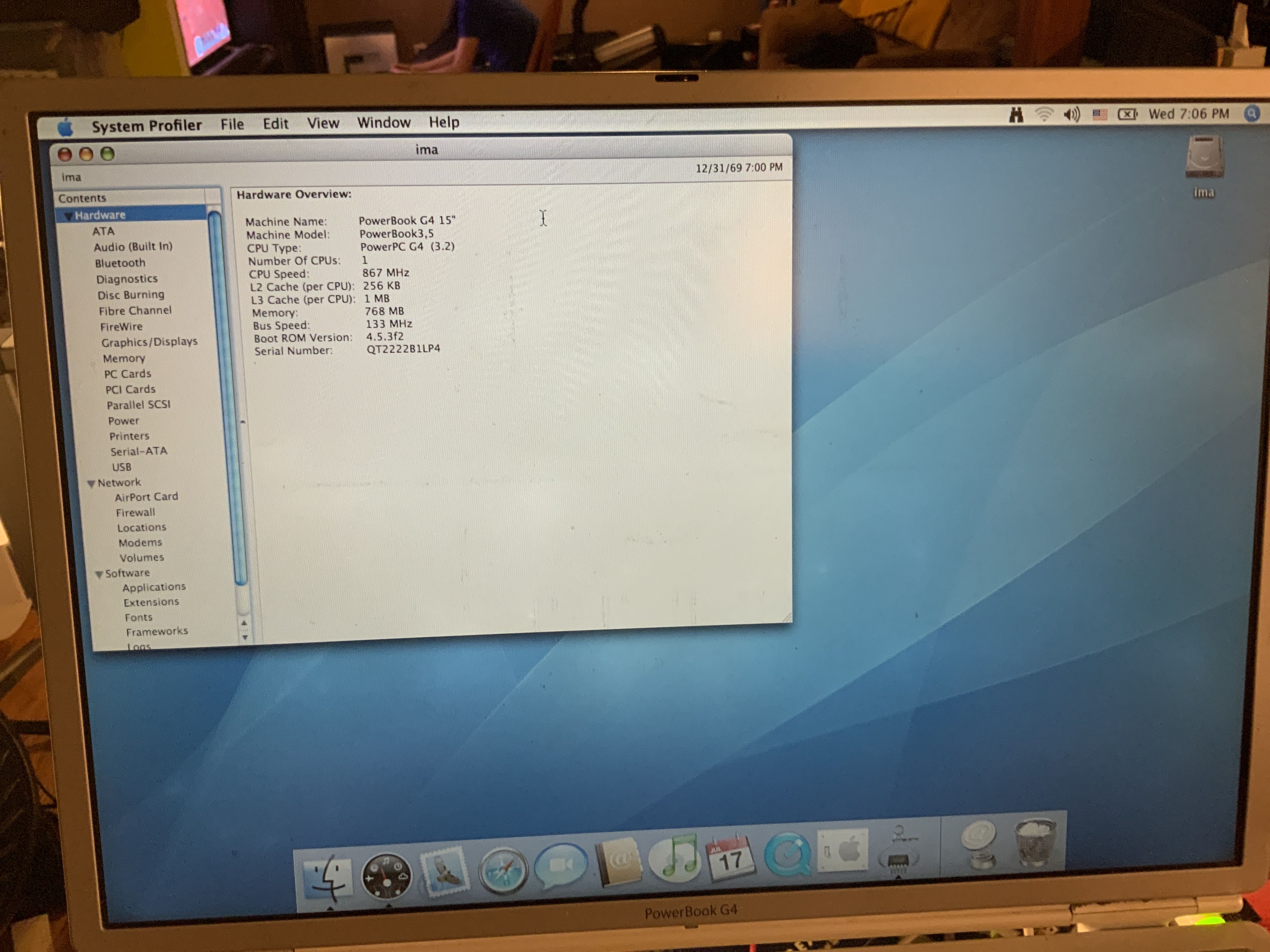

Ah — then it's probably not worth it. My TiBook is is pretty good shape, considering. Even the hinges are still tight. It booted up from the HD like it was 2002. I'll keep this stuff in mind if and when it ever goes out.
