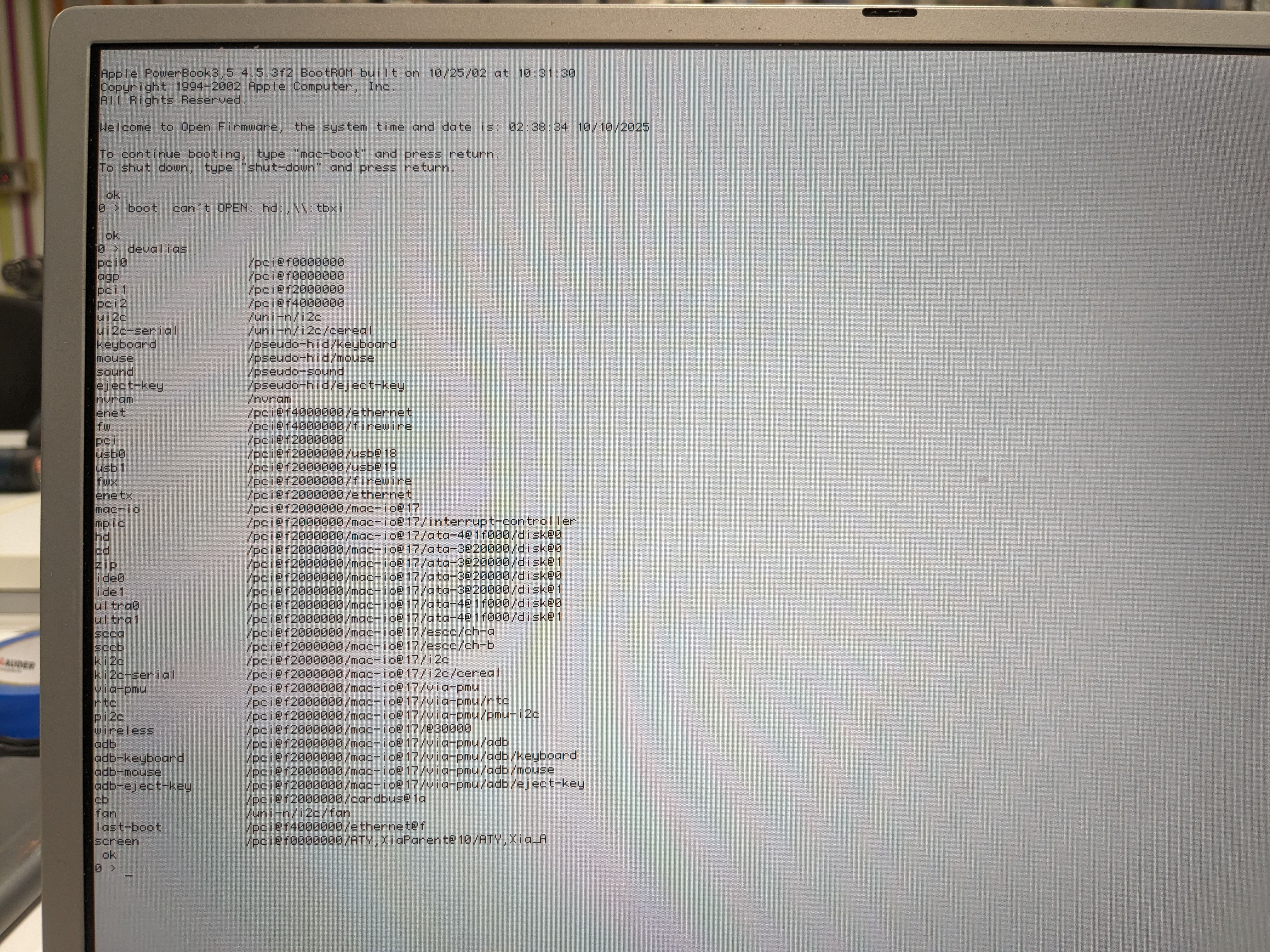

I also did some poking around in OpenFirmware, and when I look at the devices in dev / ls and I don't see any ATA devices in there. (note: I also do not see the optical drive, I'm not sure if it's supposed to show up without a cd/dvd inside).

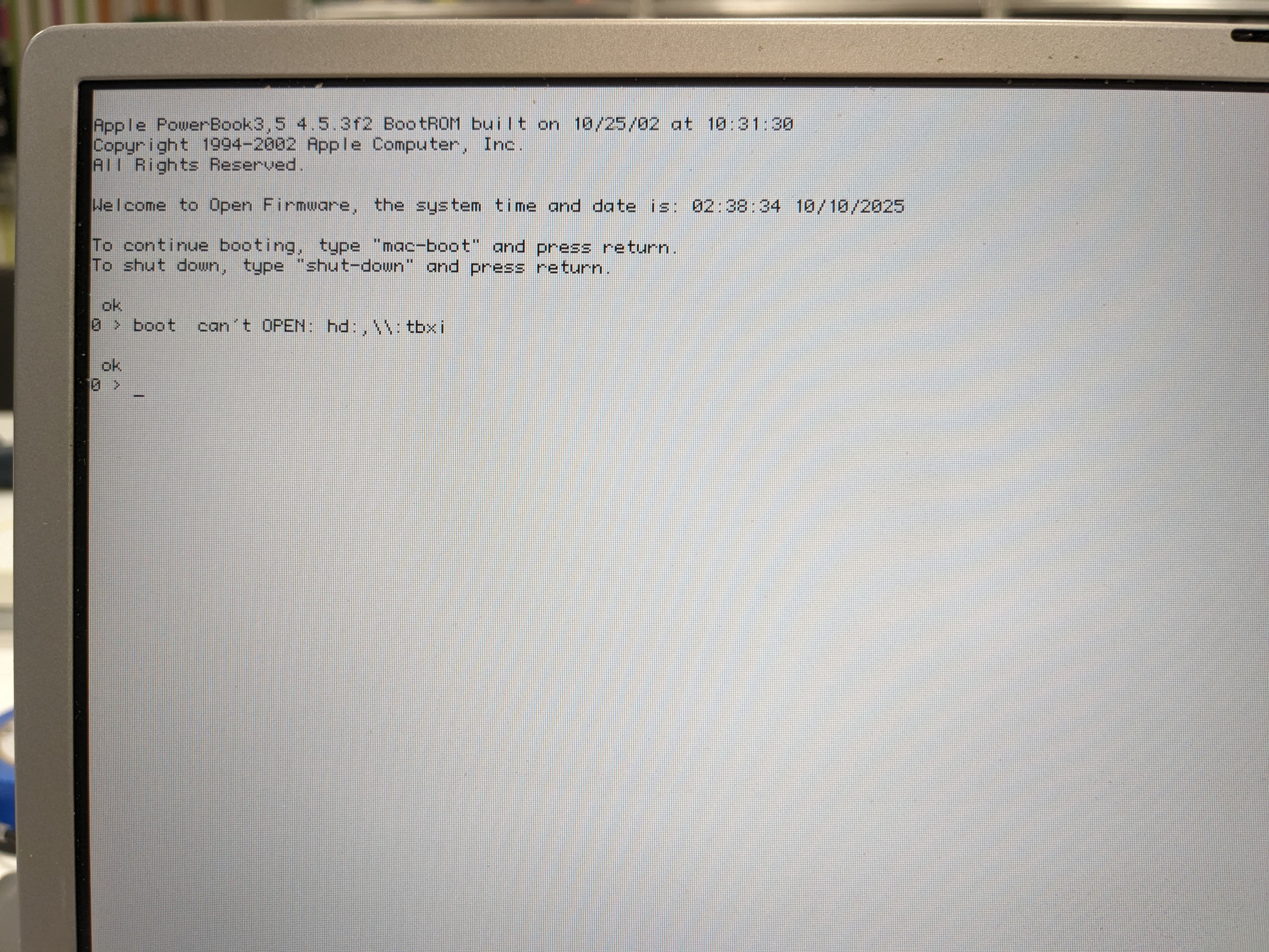

What do you see when you issue a "boot" command from OpenFirmware?
It doesn't show the disk on the ATA bus where it should be in dev / ls so I assume it'll just fail with an obvious "can't find it" error, but I haven't tried.
[a few minutes pass]
So I just tried it and it indeed fails:
I also took some pictures ofdevalias dev / ls.

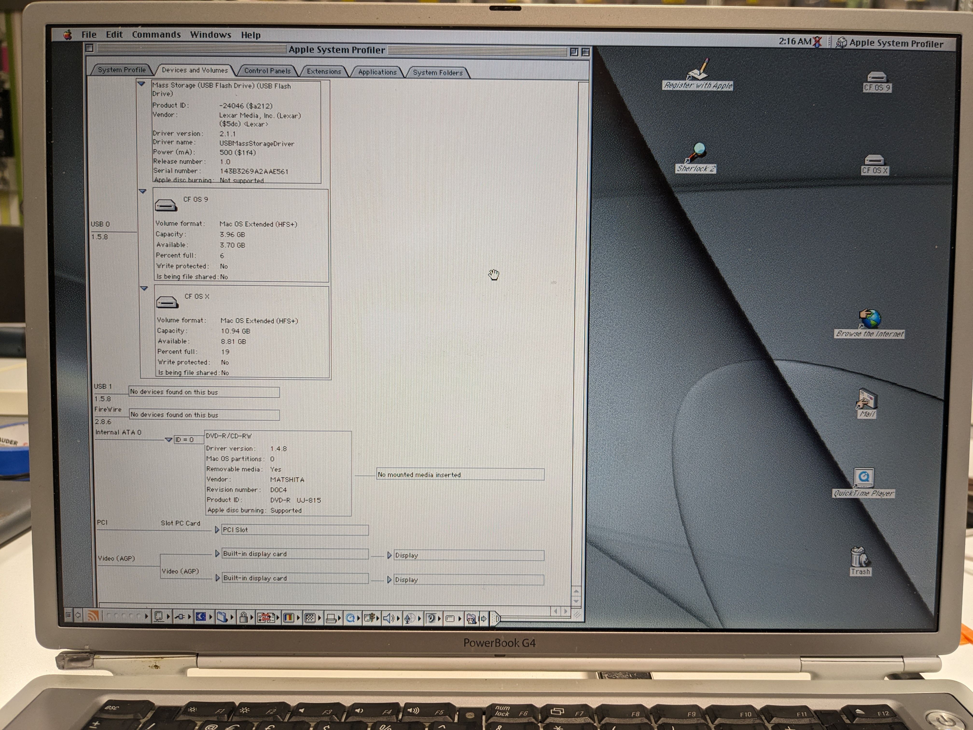

Meanwhile it has booted OS 9 from usb, and I have this screenshot from System Profiler.
(I also took a proper screenshot but I still have to figure out how to convert a 'Macintosh QuickDraw PICT' to something modern like a PNG, but... Mac OS 9.2.2 isn't that old, right?)

The optical drive is broken so it's suspect by default, and it worked once after unplugging it, so I tried that a dozen more times since. But nope, it hasn't worked again. The optical drive does enumerate fine in OS 9's system profiler (as seen above), it just spits out any disk I put in after a few seconds.
