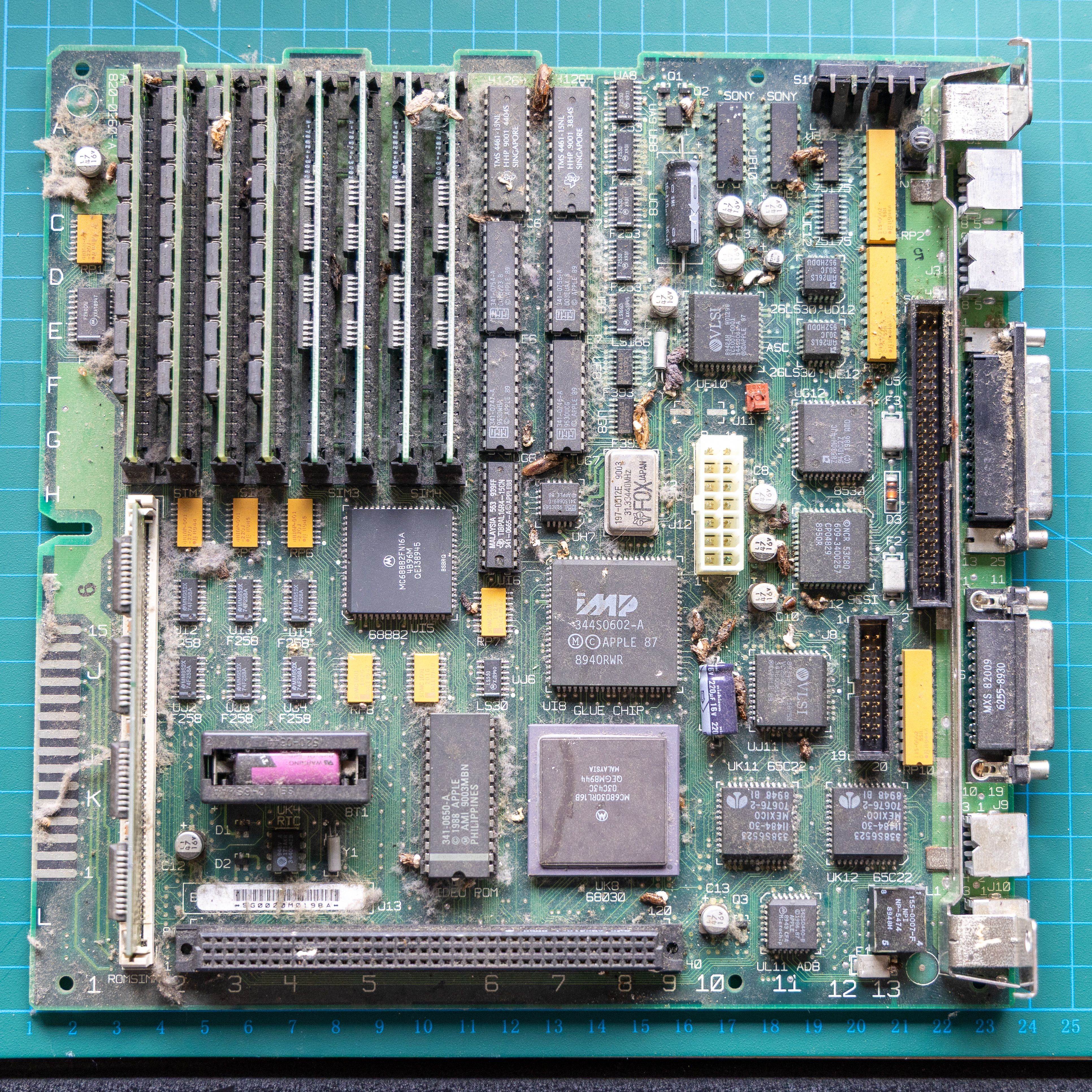

I finally cracked open my SE/30 and found that it is filthy inside, with rat droppings everywhere

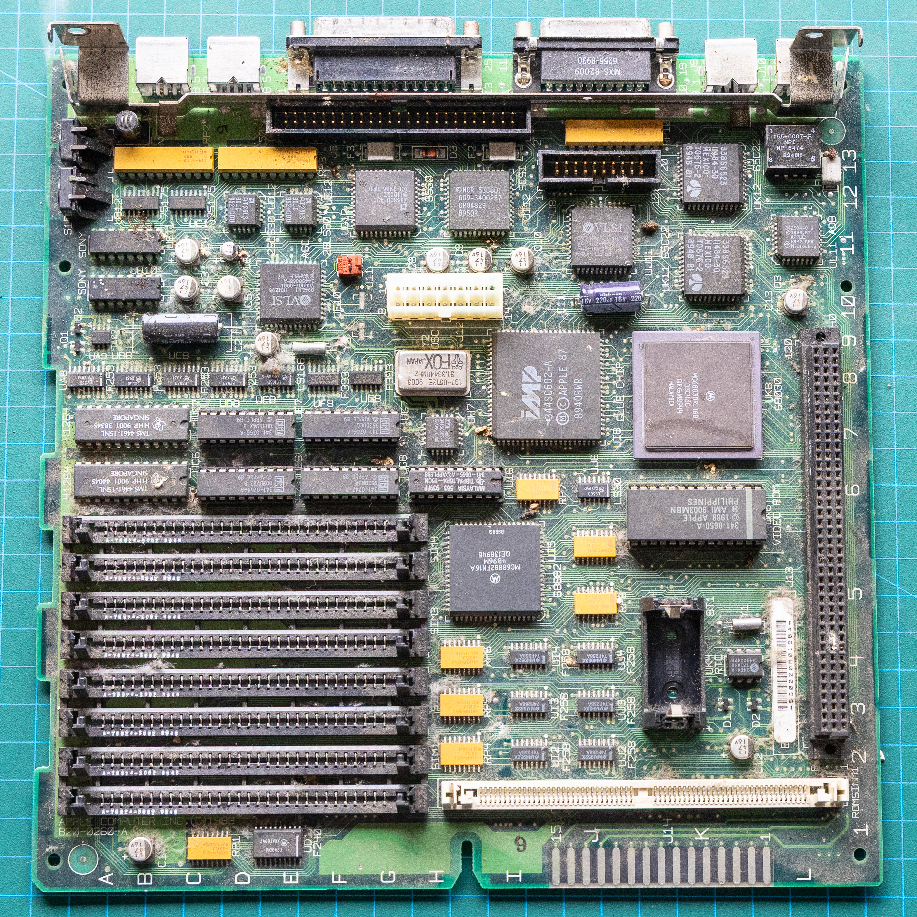

The good news is that the 1989 battery hasn't leaked! But a few capacitors have begun to leak, but not too severely. Hopefully I got to it in time. Here's what the board looks like after a very basic clean and removing the RAM & ROM:

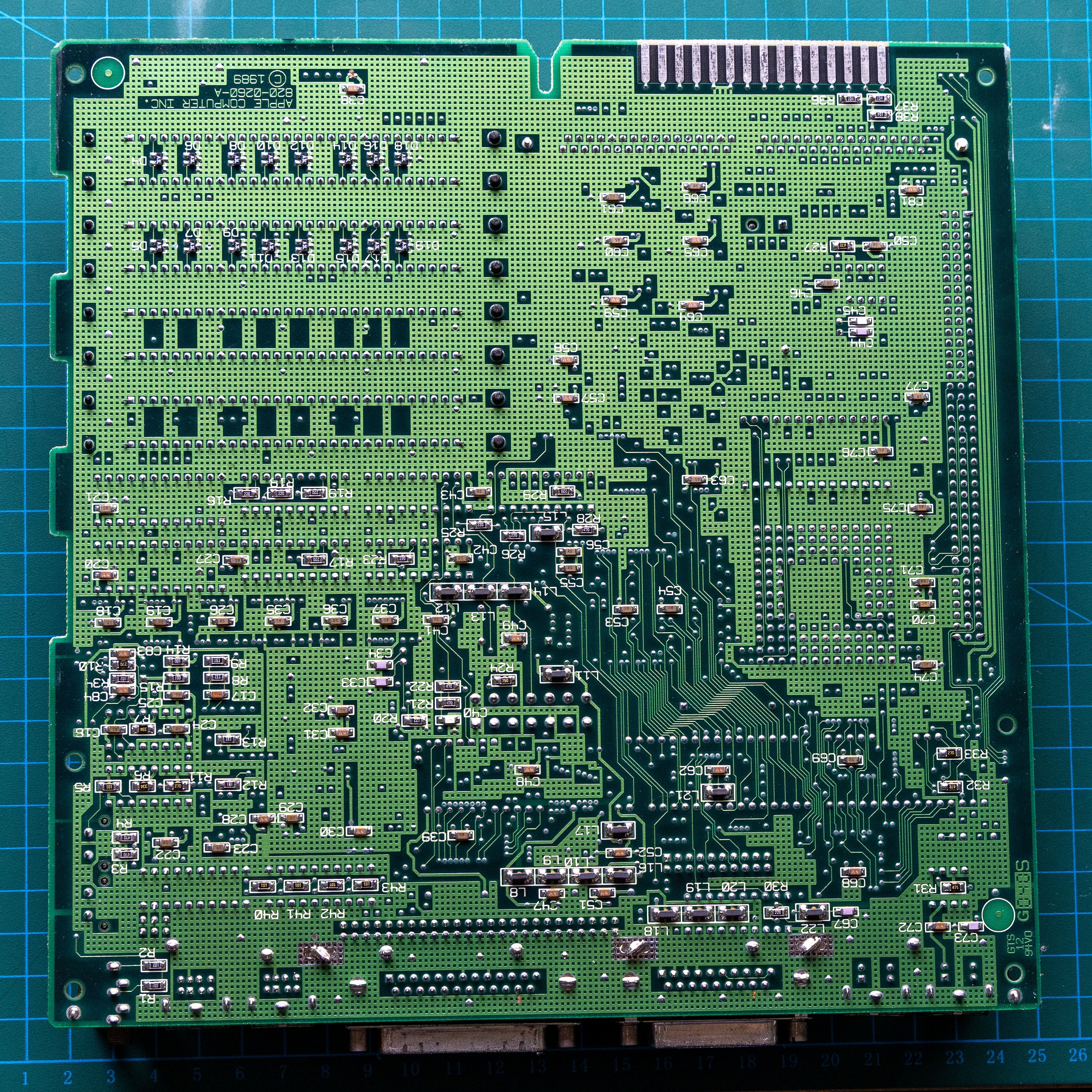

Underneath looks good.
