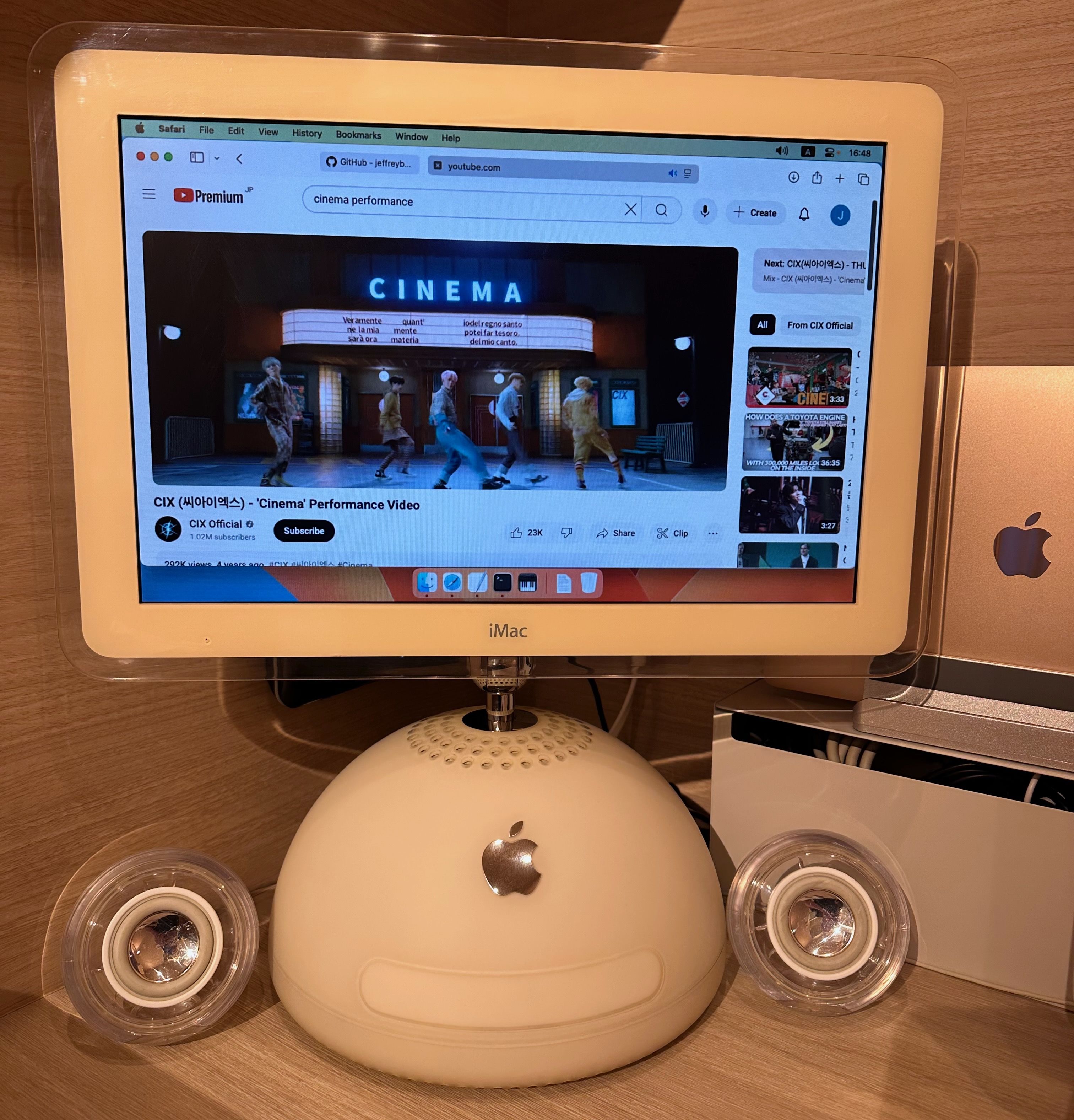

When I was in High School, I always wanted an iMac G4 but I could never get one. Well recently, I changed that and went down the retro Mac road. I got myself a 1GHz 17" model and I absolutely love it. I put in an SSD and got the RAM up to 1.5GB (annoyingly one of the OWC RAM sticks as bad otherwise it would be 2GB, but I digress). But I live in Tokyo and my Apartment is tiny, so I can't just buy pretty things to have them take up space. I decided if I was going to buy it, I was going to put it to good use... as my accessory monitor so I can watch KPOP while I work
. But I know these old Macs cannot play H.264 barely at all and they almost can't use the internet because of TLS. So I started doing some experiments to work around this.
I think I came up with something pretty cool and so I made a full tutorial on how to set it up. It does require a second computer to do the streaming work, but what I can say is, I think the video quality is pretty epic. No, it's not a beautiful 4K stream on an OLED panel. But it's a full 720p stream at 20FPS with almost no compression artifacts. Its also completely tunable if you have an older or newer PowerPC Mac you can adjust it appropriately.
To see the quality you can get out of this old G4, take a look at this video I recorded from my phone. I have noticed that the streaming quality from Google
Drive directly is not always great, so please download it to be sure you are seeing the full 1080p quality.
Anyway, if you are interested in trying something like this please take a look at the tutorial:
