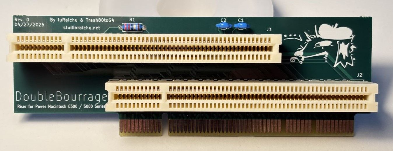

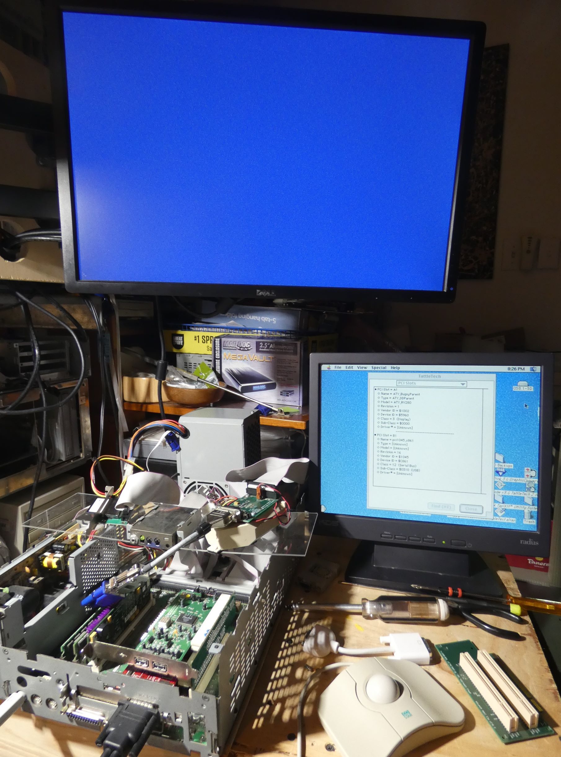

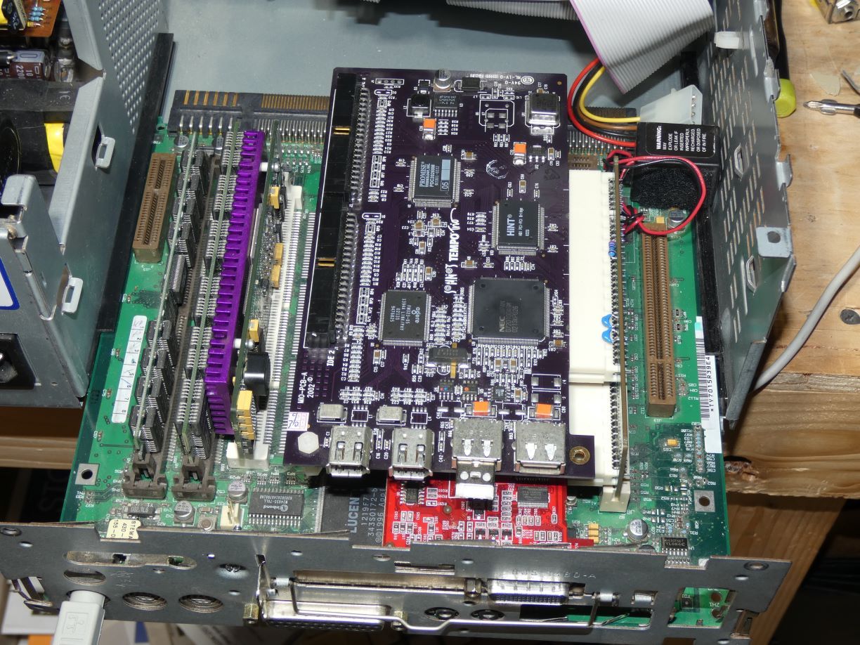

@luRaichu jumped into the project with both feet. He did the board layout, ordered the PCBs, the components, assembled the first one and it's in my grubby little paws for testing! All goes well so far outside of playing whack-a-mole with the gremlins actively undermining my attempts to get a stable testbed up and running.
TwinSlot moniker taken by IIsi card so we're calling this one DoubleBourrage, Double-Stuffer en Francais.

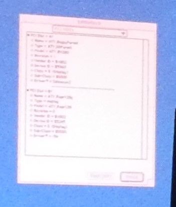

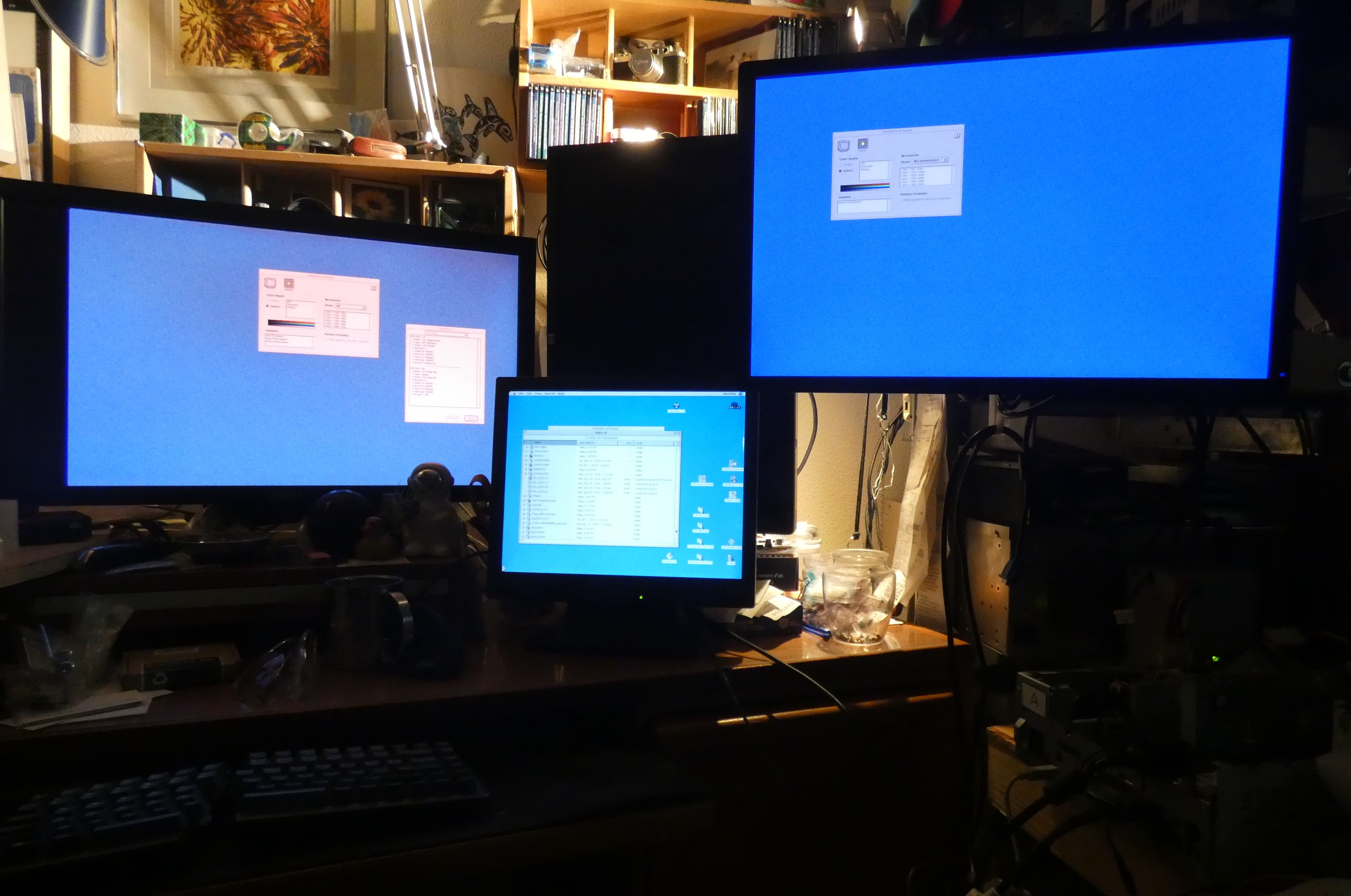

Craziness aside, got the first full test together and it passed with flying colors. Random USB card shows up in TattleTech's PCI Cards report, that's about all I was shooting for at the time. Nice big 1920x1200 main screen. I'd love to see that on a primary workstation with the secondary panel of the TAM active on a KVM setup. But alas, no TAM and no access to its PCI Riser for measurement and adaptation of the board design. Little help there? :unsure:
Need to get OS9.2 set up on another Compact Flash Card before I try to get much further along. Once the Crescendo/L2 is up and running I have all manner of I/O cards destined for the top, set back Slot_B.

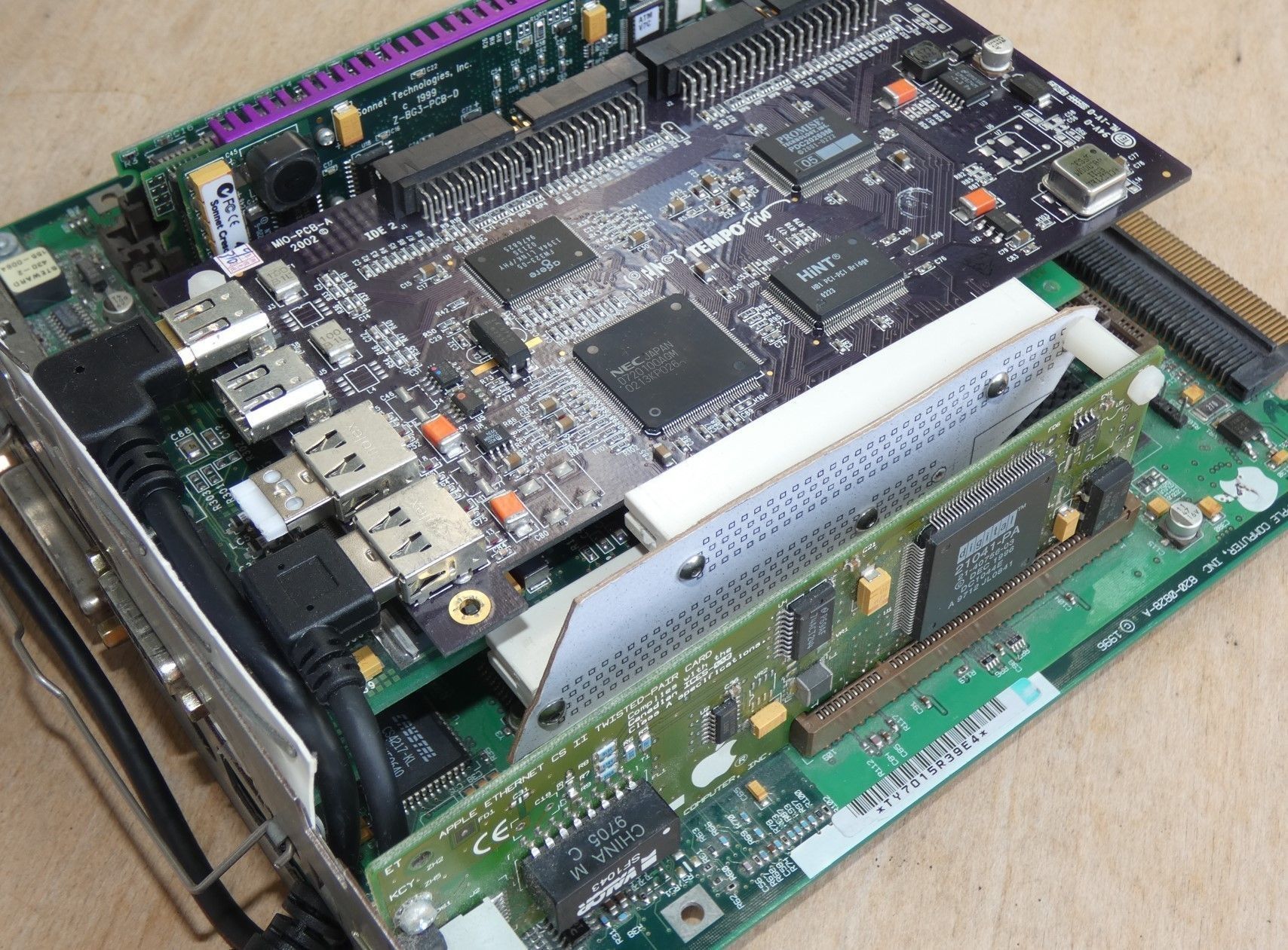

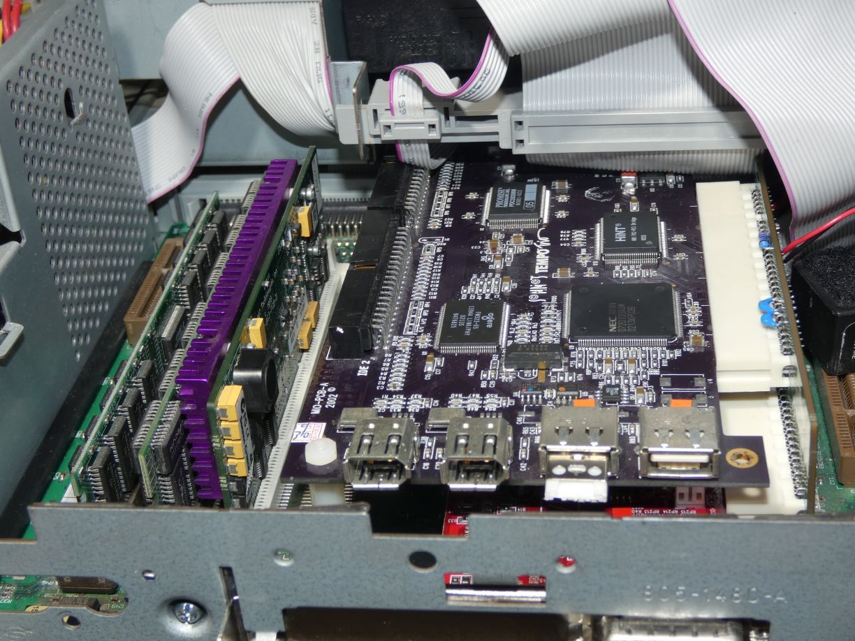

Worse case scenario will be one of my trio of Sonnet TEMPOtrio cards, each with two channels of ATA-133, USB and Firewire. They're about the largest cards I can imagine fitting in the top slot. Tested for fit as it's been the aim all along to use one. It PASSED!. Supposedly works in Alchemy architecture, but they dropped support for Gazelle. But PCI Bridge hacks over at the MLA may prove differently?
It fits! But of course I dropped the friggin' CD and killed it. Need to find another one for the OS9 Lives installer.
The trio is a full on seven inch PCI Card and I snaked it in there sweet as can be. If there are any problems with the MedusaMess and SCSI Optical I can just run an ATAPI Optical off the trio with a DOM on the other ATA133 Channel.

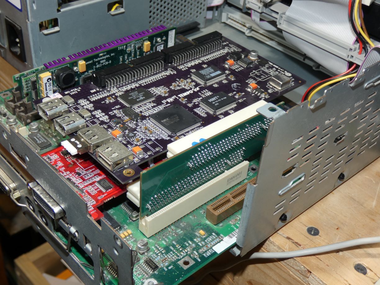

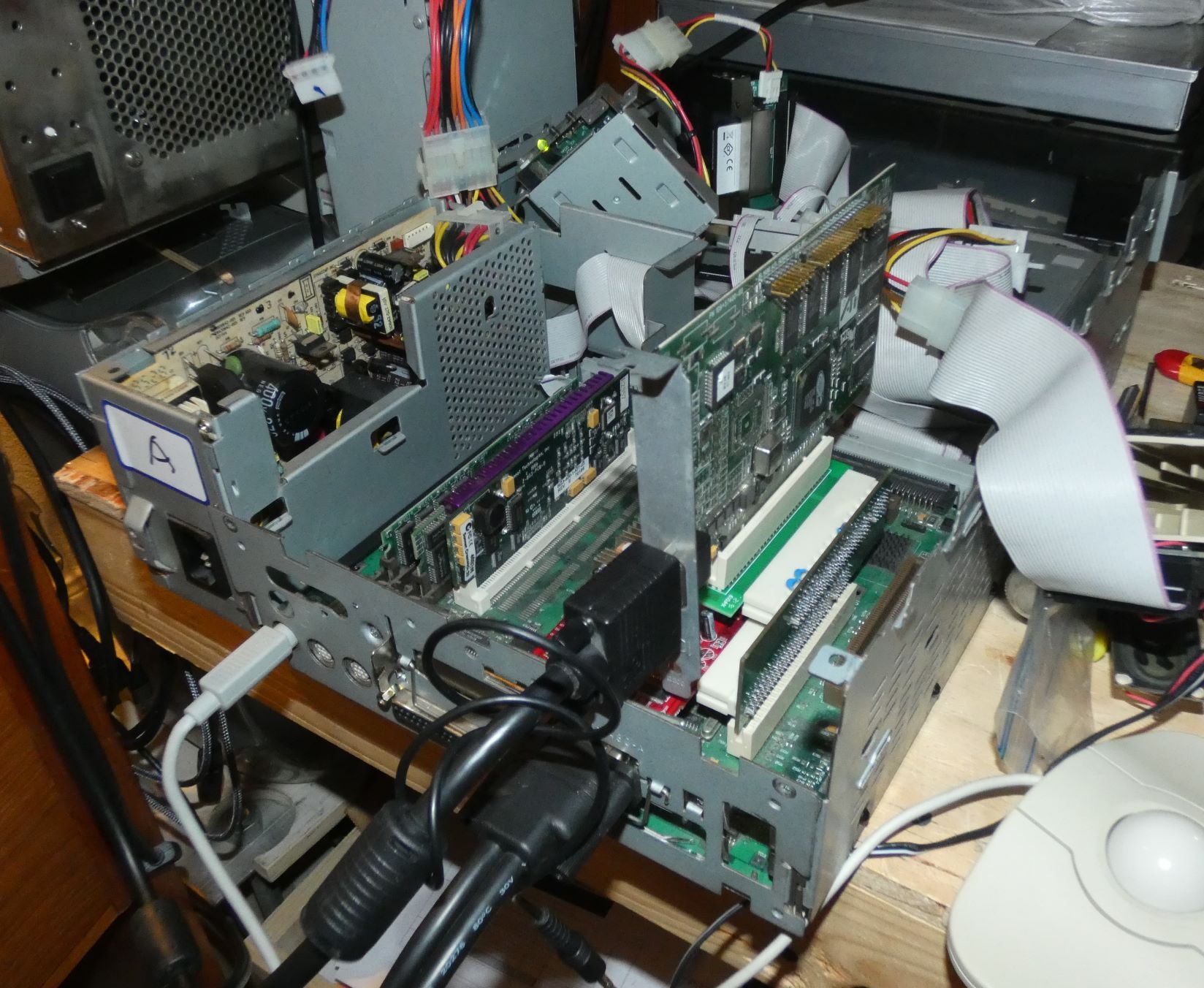

Set up my series of cardboard prototypes to just barely squeeze the trio in far enough for short, RA USB & FW extension cables to be snaked out the vestigial PDS Slot opening.

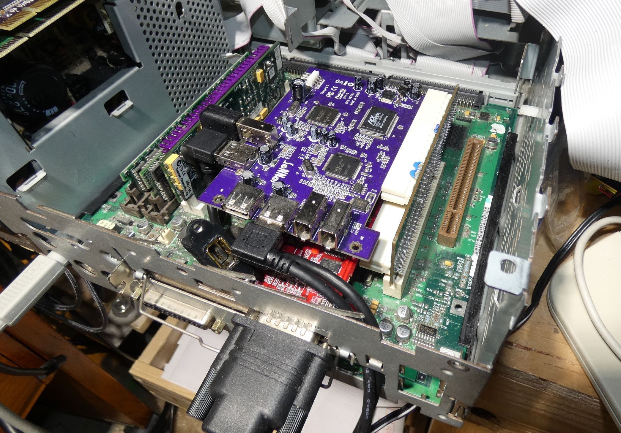

I set Slot_B back another tenth inch to make just a tad more room for the RA cable breakout and it still fits under the CD mess! I have quite a few other I/O cards to test. So it's gonna be a slog before official rollout. It's been a very long time coming, but product release is nigh! :D

Small screen's the 6360's built-in graphics set at 640x480 so TT Reports show up nice and big.
Graphics Card in standard slot A1 is driving the big panel at 1920x1200.

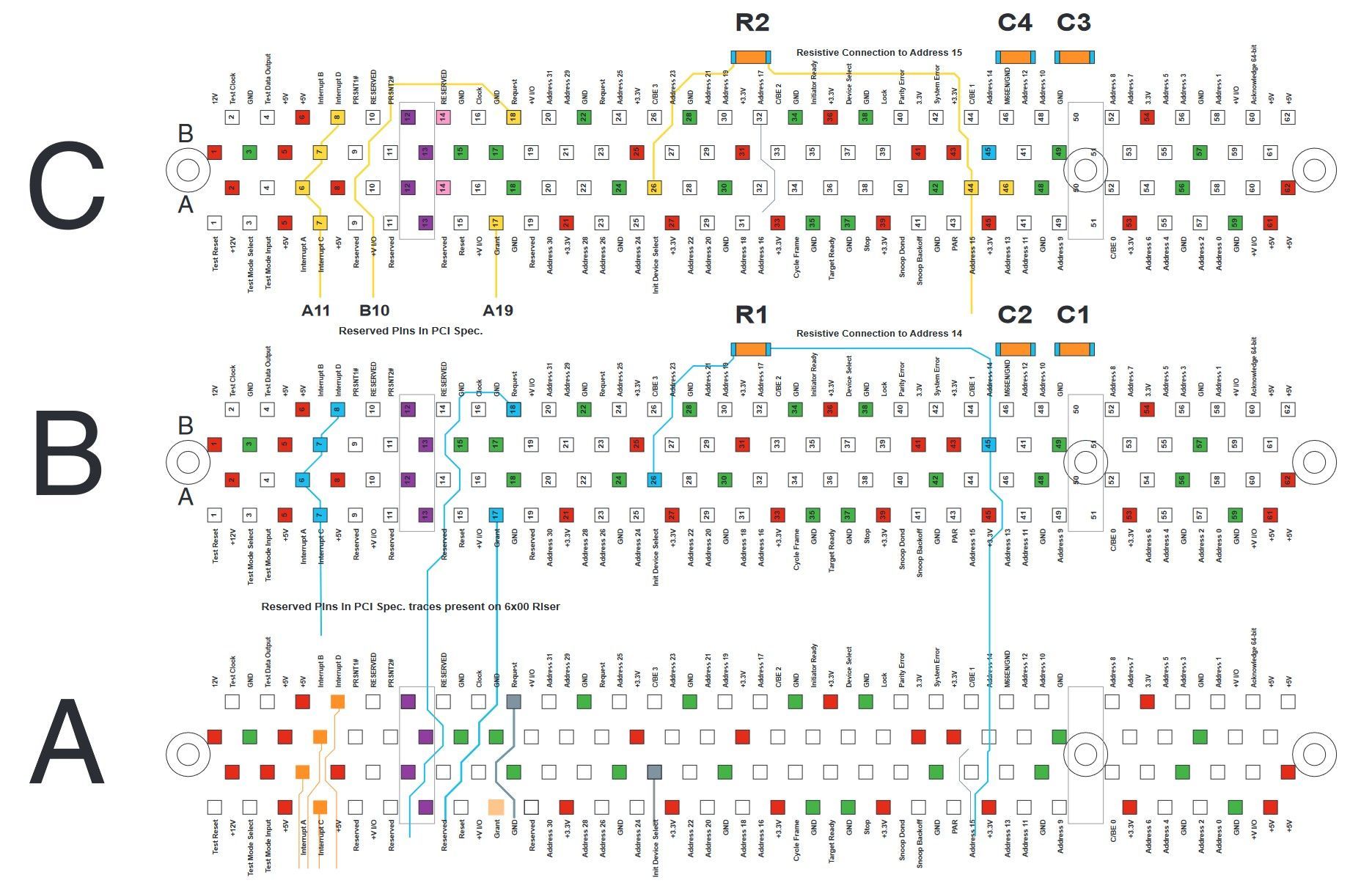

Thanks, very cool info about available slots, especially Slot_F1 for ATI in Gazelle. I was under the impression that archicture wouldn't support the Mythical Slot C so it's good to see it does! Next it's on to spelunking for Slot_F1 it seems. Not really expecting to find it supported in the connections on the Riser Slot, but if you can identify the Address line for resistive connection we'd be halfway there.
I'm not expecting any problems at all as it's an exact reproduction of the 6x00 riser. It's scrunched way down to fit in the PCI Drawer Macs with Slot_B1 set back for jumper cable extension to the outside world.
Hoping to create a QuadSlot Riser for the Testbed MiniTower some day. As tested, Slot_E1 connections are jumpered from a dummy CSII card to make room for a Gigabit NIC. ;)
Not sure what this means.
Since slot F1 has device number @12 (hex), I would expect that address line 18 (decimal) is used for the IDSEL signal for that PCI device. That's what the Power Mac 6500 schematics show (sheet 16 for the ATI-264GT device, area A6 in that diagram).
Slot C1 has device number @F so it must use address line 15 for IDSEL.
The PCI Slot in the 6500 gets 3 interrupt signals but I only see two grant/request pairs so the third slot can't be a bus master?
1,315
434

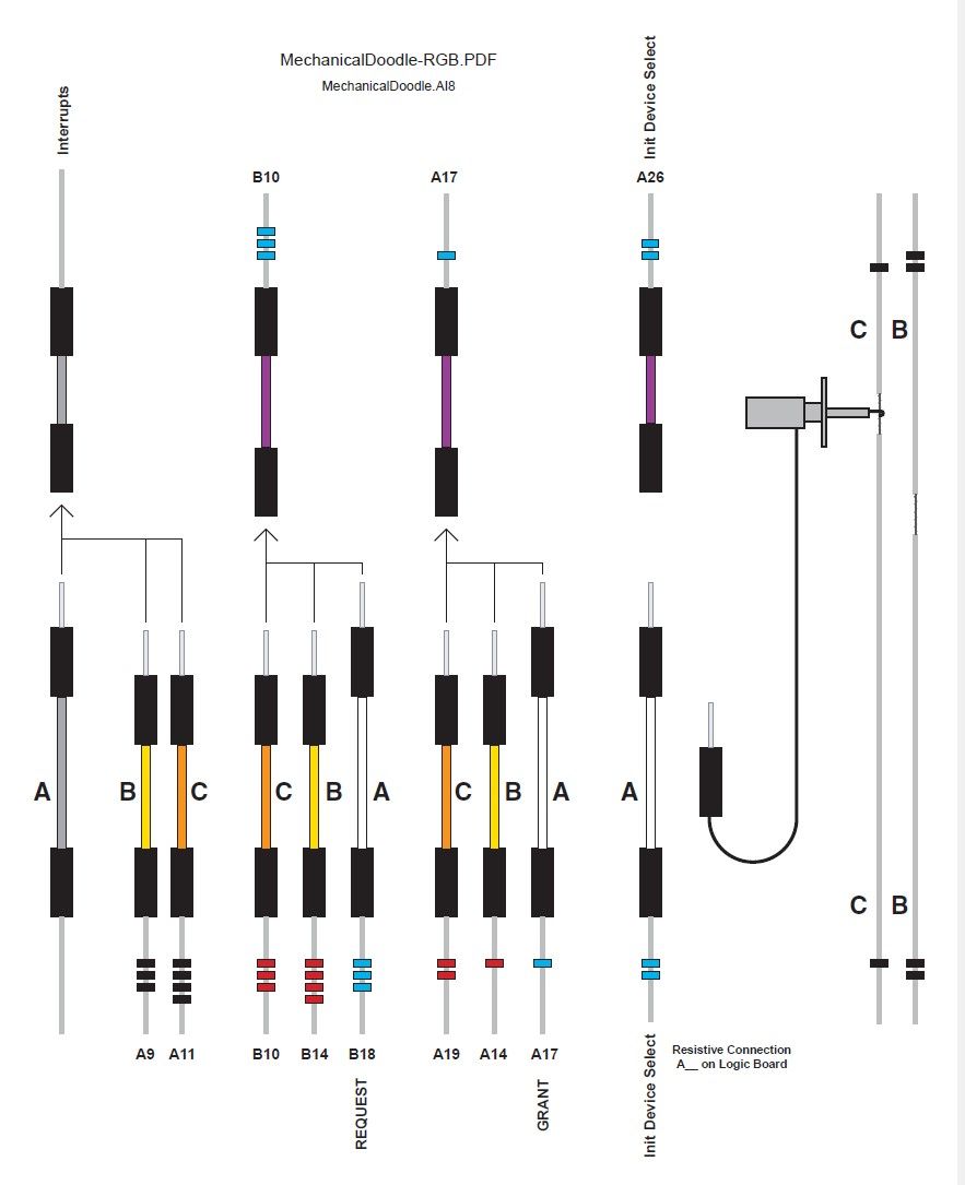

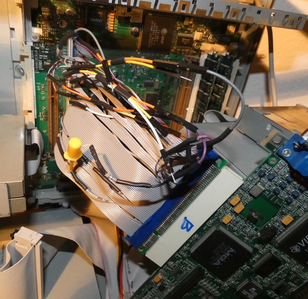

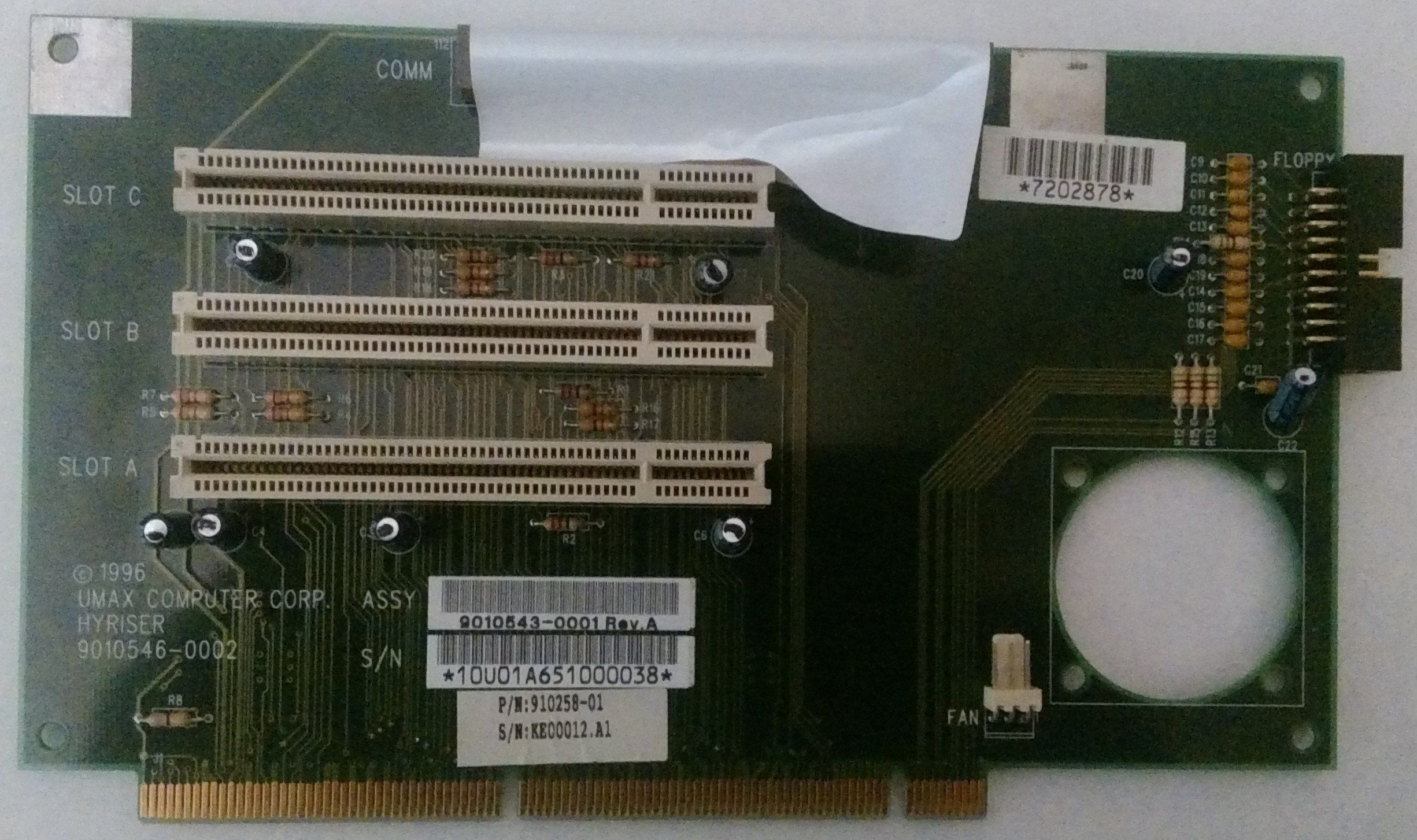

Dunno, all you do is well above my pay grade. I just reverse engineered the 6x00 riser and applied what I'd learned to set up the "Mythical Slot_C" @trag had as the third PCI Slot on one of his clone risers along with a CSII Slot that was taped over.
Apple tied all four interrupts together and came up with their own way of doing PCI, using pins unassigned in the spec . . . Apple! :rolleyes:
Everything is in this AI8 doodle, save for the two capacitor connections we discovered when I took a hacksaw to the connector on a 6x00 riser. Intended to buzz it out . . . but Neolithic Hacker Mode kicked in . . .
I do electron plumbing, in what I use for a brain it's all pipes. valves, connector fittings of every kind, gate valves, backflow prevention and whatnot. Kinda works for me. Grew up looking at the LSI and VSLI textbooks as artwork when dad was a boffin at IBM's Glendale Labs and had that stuff laying around.
This is my test rig, it stopped working reliably, but I can bring it back to life if you can identify what might go where to activate Slot_F1 and I can test for it in jumper wire playtime.
I ignored the capacitor connections and everything checked out in a basic fashion using TattleTech's PCI Slot Report. I'd imagine they're there for a very good reason when it comes to full card function. No Clue there, but I can update the artwork.
edit: first thing to do is check to see if there are any "unassigned" pins remaining on the riser connector.
