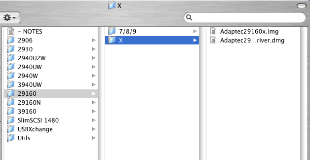

NewUser94
Aug 19, 2025
This may help, @Ron's Computer Videos did a great video and journey of archiving a lot of Adaptec drivers, including the 29160, you can check it out here: https://macintoshgarden.org/apps/adaptec-powerdomain-scsi-card-firmware
It looks like it may have something similar to what you need.
Note: TheUnarchiver didn't like to unpack the .sit file on my particular system, but it unpacked fine on my G4 Mac with StuffIt Expander 8.x.
Thank you so much for responding!! This looks promising. I'll try it now.
