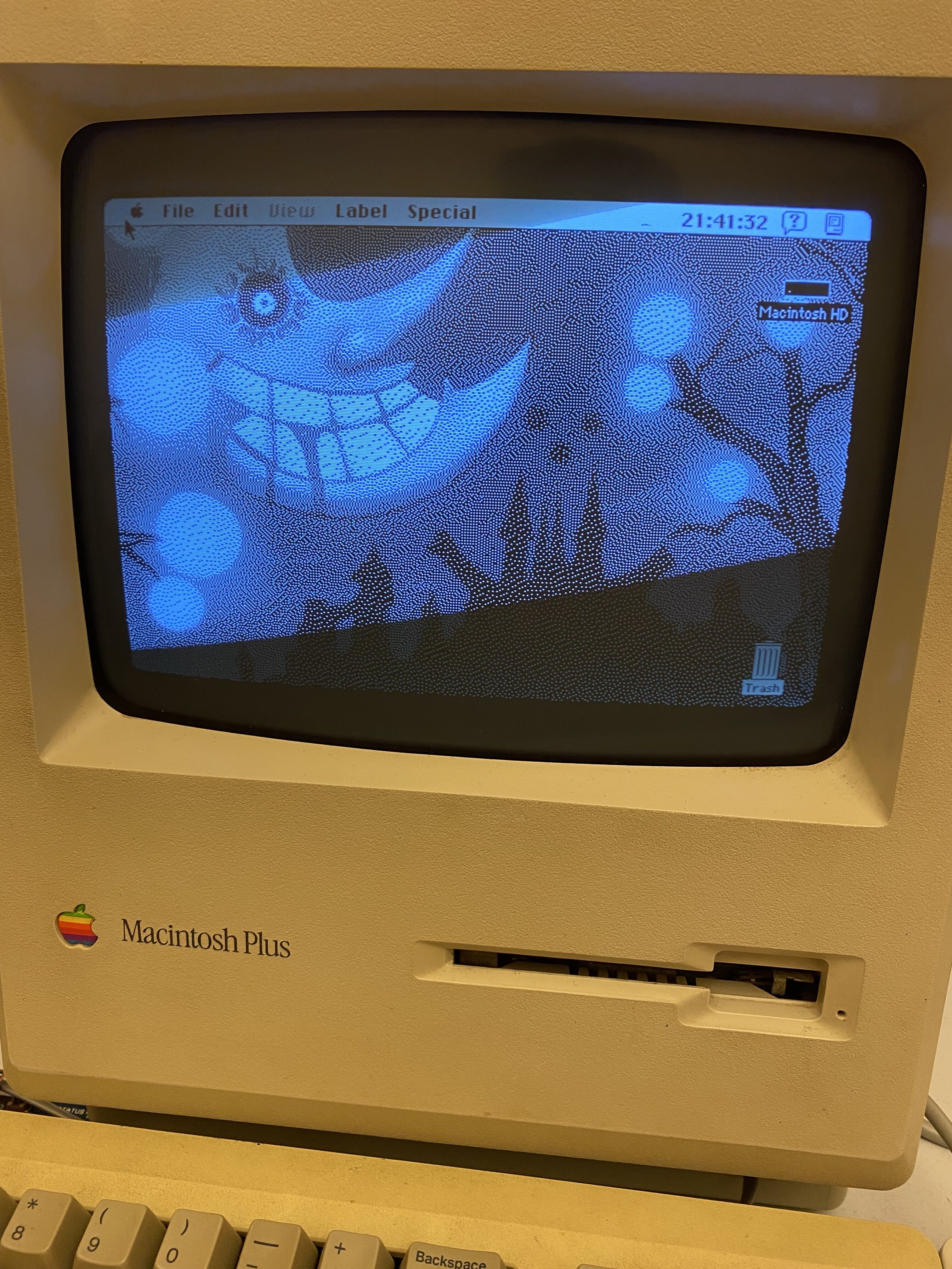

I'm trying to get a disk image created in vMac up on a Plus through the SCSI2SD. I've already followed codesrc's HFS from scratch guide (https://www.codesrc.com/mediawiki/index.php?title=HFSFromScratch) and have used that to prepare the image, but the Plus just goes into a reboot loop or shows corruption on the screen. I used DriveSetup1.7.3_DriverPartition.img instead of lido.img as I've heard the lido drivers don't play well with the Plus. Does Drive Setup 1.7.3's also not work? What's the recommended driver. The Plus does work and I can fully boot into the system using a Floppy Emu with the straight-from-vMac image.
For the SCSI2SD configuration, I've enabled responding to short selection pulses, set SCSI selection delay to 0, and set enable unit attention to off.
I've also verified that the image I've created boots in Basilisk II.
I'm guessing this is a driver issue, is there an image of an older driver partition which is compatible? I also tried Drive Setup 1.5's but had the same issue. I'm guessing Drive Setup's is far too new.
