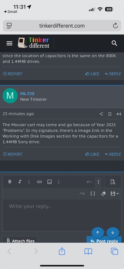

Interestingly, I am not able to see your signature when viewing this page in Safari on my iPhone 15 Pro Max, as you can see from this iPhone screenshot...
But I am now using Safari on my 5K iMac, running macOS Monterey, and I can see your signature now. I consider that to be a forum software problem that needs to be resolved. Tagging: @fogWraith
For now, here is the URL you are referring to:
