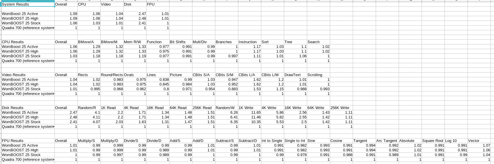

Slightly unimpressive results from my LC 475 running at 25 MHz :

Folks, feedback from someone with a 40MHz 650 is that the extension actually slightly slows down CPU execution, so I suspect the apple RAM timings specifically are already quite tight. It did slightly speed up video though.
At some point I'll drag my 650 out and set it up, until then this is really just a very underwhelming proof of concept.
As above, it does create a small speed bump on a 475, but nothing compared to actually increasing your bus / CPU clock.

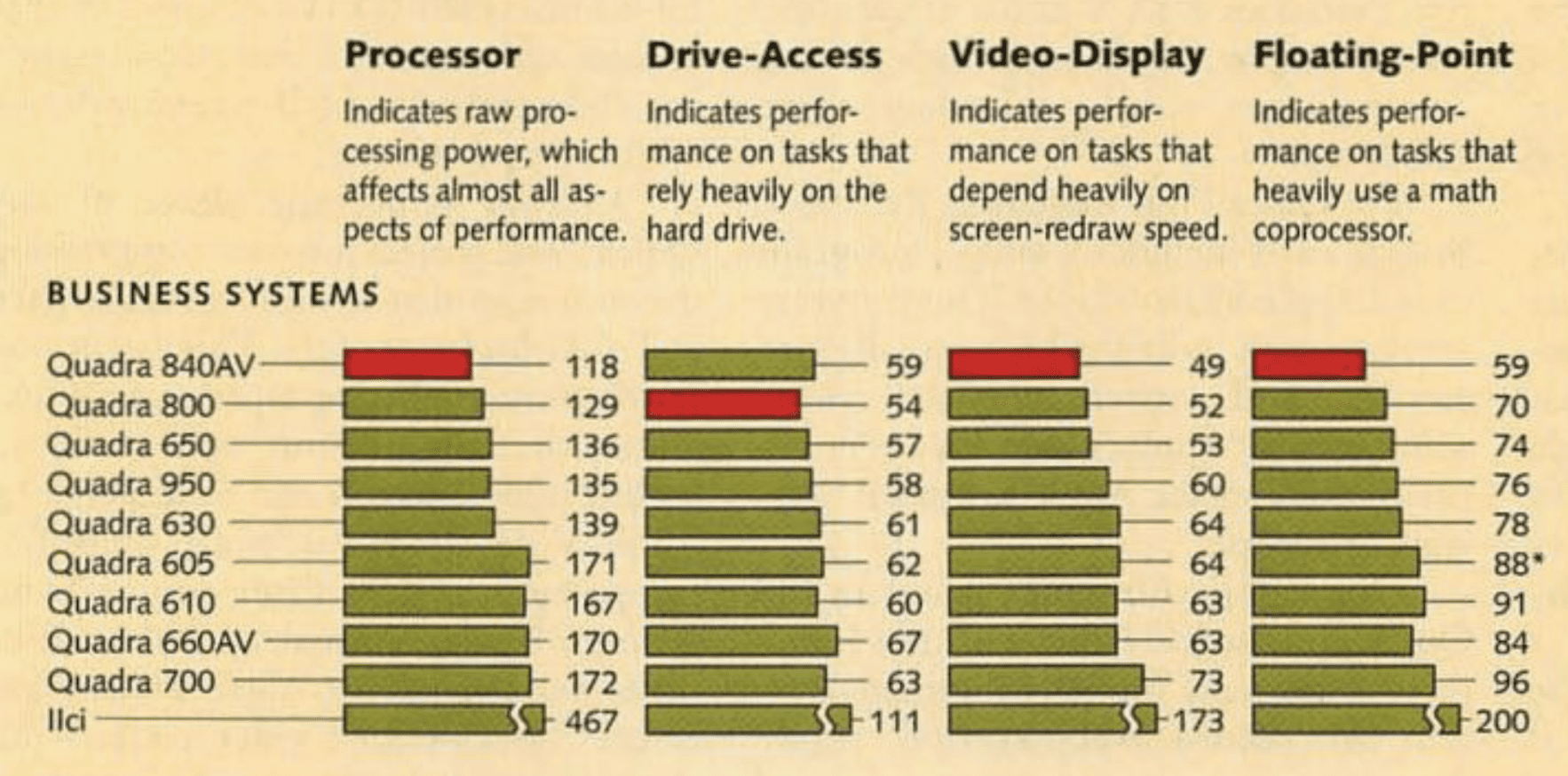

Neat! I love the icon. For a big Wombat does this effectively boost the timings to match the 800 and mythical 40MHz configs in ROM, or are these custom?
MacWorld pegged the 800 at about 5% faster than a 650 (see below), so that seems pretty close to your results. (I know you know, but as a reminder for everyone else -- 800 was tuned for 60ns memory, 650 for 70ns).
