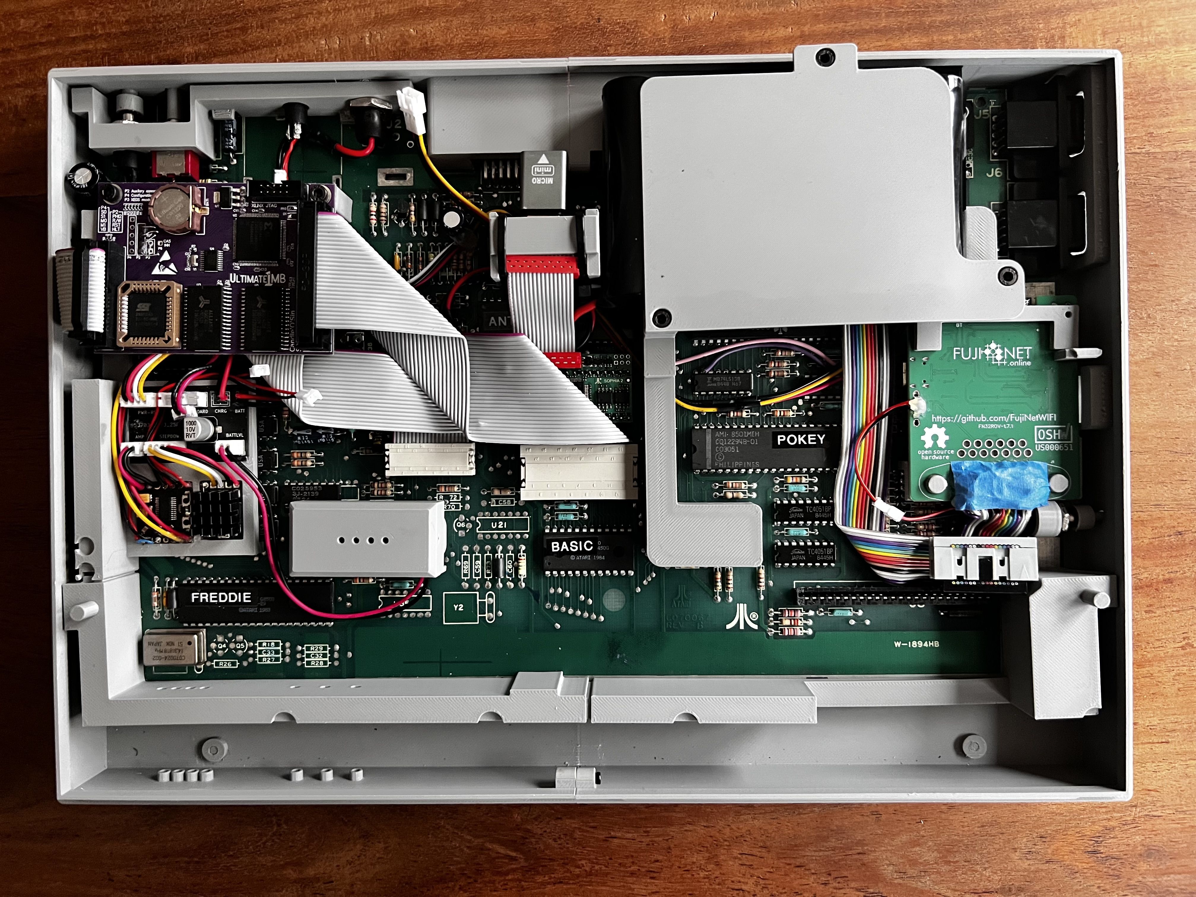

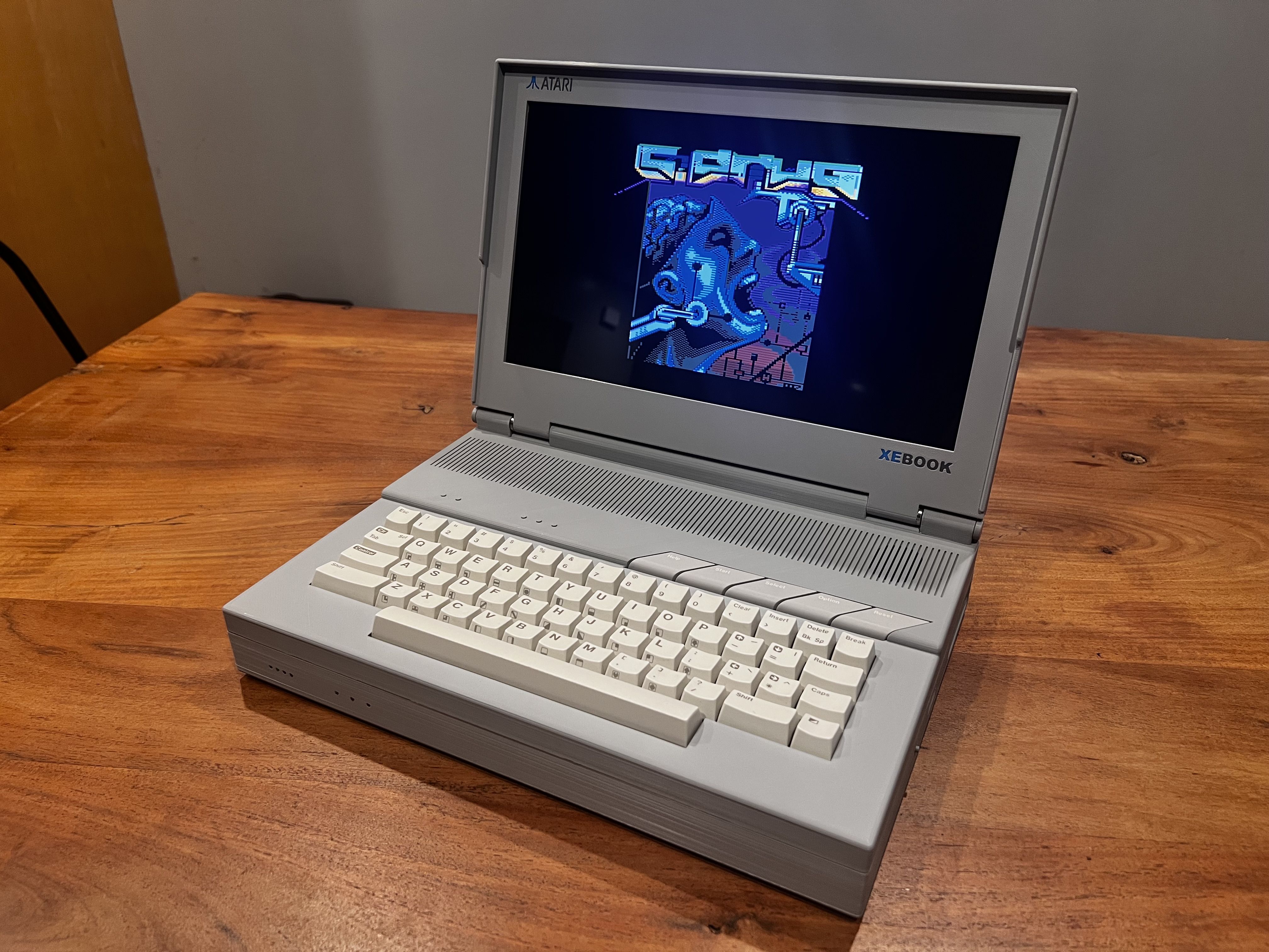

Posting my 130xe laptop (XEBook) here.
grand plan is to do a short run of them once some more details are ironed out (making an all in one consolidated power and sound management board and CNC milling the hinges myself to shave costs down) or offer conversion kits.
Inside is an original 130Xe motherboard with the following mods:
• 1MB ram upgrade
• Fujinet WiFi and SD drive
• Stereo Sound amp and built in speakers
• 6 hour lithium ion battery
• High res LCD video driver

The sheer amount of work that went into this project is stunning. What a beautiful result! This is genius level stuff, @Sideburn. You should be very proud of that accomplishment. Bravo! 👏
