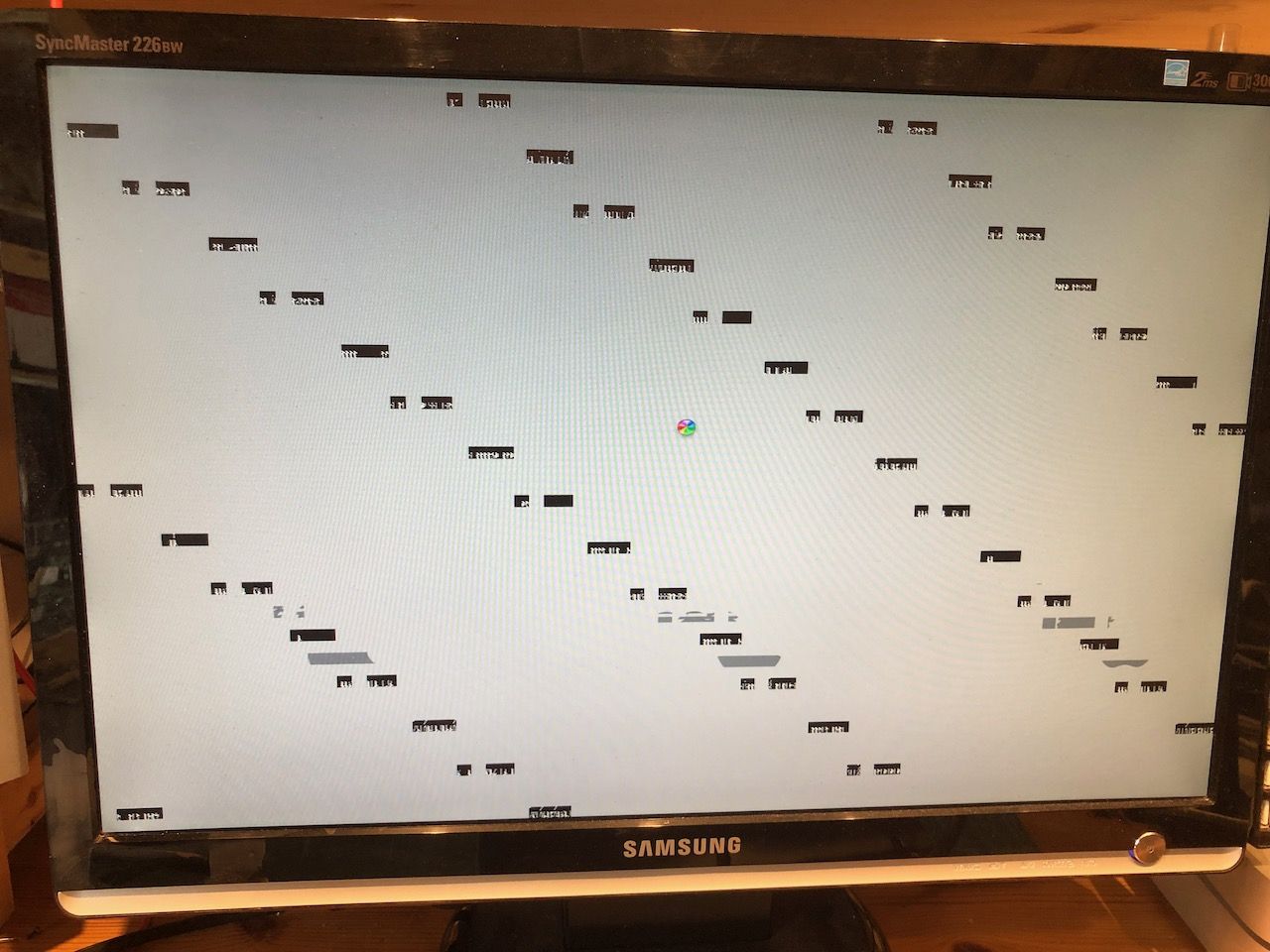

*Hrm* Anyway, I got my XServe 1.1 2x 3.0GHZ 2006 Xserve home yesterday, after a month or so of waiting so what better way to kill a few hours than to start it up and see what's what? I starts right up, but since there were no disks in it, I plopped a 1TB Seagate in to bay 1 and figured I'd install 10.5 or 10.6 server on it. So I made a couple of bootable install partitions on a FireWire disk and held down the option key. Cool! It finds both partitions! So I selected 10.6 and moved forward.
No. Chance.
It finds the partition, I get the dark grey apple on the light grey background. But as soon as it is about to enter the installer/desktop it either gives me a grey screen, or a blue screen. That's it. No cursor, no nothing. Some times, if I wait long enough the cursor will show up with a bunch of 10x10mm'ish black squares. Once or twice, I have been able to access the "select language" menu in the installer but when I have selected lingo it just... does nothing. I can sometimes move the cursor at this stage, sometimes it freezes.

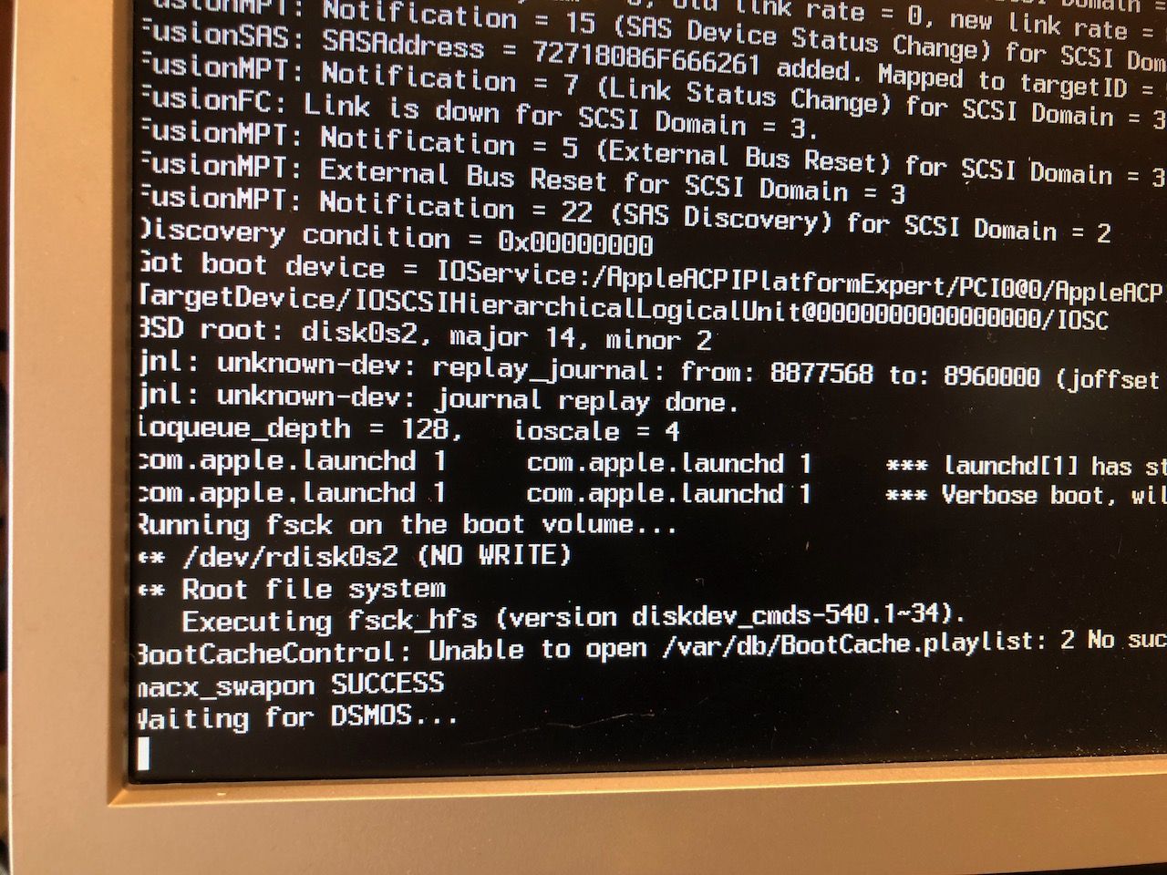

- Verbose boot from boot partition gives me "Waiting for DMOS" even if I delete the Don't Steal Mac OS.kext), and stops there indefinitely.

Some imagery of the Xserve tantrums
