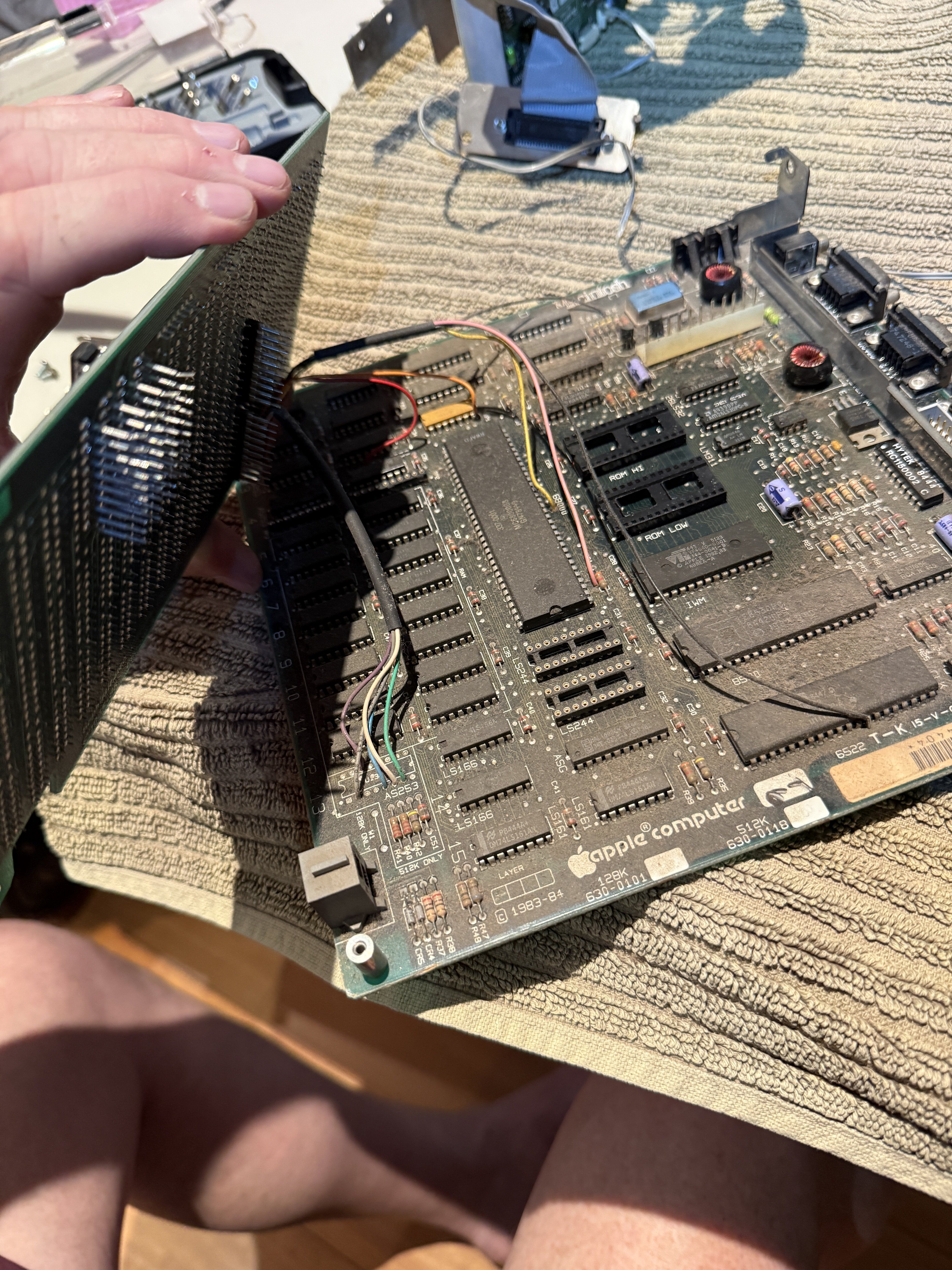

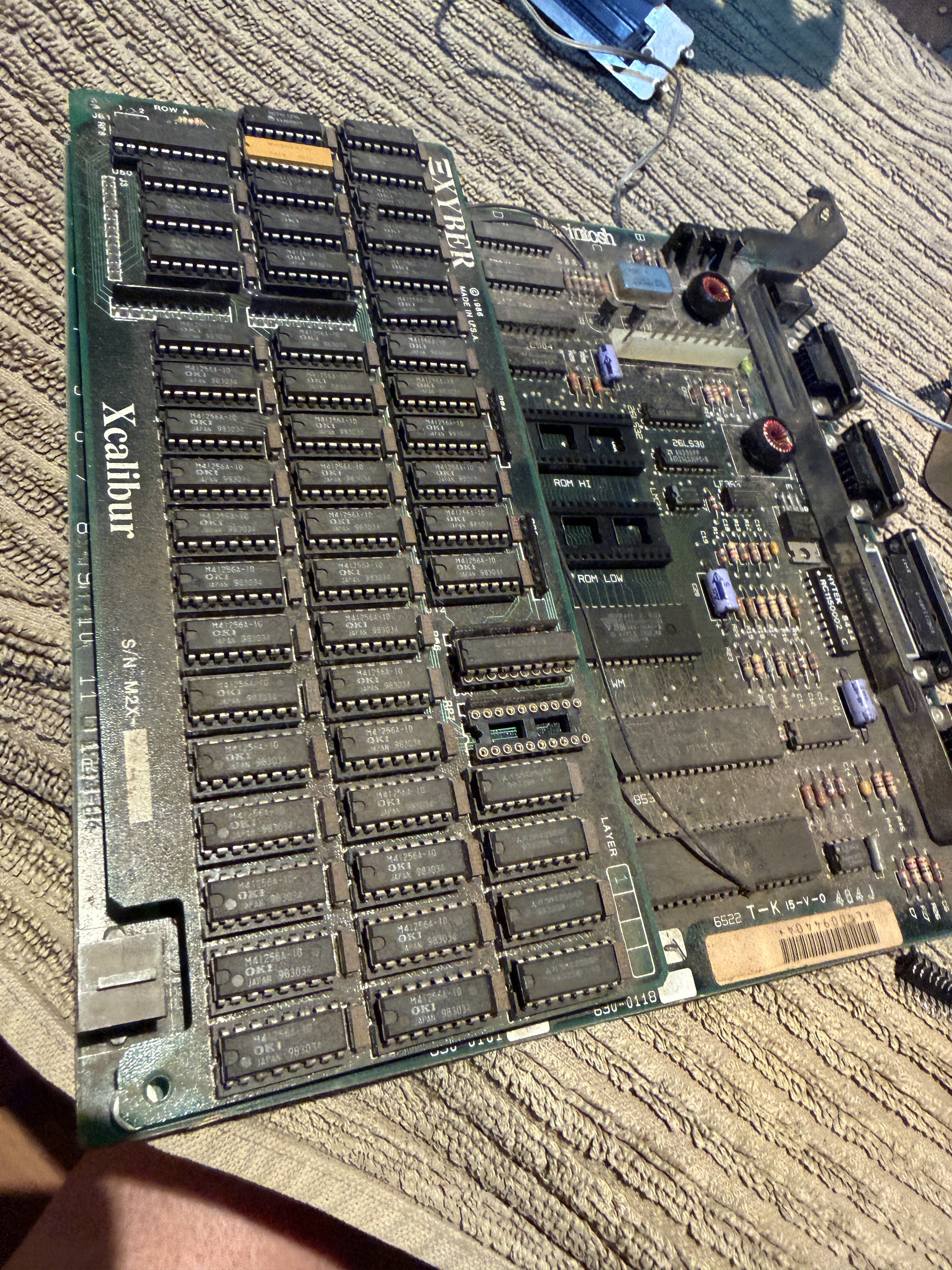

Hi folks. Complete newbie to this board and this hobby. My name is Chris, I'm an anesthesiologist from Sydney Australia. Started coding at age 9 on the Exidy Sorceror, but never much of a hardware guy.
Inspired by Colin at "This Does Not Compute" YouTube channel I sourced a M0001 1984 Mac intending to restore it; had a sad Mac indicating a dodgy RAM chip, so the plan was to open it and replace the chip.
However, on opening it I discovered there was extensive internal modifications - in particular a Xyber Xcaliber RAM upgrade piggy backed on the motherboard. It was all jammed in tight, and in removing the motherboard from the chassis one of the chips on this board came off and was damaged. I expect it is damaged beyond repair.
I'd like to just take this upgrade board off and return the Mac to its humble 128k, but uncertain how to start. The board clicks in but also has lots of extra wiring - can these just be clipped off? Any guidance apprecaited!

Hi Chris, welcome to the hobby!
First off, I’d recommend grabbing a good set of schematics for the Macintosh 128K/512K. They are widely available online and will be your best friend for this project.
Looking at your pictures, that motherboard doesn't actually seem to match the first revision of the Macintosh 128K. That PCB looks like the later revision used for the 128K/512K or 512Ke. Since there is no jumper in place at W1, your board is a 512K or 512Ke, depending on which ROMs are installed. By the way, the ROMs seem to be missing, or perhaps there was another daughterboard installed on top of their sockets, likely a SCSI interface.
To return it to stock, you will need to do more than just clip the bodge wires. You’ll need to reinstall five specific components that were migrated from the motherboard onto the Xcaliber board:
  • RP2 & RP3: 47-ohm resistor packs.
  • U12E & U13E: 74LS244 chips.
  • U13G: A 74LS253 chip for the footprint where most of the bodge cables originate.
If you think those 74LS244/253 chips or the SIP resistor packs were damaged during the mishap, you can easily buy new ones.
A few tips for the reinstall:
  1. Check the Pins: Ensure the resistor pack pins are in good shape and make tight, reliable contact with the pin header sockets on the motherboard. Since the footprint for U13G has no socket, I’d advise soldering a new one in place rather than soldering the 74LS253 chip directly to the board.
  2. Leave the Sockets: I don't recommend removing the sockets already installed at the RP2, RP3, U12E, and U13E footprints. If you try to desolder them without the proper tools, it is very easy to accidentally lift a pad.
  3. Inspect for Cut Traces: It is unlikely this specific RAM expansion required cutting traces, but definitely give the motherboard a close look for any evidence of that. Take a detailed look especially around the TSM chip.
Good luck getting that Mac back to its original state!
Thanks so much for the very helpful reply!
U12E and U13E - it was indeed one of these chips that was damaged; I've ordered more
RP2 & RP3 - these are soldered onto the expansion board - is there a place I could buy replacements? Otherwise I guess I will desolder and then as you recommend plug into the sockets
U13G - this chip looks different to 1-12, and there a few versions of 74LS253 online - does it matter which I use? I've ordered a Texas Instruments SN74F253N - will that be suitable?
The Sad Mac error I had was 020800 - I took this as meaning the RAM chip at G8 needed to be replaced (Dead Mac Scrolls P135) - does that sound right.
Again much thanks!

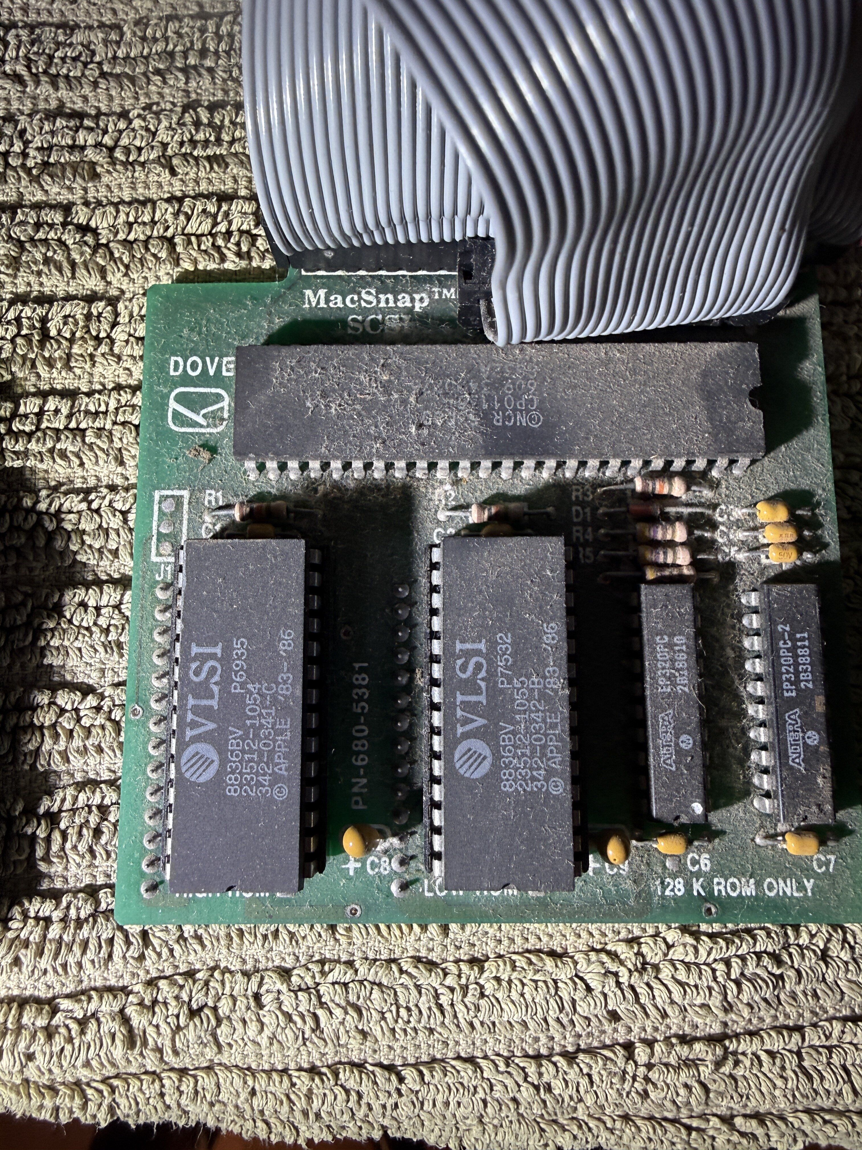

Yes, this upgrade included a hard drive, which as you say is on a daughterboard for a SCSI interface - can I just reinstall those ROMS onto the motherboard?
Yes, you can reinstall the ROMs directly onto the motherboard.
