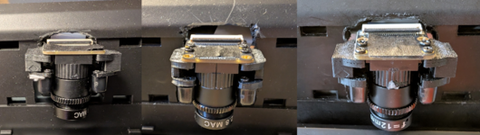

My three units.

ok, that clears up my confusion. thank you and lastly, how do I know how much to "cut out" and raise the camera unit?
Tuesday at 4:40 PM
That is the older design, use the STLs linked in https://tinkerdifferent.com/threads...-film-digitizer-firmware-hack.2897/post-42590
Tuesday at 4:38 PM
P
P-car
apologies if im being redundant, but what is the piece shown in the image? and where can I get the STL files, please.
