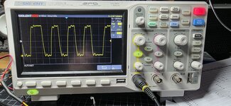

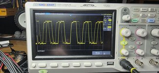

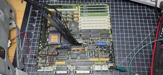

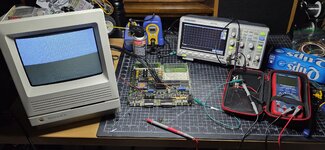

Thanks David... especially for the shot of the traces under the chips... it really helped. Unfortunately still the same issue. Another...

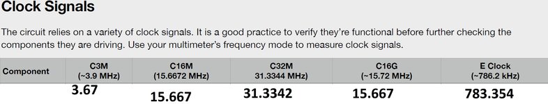

The 'main' Xtal has 31.334 MHz written on it, that and the C16M 16.667 Mhz clock is perfectly in speed with the guide. I'm having...

Nixontheknight
I think the rest of the signals are generated from one of the chips, but I'm not sure which

Are there more crystals than the largest rectangular one? How would I confirm the C3M clock is having problems in this case?

Nixontheknight
it's that metal looking chip towards the middle of the board

GreenBar0n
Where is that exactly, and how would I check it? Thanks!

Nixontheknight
check the main crystal, maybe something's up with it
