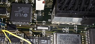

I was using a very long ground lead, I'll make it as short as possible and measure again at Y3, UE10 and C33 and C34, to make certain of...

Before discussing the details of waveform shapes, we need to assess if your scope probe is using a short or long ground lead, which is...

I feel like I keep repeating myself, because I've replied to two different forums, and many threads trying to narrow down where the...
