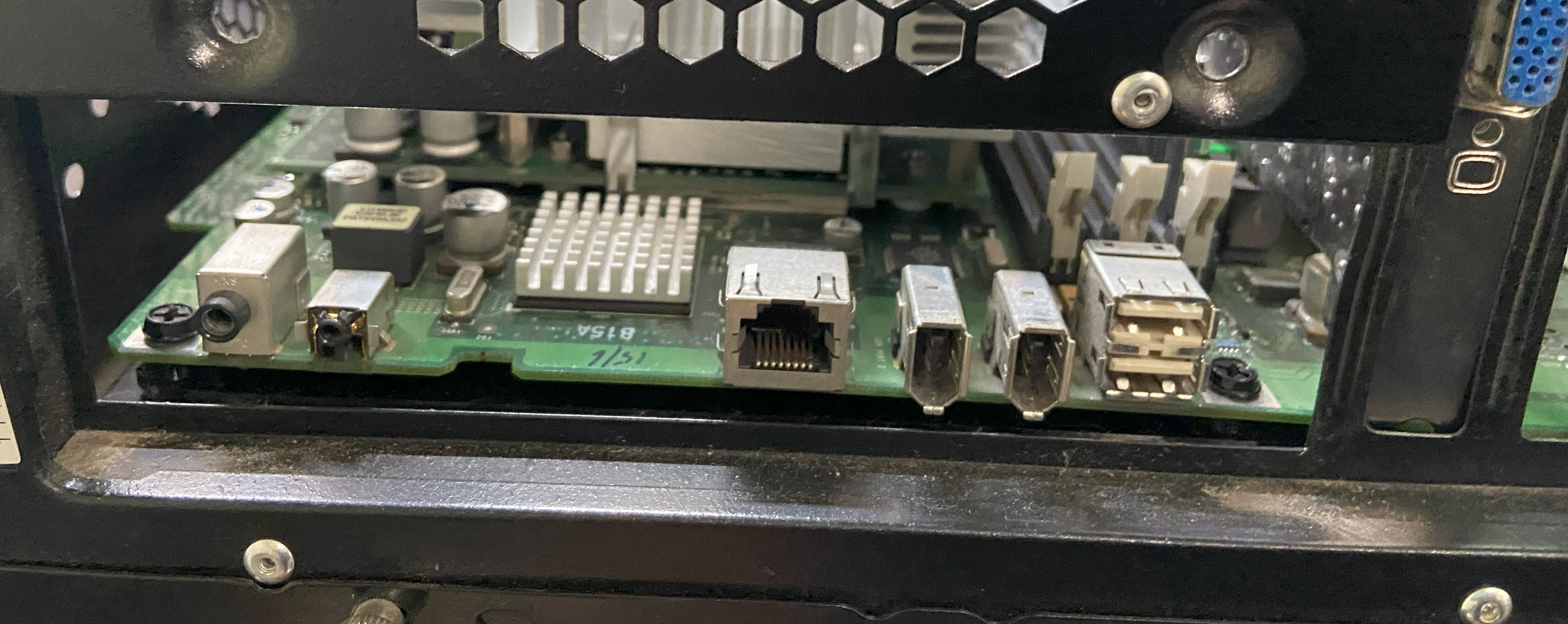

So here is what it looks like in the test fit case with the top ATX bracket made so far
Sorry the Case is a bit dirty. It was the only Flat bottom ATX case I had. I am waiting on the new case which will have everything I need to make this Fancy. I am going to use a Fractal Design Air Pop Green ATX case. I am going to also put in an Zip 250 Smoke Black and a DVD slot load slim drive. I will also be using a 128GB Drive with dual Boot OSX and MacOS 9.2.2
