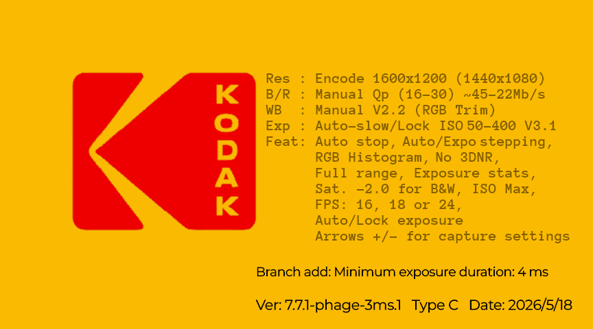

To make this slight adjustment to the firmware, I heavily utilized Claude to walk me step-by-step through the process to adjust the 0dan0 C code, compile it, and package it with an updated custom boot screen. It was a good learning opportunity for me and I'm quite impressed that (eventually) I was able to make the change I desired (and even better that the change seems to have successfully mitigated the issue).
For documentation, the shutter floor of 3ms (3000us) and preceeding comment was added into this section of the hist.c code (addition is highlighted):

One unresolved issue is that my firmware fork was not able to successfully complete the flashing process as other firmware releases have (with the auto-delete feature via the NVTDELFW folder). So, unfortunately, the FW update process is a bit scary: I power the unit on with the firmware file on the SD Card, wait well beyond the standard 30 seconds (maybe 2 minutes to be safe), and then power the unit off (hold the power button). I then remove the SD card, wipe it with my computer, re-insert it into the scanner, and power it on (and see the custom boot screen to verify it's successfully flashed).
