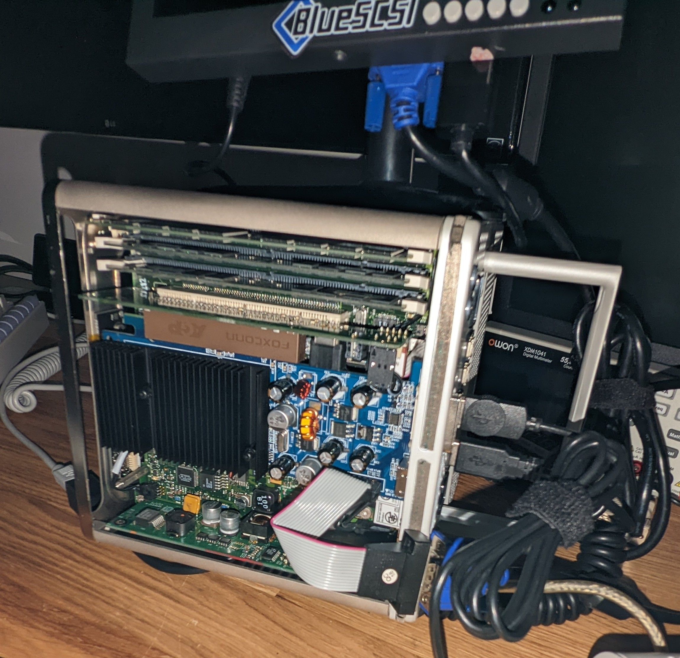

Refer back to post #78 to see how I twisted the power cable 180 for the SSD adapter. Not wanting to pull it out right now, so this is the best shot I have, but looks like your #4+7+9 (power cable upside down).
Looks like I used #10 for the optical drive plus an additional cable to convert the 7+15pin to 7+6pin Sata+Power.
Slot load SATA dvd from an old iMac (unknown model).

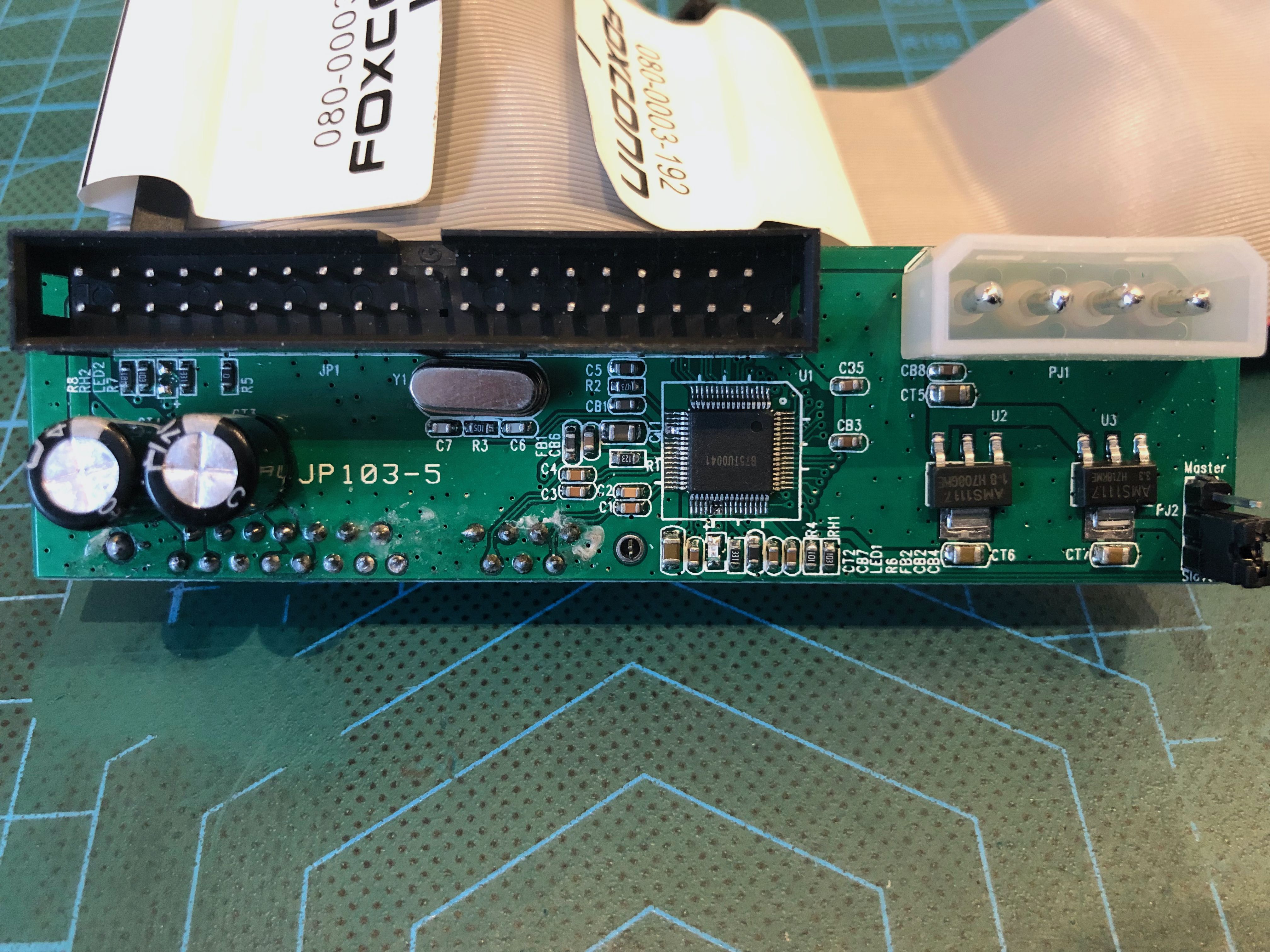

It is likely you could use an older slot load optical drive that has the ATAPI connector and find an IDE adapter with a master/slave jumper. This one does not have a master/slave jumper.

You've already provided many solutions, but I'll briefly share my experience. I have SSDs in all my G3 and G4 Macs, and I've used these adapters, all with JMicron. I've only had some incompatibility with the SATA or mSATA HDD used, but using another brand has worked for me.
For 3.5" I use this one:
https://es.aliexpress.com/item/2055...st_main.5.2e23194dH05Beq&gatewayAdapt=glo2esp
And for 2.5" this one:
https://es.aliexpress.com/item/1005...t_main.31.2e23194dH05Beq&gatewayAdapt=glo2esp
https://es.aliexpress.com/item/1005...t_main.86.2e23194dH05Beq&gatewayAdapt=glo2esp
They work on Pismo, Lombard, and Mac Mini G4. The 3.5" one also works for me on the Cube.
Just a detail: this happens to me on all Macs that share an ATA connector and use Master/Slave. OSX Sorbet Leopard works without problems, but OS9 struggles to recognize the first partition, but it boots. First, the floppy disk appears, but after a few seconds, OS9 boots. This doesn't happen if there's no Master/Slave.
