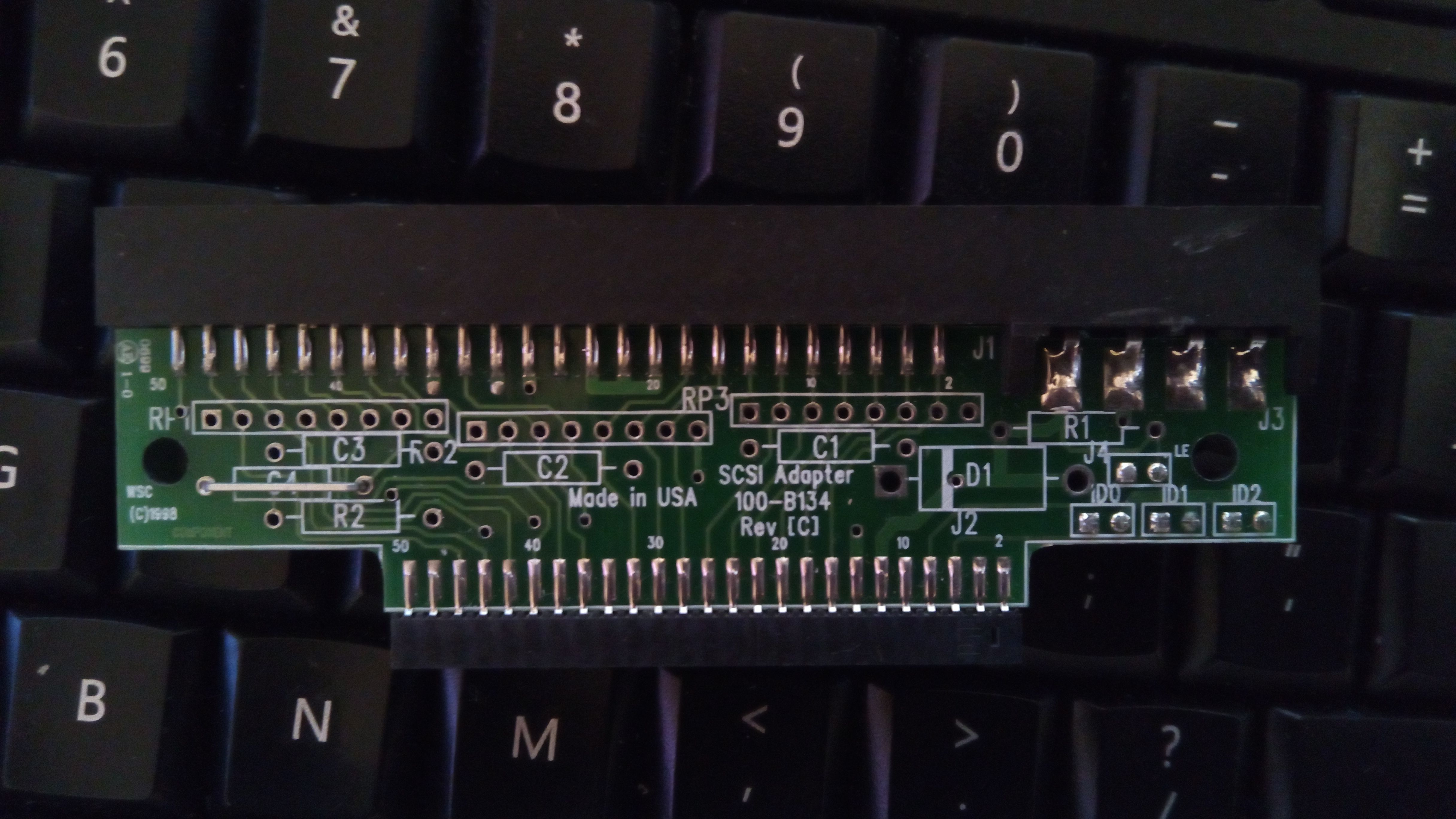

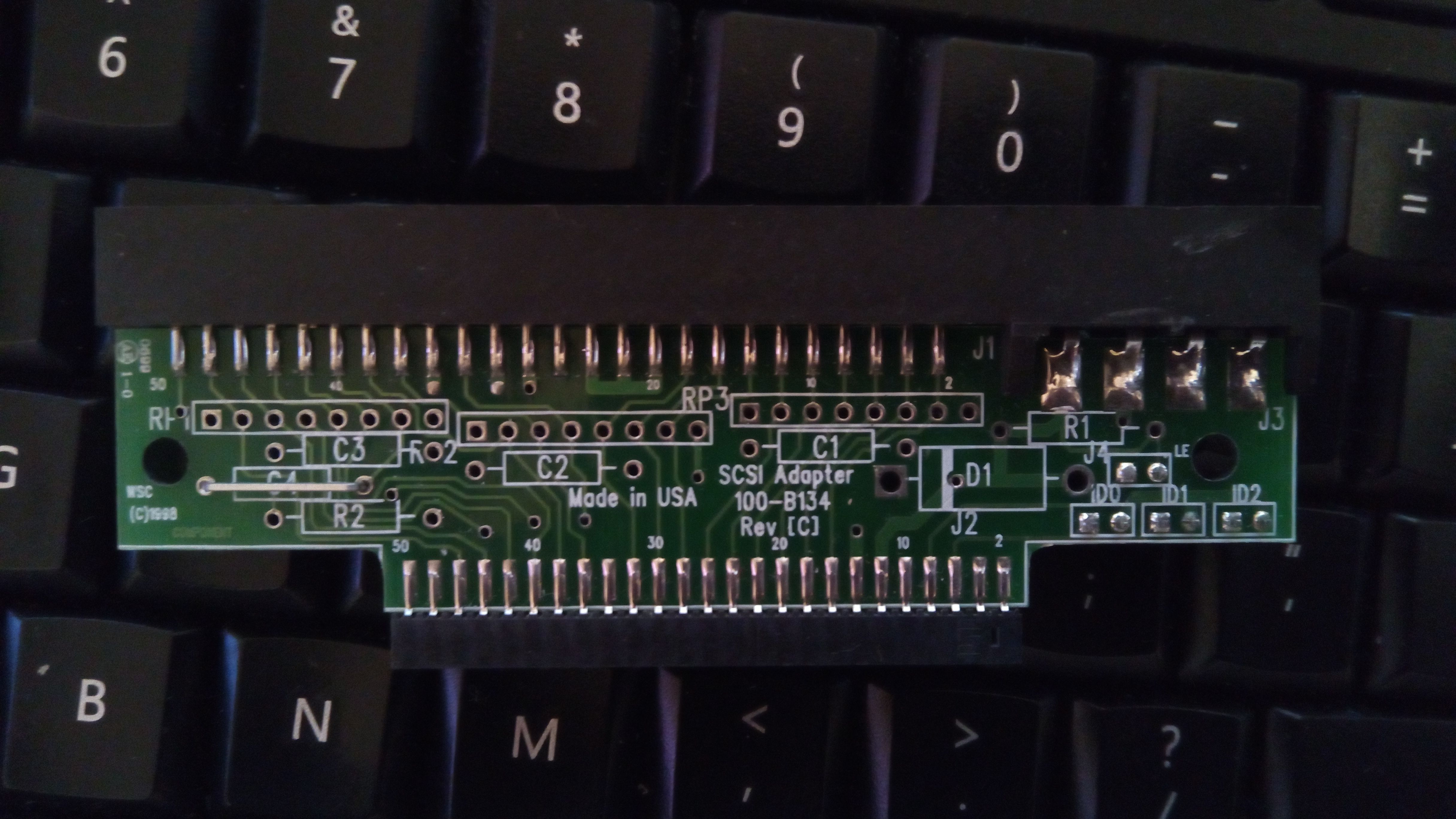

At the very least I'd love to see some good quality photos of it to see if I can make my own.

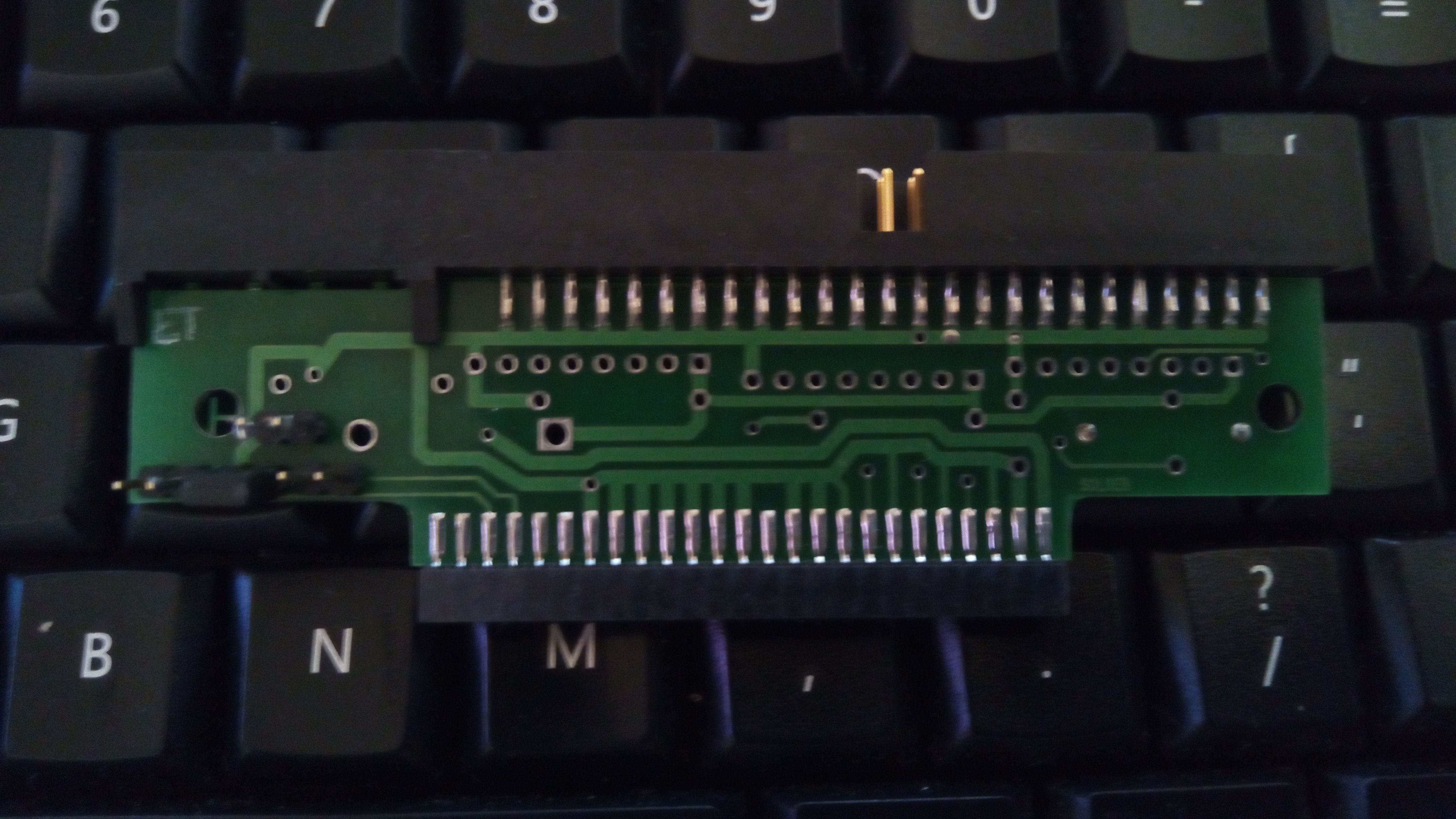

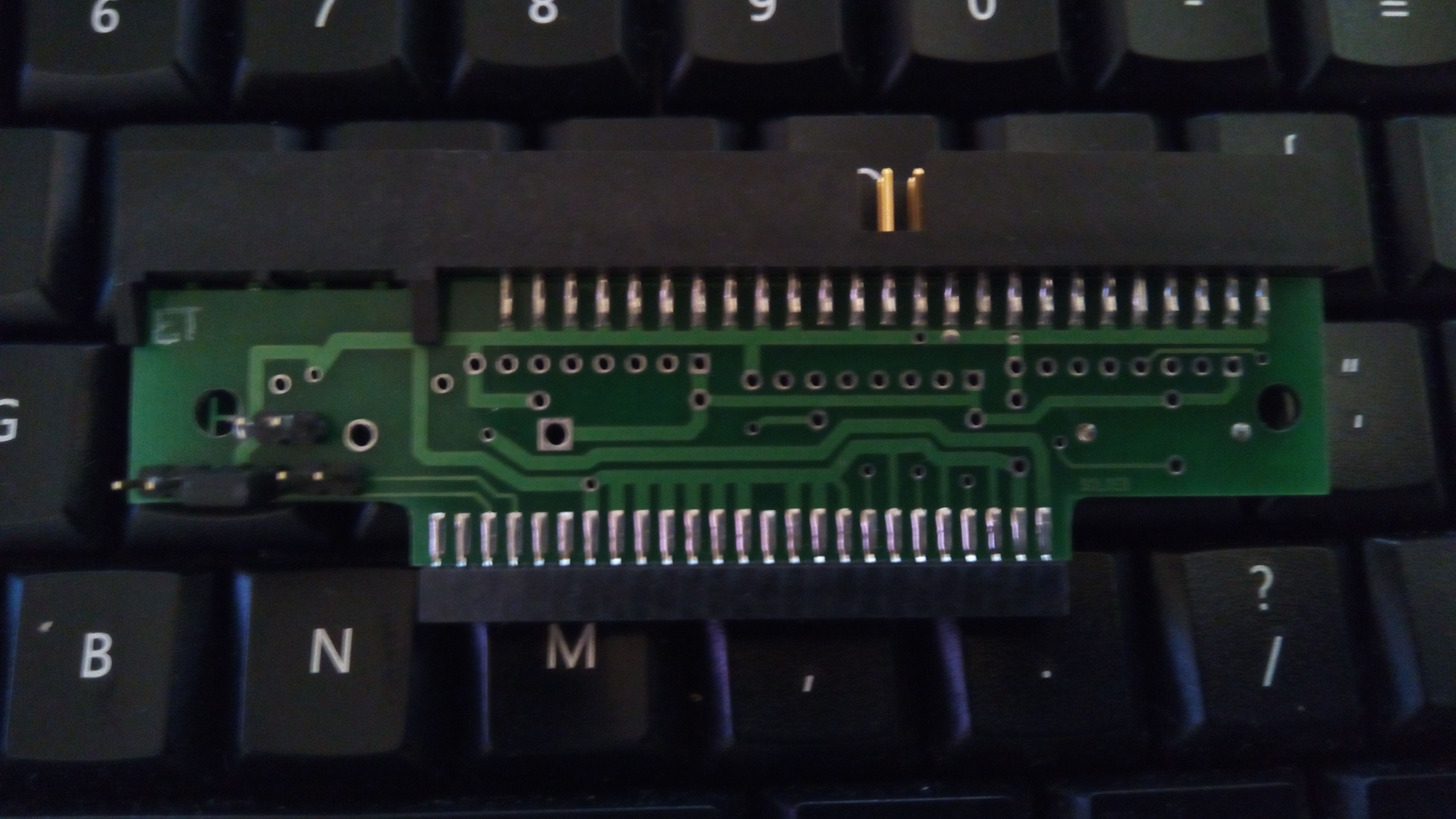

Thank you once again @Androda! The PCB arrived today, I put it together and it's exactly what I was after. I decided to attach a whip cable with a Molex connector instead of the Berg as it suits my needs better.

I'm a little late to the party, but I picked up one of these earlier in the year and it works as advertised. Not as much geek cred as building a PCB yourself, of course.

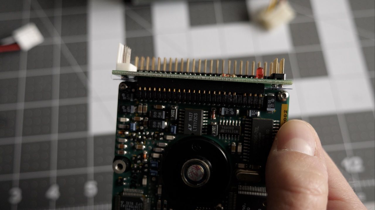

The thing that puzzles me is that the 2.5" connector is 50 pins. Isn't the connector/cable on the 2.5" drive 40 pins?
Does the adapter cover the SCSI ID pins and then move that functionality to the jumpers on the adapter?

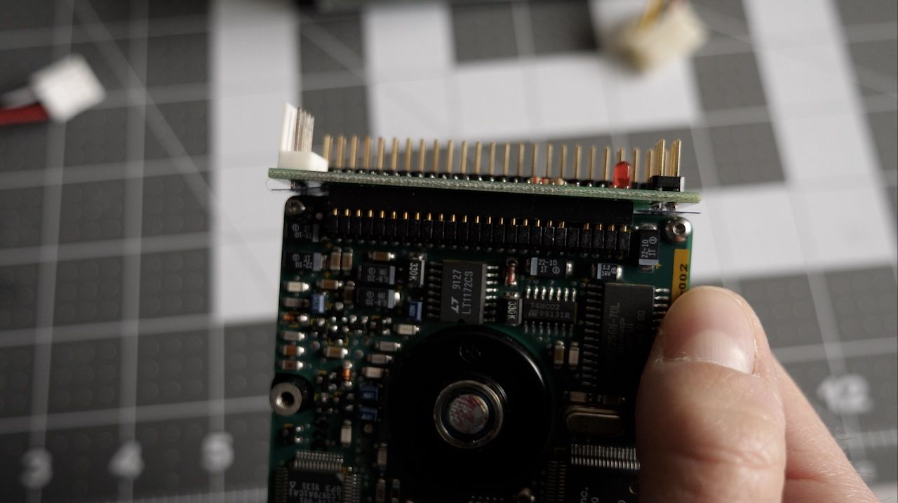

The adapter provides power to the 2.5" drive, and does indeed "move" the SCSI ID jumpers to the adapter's PCB. Here's a shot of the adapter connected to a drive; the SCSI jumpers are on the right and the power input is on the left.

With the benefit of hindsight, a little adapter like this would have been perfect, but having gone down the path of assembling my own, I do quite like having the ability to connect two drives to the one adapter.
