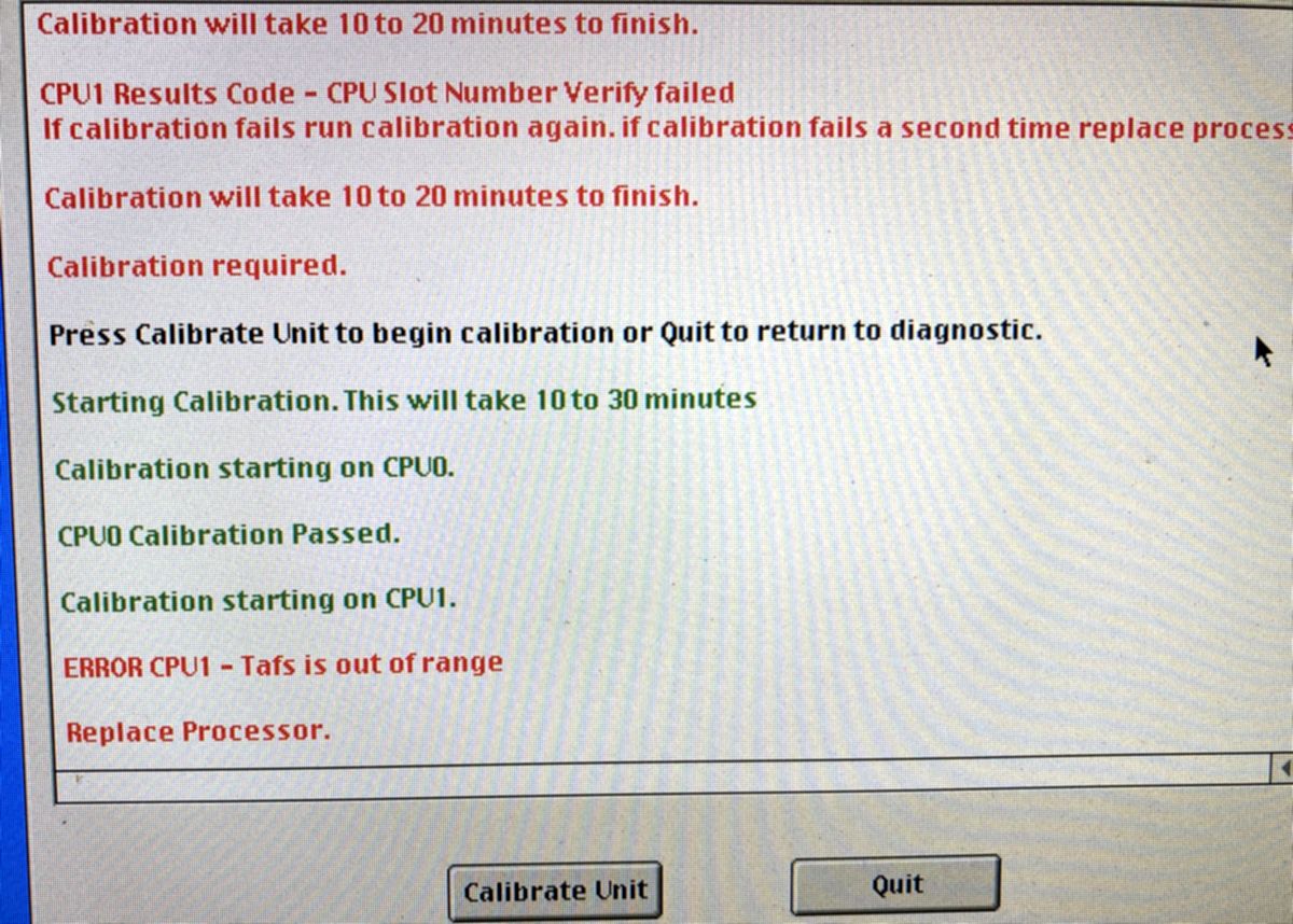

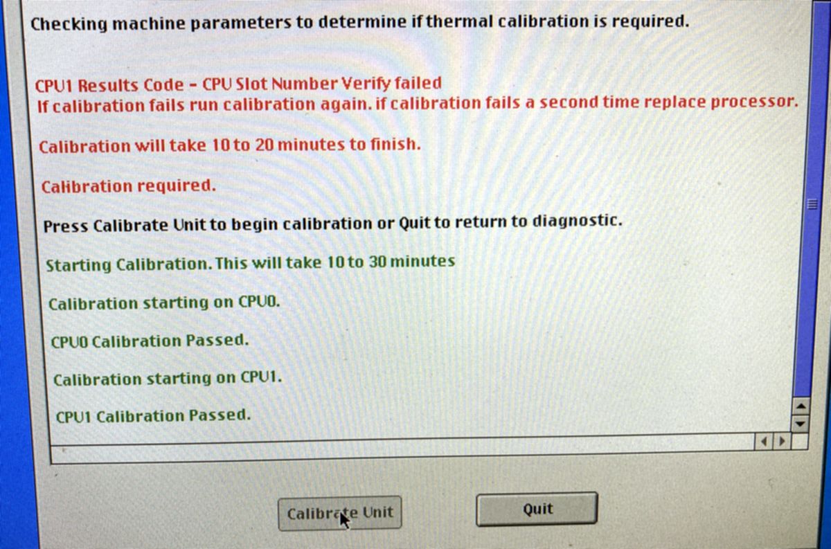

I ran the Thermal Calibration on the dual 1.8 Unit A last night and it failed.
Swapped out a processor from the "flaky" B unit and ran the tcal again this morning with success!

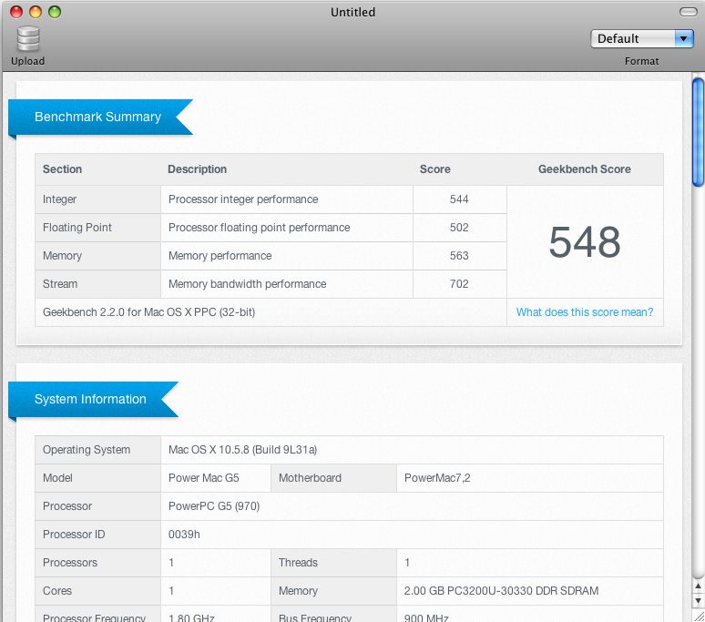

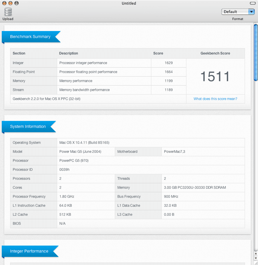

Both CPUs are recognized. Benchmarked with GB 2.20 PPC, about a 50% increase from the previous single CPU score.

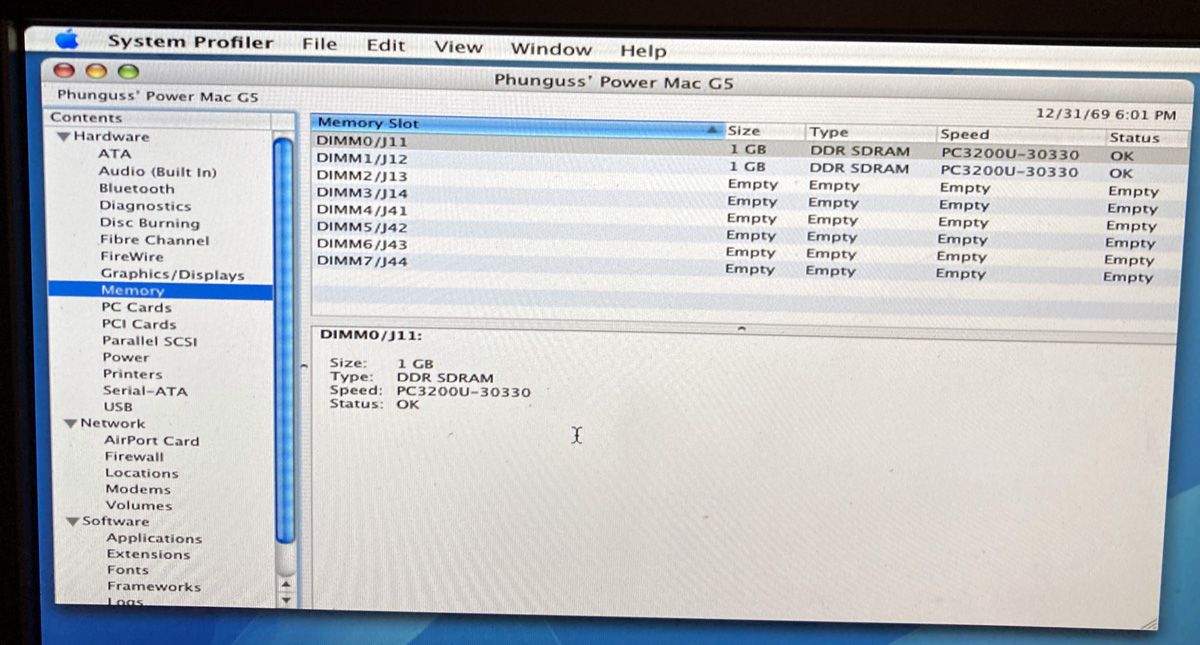

I stopped at Free Geek Minneapolis to have a gander. I picked up 4x1G PC3200U for my G5 units A & C, bringing them up to 4GB and 7GB. I also grabbed 4x2GB PC2-6400 for my G5 Quad, bringing that up to 11GB.

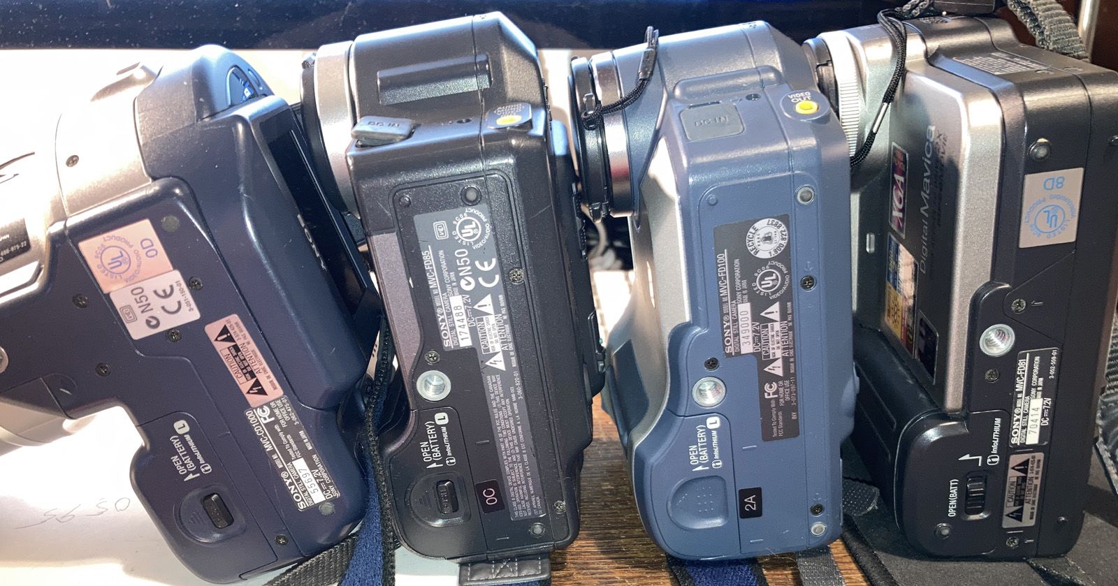

I saw a $5 Sony Mavica CD1000 camera, one I have been looking for. Untested, as-is, no returns. No battery, no power supply. I took the chance. Got home and it powered up fine. But it didn't like the mini DVD-Rs that I had, so I ordered some CD-R and CD-RW off eBay to try later. Just add this to my Mavica Collection.
MVC-CD1000 (mini-CD), MVC-FD85 Floppy, MVC-FD100 Floppy, MVC-FD81 Floppy. All in working condition with batteries. I only have the single power supply, but I know i have a Sony Mini-DV camcorder that the power supply may work on these cameras.

Nice TOTC Sony collection - great score on the CD1000! I have a modest Sony Maciva/cybershot collection (just two lol)
I’ve had the cybershot DSC-S30 above since new, Christmas 2000. It was a gift from my grandpa. I love that camera :cool:.
I later got the Mavica as part of a trade around 2010ish (?) - musician buddy of mine owed me some money & was tight himself so offered that up as trade, which I took him up on.
