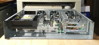

Made some progress on layout, trimmed plexi plate to fit atop the bottom cover plate of the 4U Netrat 1125 for visualization until the 2U Case arrives. It's fans will be at the back, pulling air in from the filtered 2U Netra T2000 front panel.
Board is set back from the front for cable management and 5.25" multifunction bay that houses laptop DVD. Cable races on left and right sides. Top will be hinged plexi for access to both sides. DVD and PSU are standins for fitment tests.
500w 1U PSU on the way, that's probably enough power.
It'll all fit, waiting time for parts now.

Well, no plan of battle survives contact with the enemy . . . so it goes . . .
I LOVE this case, all machine screws, no rivets or spot welds connecting anything! But it does come up short of the acreage across which I'd splayed the components out in the pic above. Bobtailed butt sitting atop the bottom cover of the much deeper 4U Netrat here:
So after an afternoon of Inverse Jenga playtime, I was ALMOST able to cram everything in that I'd had in the pic above. Looks like I'll be losing the 3.5" HDD, but have room for at least a pair of the 2.5" variety . . . you can't always get what you want . . .
It all boils down to the dimensions of the PSU heading my way. Might work, might have to find another one that does? I have to put the PSU of either available width into the "Upper U" so it overlaps the floppy connector, but falls short of the PSU's cache extension wing. Depth has to be the shorter 190mm variety, but either 81.5mm or 100mm width units will do.
Pulling the removable media bay almost fully forward provides for drive & power cable clearance. It'll make media handling much more convenient.
That's three different setbacks already, maybe a couple more setback levels coming up!
Left side fan pulls air almost directly across the heat sink! They're three pin interface, but I'll probably just run that one at 5v, the others at 3.3v and call it done? No need to muck about with the back cover! It's all PSU hole, short PCI slot, ATX bung hole or grating!
Was hoping to keep the plexi base under the logic board, but pretty sure I'll need the height.
25+ friggin' standoffs drilled out! :rolleyes:
