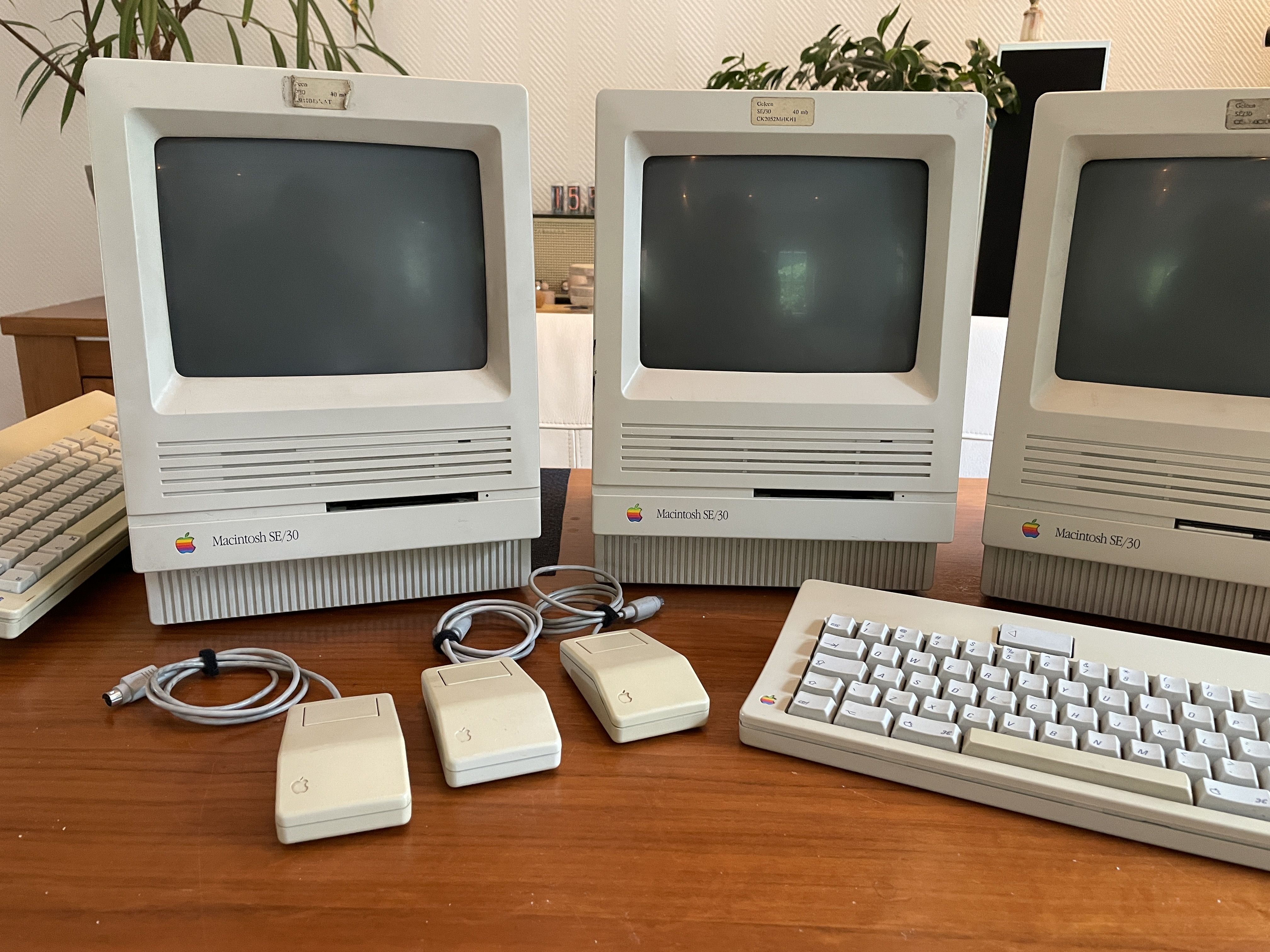

Today I finally picked up not one, not two, but three Macintosh SE/30 machines. My goal is to restore these to working condition. I’m planning to keep at least one SE/30 (if any make it at all) to upgrade and tinker around.
I want to use this thread as a log and document my progress. and also to ask questions and receive some feedback along the way. Hopefully this is the correct subforum for such a post and of interest to the members.
My starting point of this journey is: I have been looking for a project SE/30 for a while. I decided the on SE/30 for mostly its era, compactness and upgradability. Several sales didn’t go through until recently. These three were listed on local classifieds and were part of a practitioner’s office. These Macs never moved home until today. From the listing I gather that the right SE/30 powers on, shows a cursor and then throws error that it can find boot media. But since these machines have not seen use or service in a very long time I wont be powering them on for now.
Next, I’m going to do a full disassembly, inspection and some cleaning, just to get a better sense of the state of matters. Will I find exploded batteries? Devastated boards from capacitor leaking? Or some really cool upgrades? Till next time…

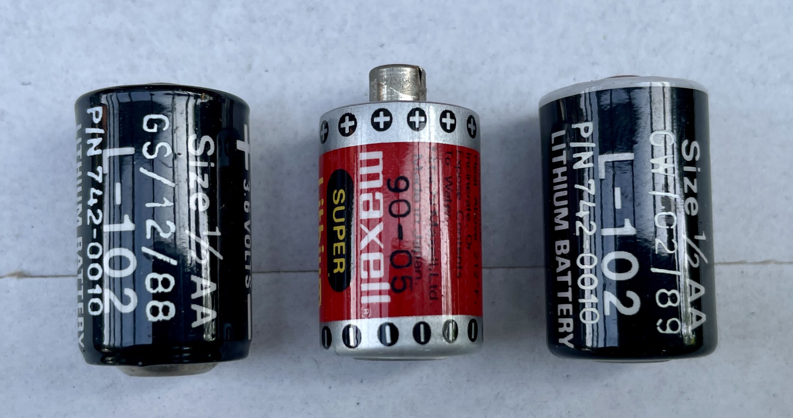

1) The original batteries were in tact on all three boards. I measured the batteries but they were obviously all flat (less than 0.01 V).

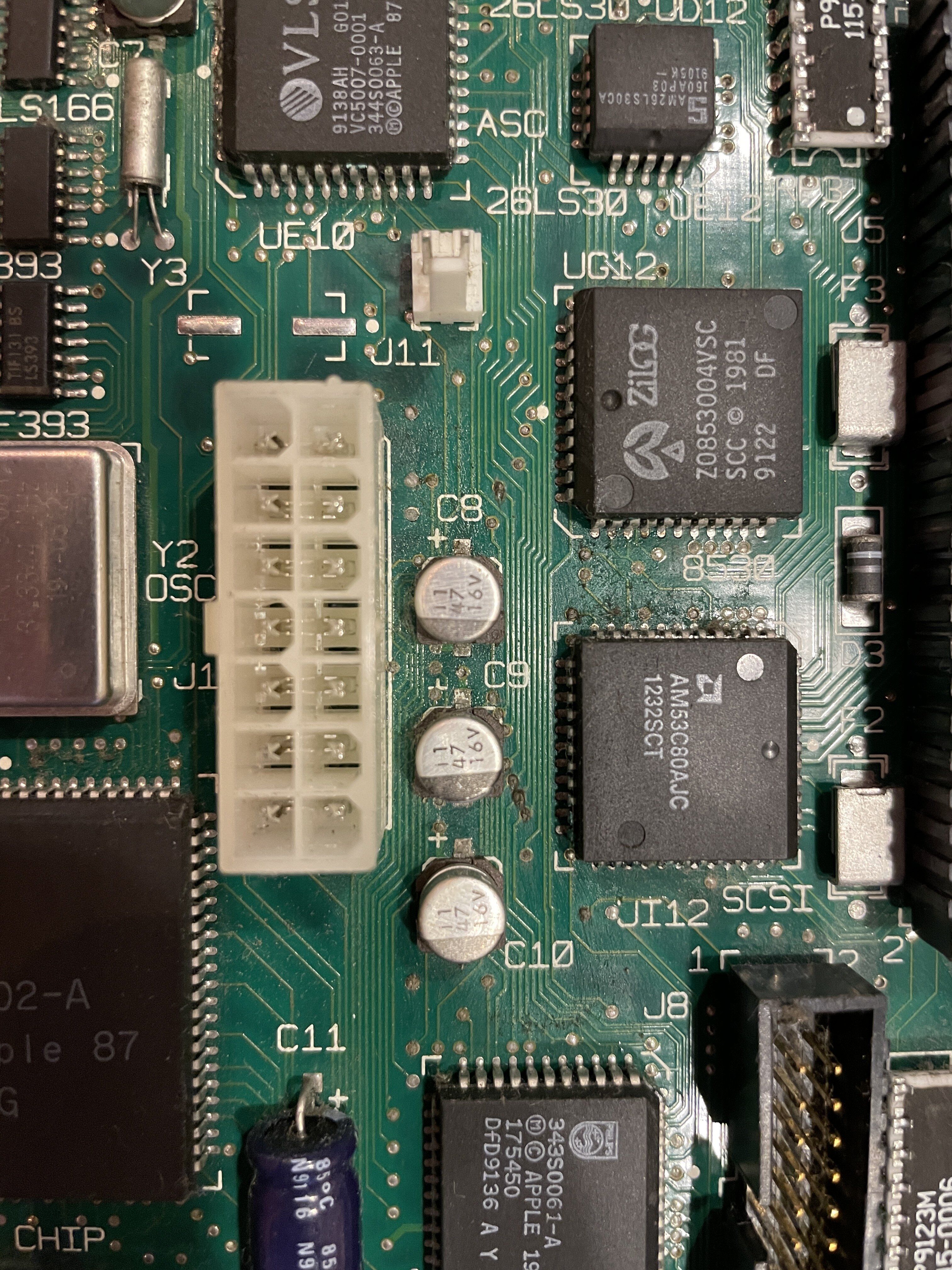

2) There is definitely capacitor leakage on one board. It is worst around C9 were the vias (?? the little dots that go through the boards) are very crusty and not shiny. I’m really not sure how bad this is. What does anyone with more experience think?

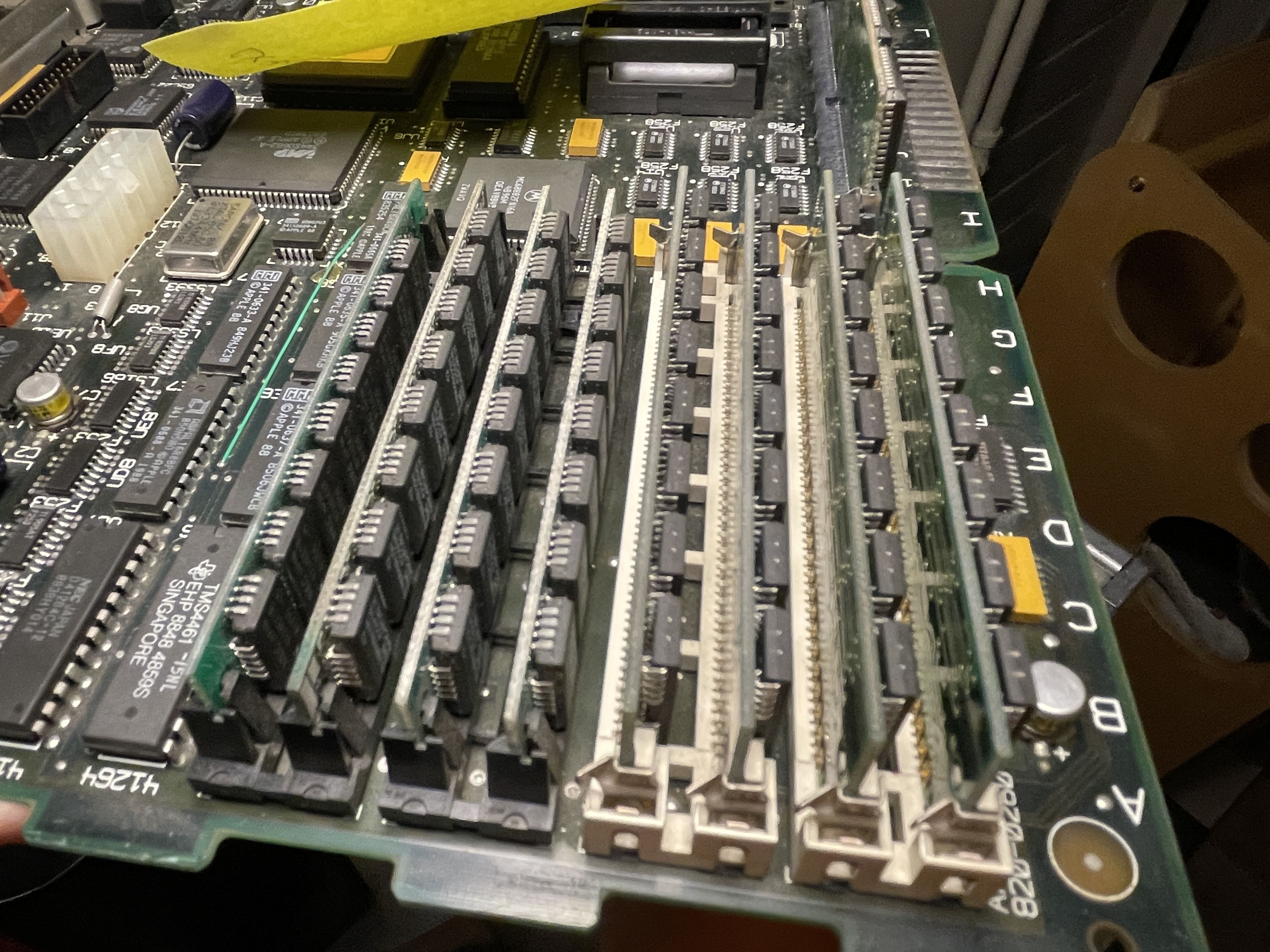

3) One board has a bunch of repairs: a botch wire, four metal clipped RAM sockets and a metal clipped ROM socket.

That bodge wire is from factory.
Very nice finds! Congratulations!!
Bodge wire is a factory modification to fix a certain combination of chips. One of three(?) revisions of the SE/30 board had metal clips pre-installed, so that's a good find! I doubt much work was done on the board.
Thanks for the clarification and the correct spelling of bodge :) (I must have only heard it till now).
If the sockets and bodge wire are factory and a different revision, there are three unique revisions here. Two have a socketed CPU, the other one is soldered in. The later board also has a different sticker on the case.

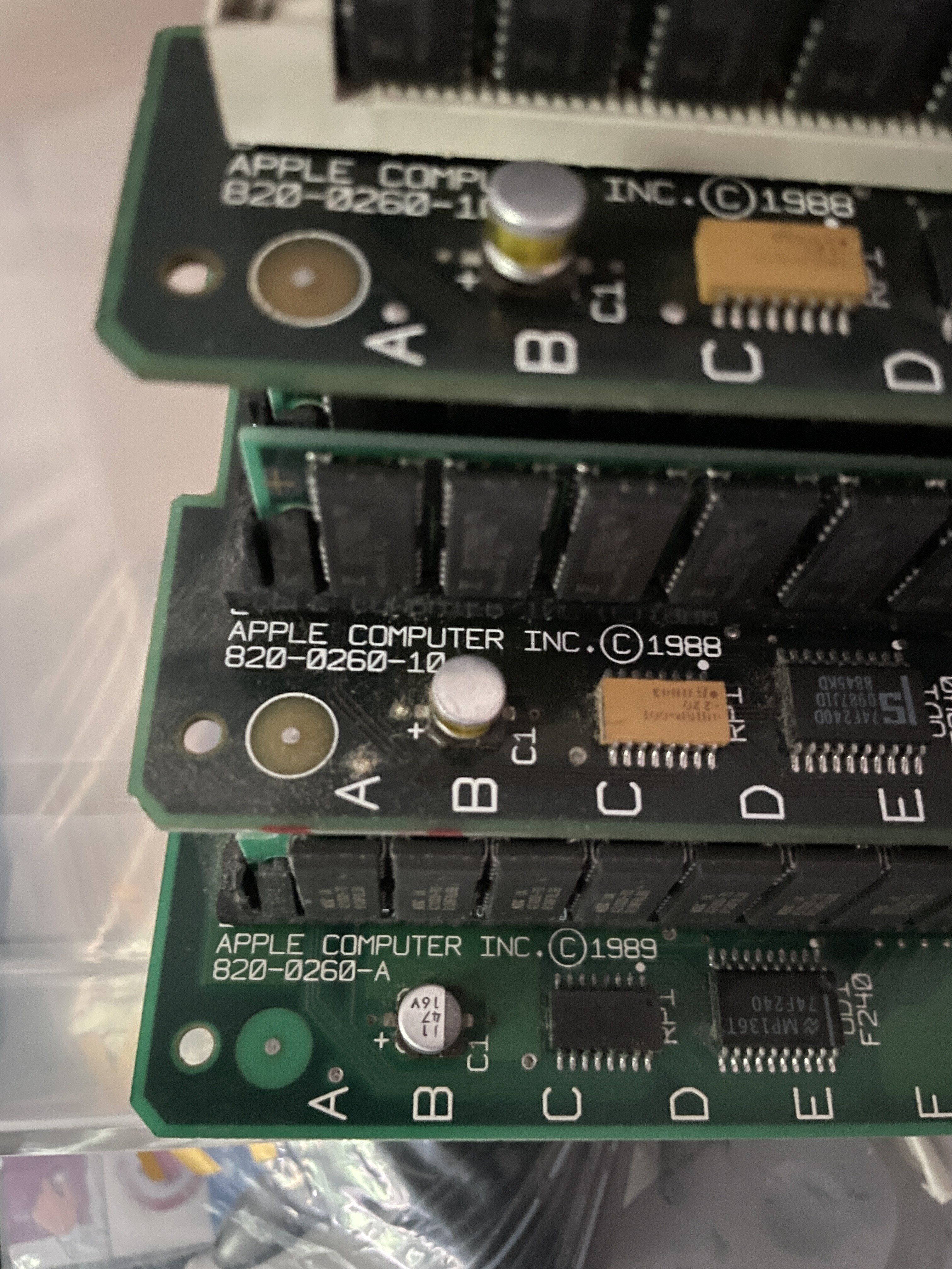

So I have now recapped, cleaned and tested the three analog boards. All boards definitely had leaking caps to varying degrees. The fish smell in combination with the hot air was nauseating. Due to the corrosion from the electrolyte and thorough cleaning of the pads (followed Branchus Creations’s approach here), and the broader pads of the tantalum, I didn’t have a lot of confidence in the traces run near the caps. I chose to add a layer of new solder mask near the caps, it looks a bit bad up close, but I don’t want to take any risks here.

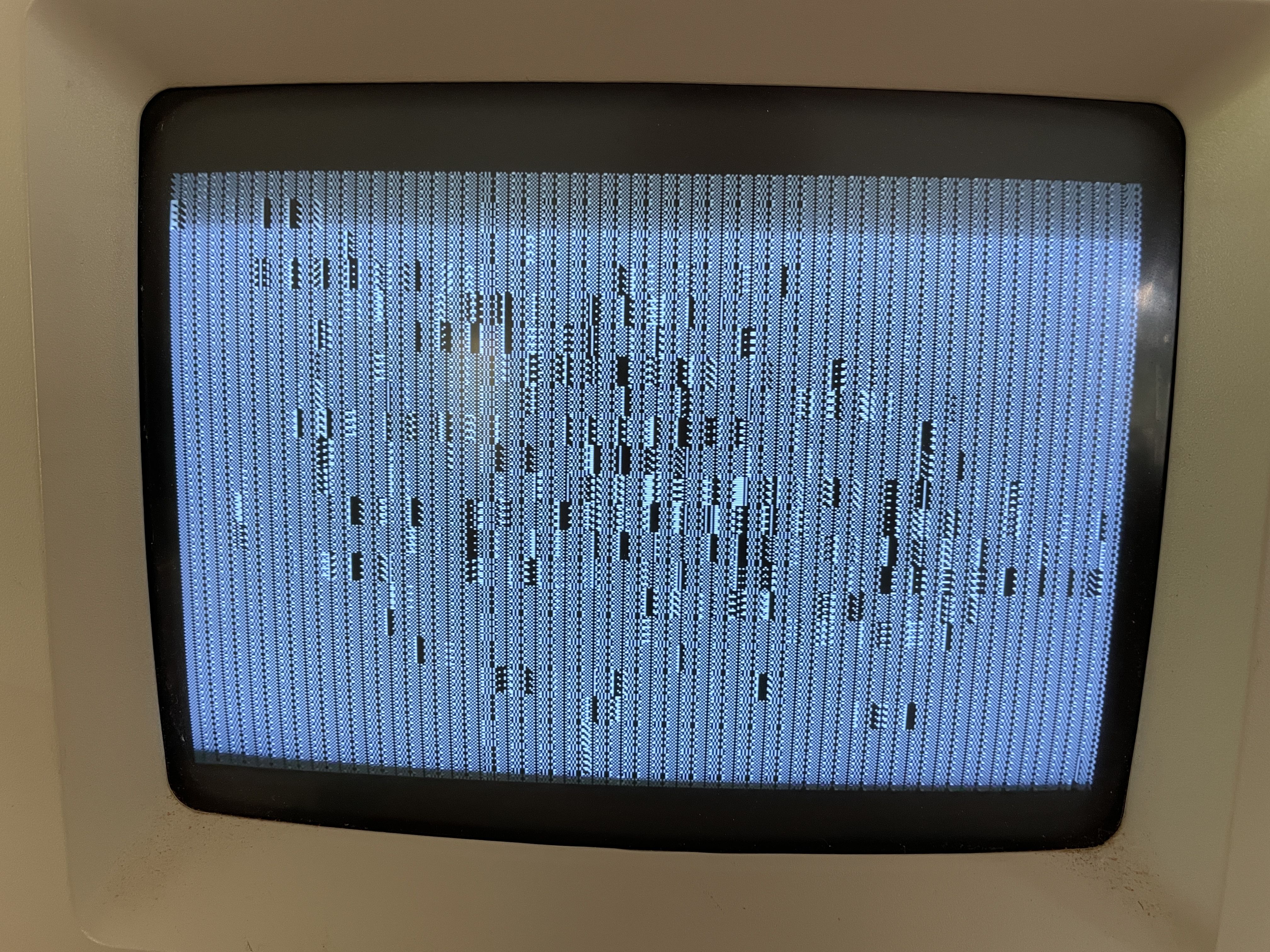

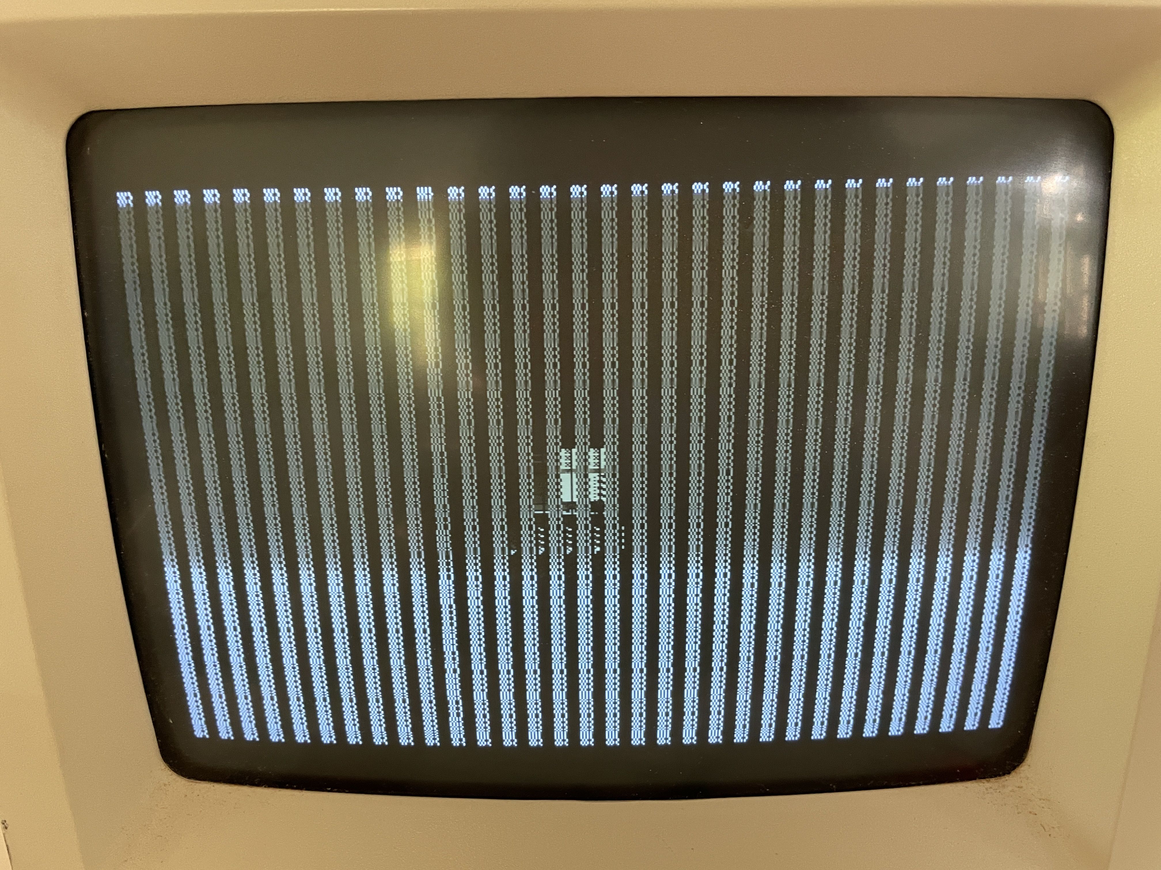

Major issue 1: scrambled video​
Let’s start with the bad, the board that had the worst corrosion is also the now working board. There is very scrambled video and I can just about make out the mouse moving through the mess. Only once when I pressed interrupt button, there was a pattern of vertical lines that was (slightly more) ordered.
It is no coincidence that this is the board with the most corrosion, I‘ll need to go over all traces. Any thoughts on this would be great.

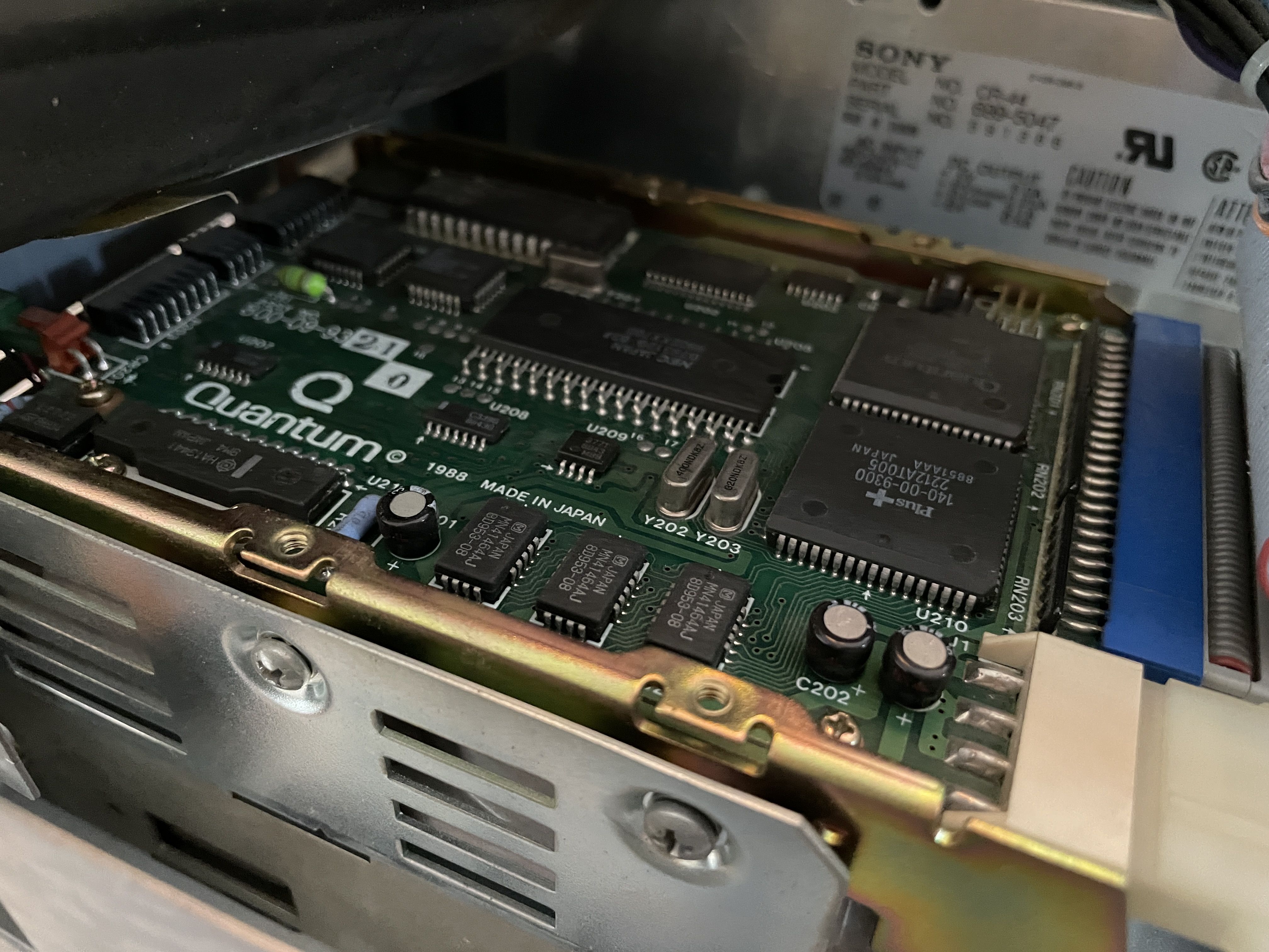

Minor issue 3: one of three SCSI drives doesn’t boot​
There is one Quantum drive that doesn’t boot, it also look different from the other two. I can hear it spinnig, but other than that there is no noise. It appears as if the top plate was removed, but this could also be design?

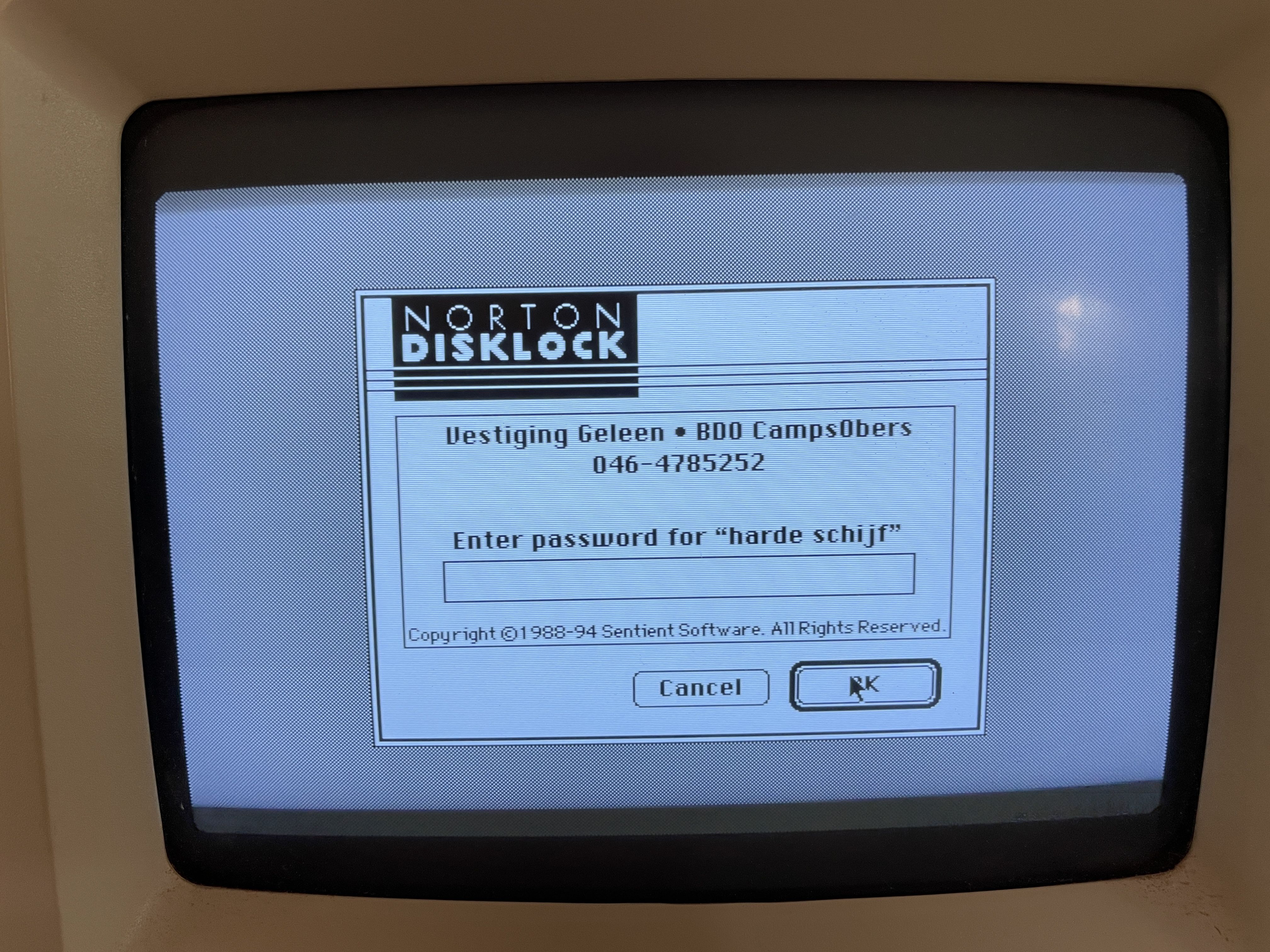

Minor issue 4: drives are locked with Norton DiskLock​
Not really an issue, but I was hoping to find some nice software or get a sense what these machines were used for. Can this by bypassed/cracked somehow?

Thanks! However, I already recapped and cleaned the logic boards. The issues described were cross verified on different analog boards. Still, I’ll take your suggestions for creating a rock solid base.
I’m really hoping to receive specific pointers to investigate issues 1 & 2. Maybe these behaviors are familiar to anyone?
