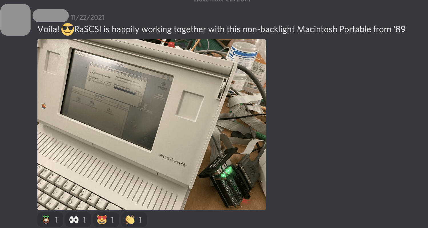

About the rascsi, has anyone tried it on a Mac Portable? I currently use a SCSI2SD card and it works fairly OK, but waking up from sleep is always crashing the system.
Anyhow, I’m more interested in the networking feature, I’m considering investigating fitting everything inside the Portable case for the ultimate integrated storage plus networking solution.
Thanks in advance for any suggestions!
landogriffin
42
Iowa
piscsi.org
At least one user on Discord has reported success!! 😃
