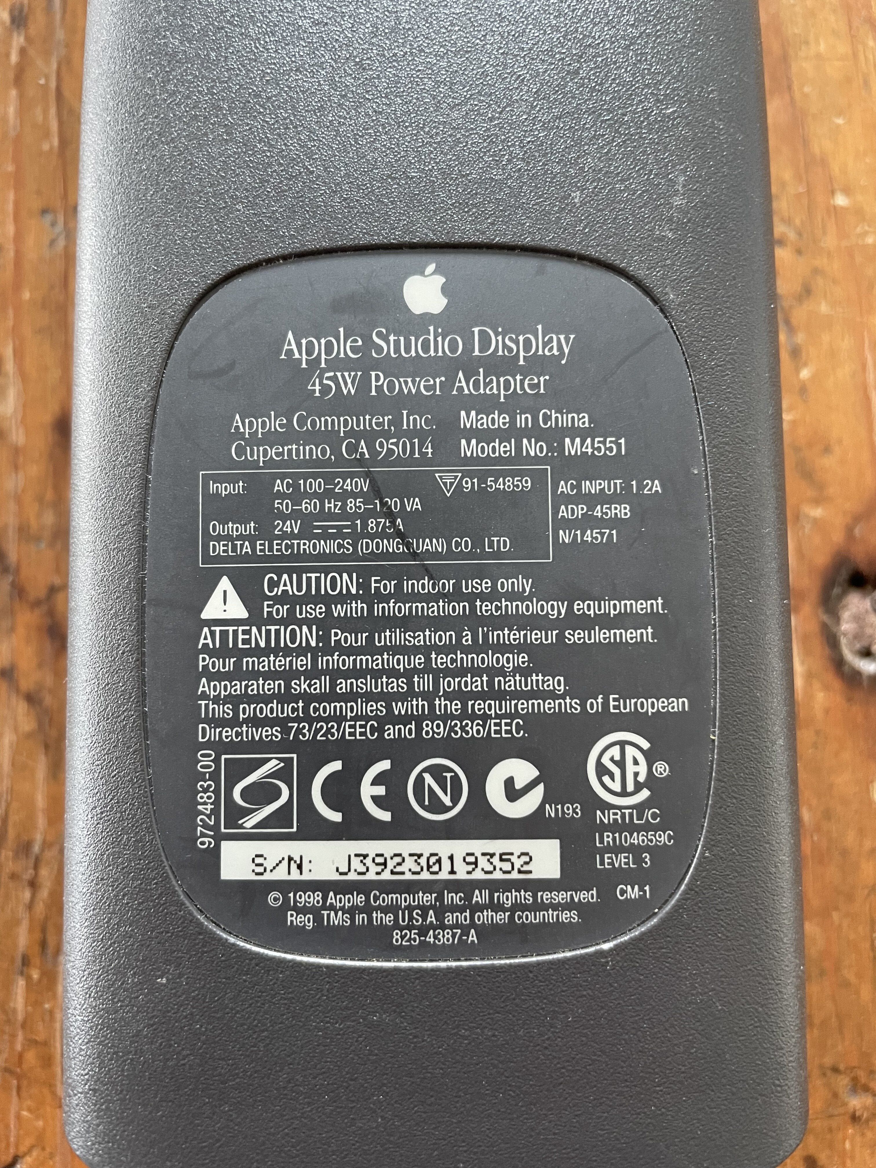

A friend of mine saved this Apple 15 inch (Blueberry) display from the recycler and asked if I wanted it. Of course like any sane person I said YES lol
Unfortunately this one didn't come with a power supply so I have no way to power it up for testing. I was wondering if one of you kind folks might have the specification for the power adapter so I can find a replacement and/or if anyone knows of a good replacement I can order it would be much appreciated!
Edit: Took some searching but it Seems like it takes 45W 24V 1.875amp but I can't find if it's center positive or center negative. Anyone here know?

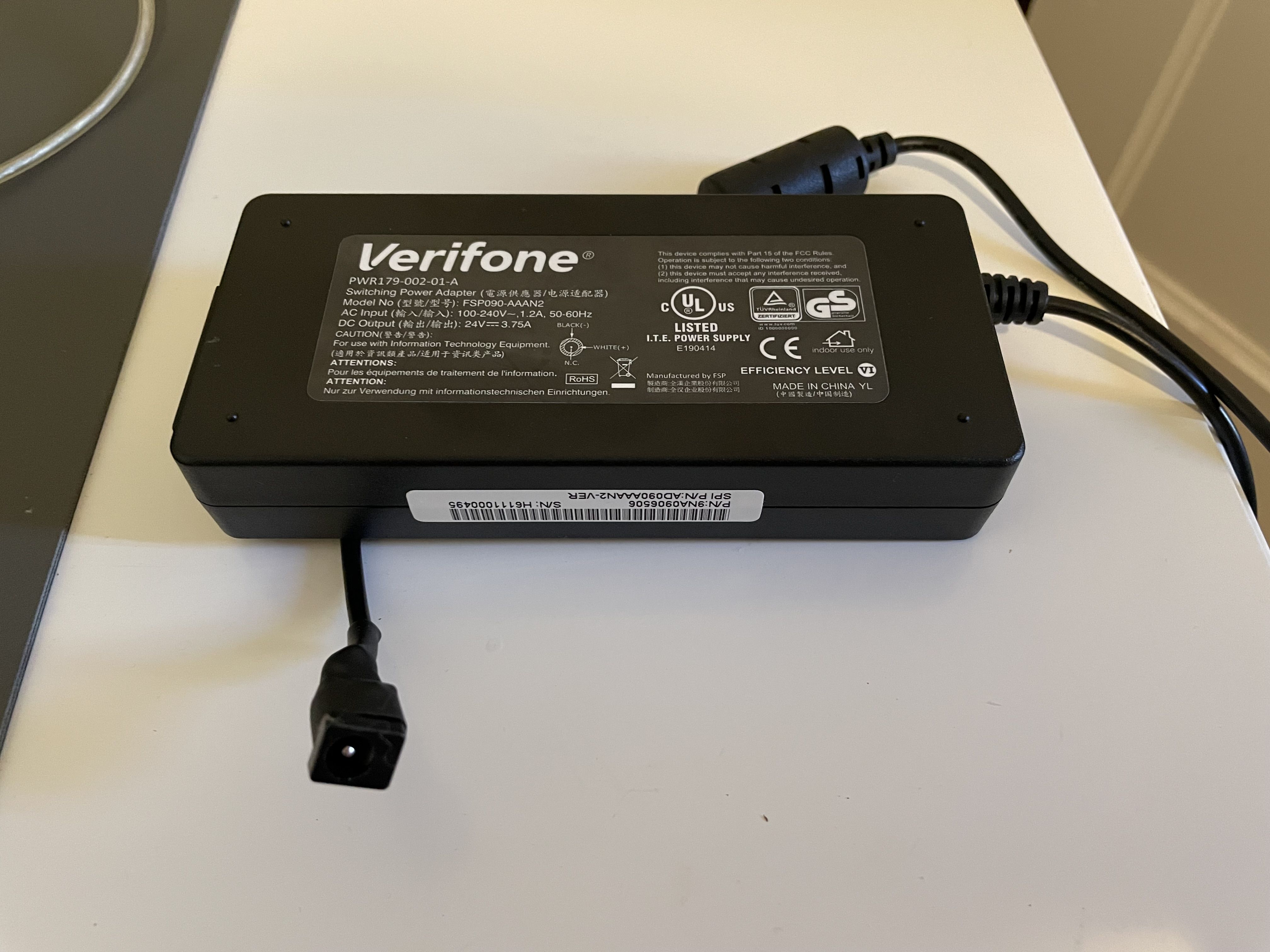

Years ago I made one out of a cheap old Verifone power adapter I found on eBay and fitted it with a female barrel connector to fit the studio display's cable. A pretty easy and cheap replacement versus trying to find an original adapter. It worked out great.
