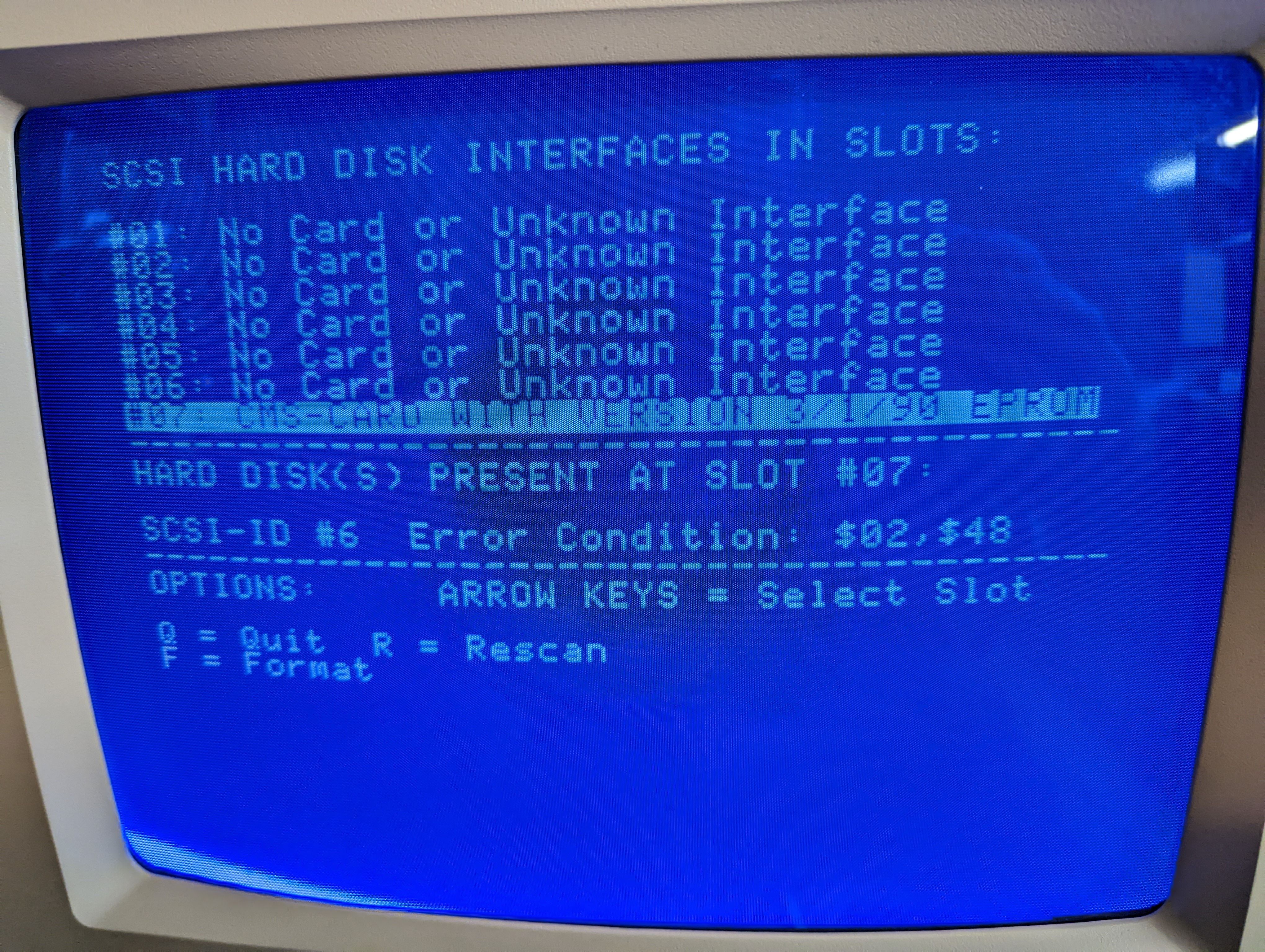

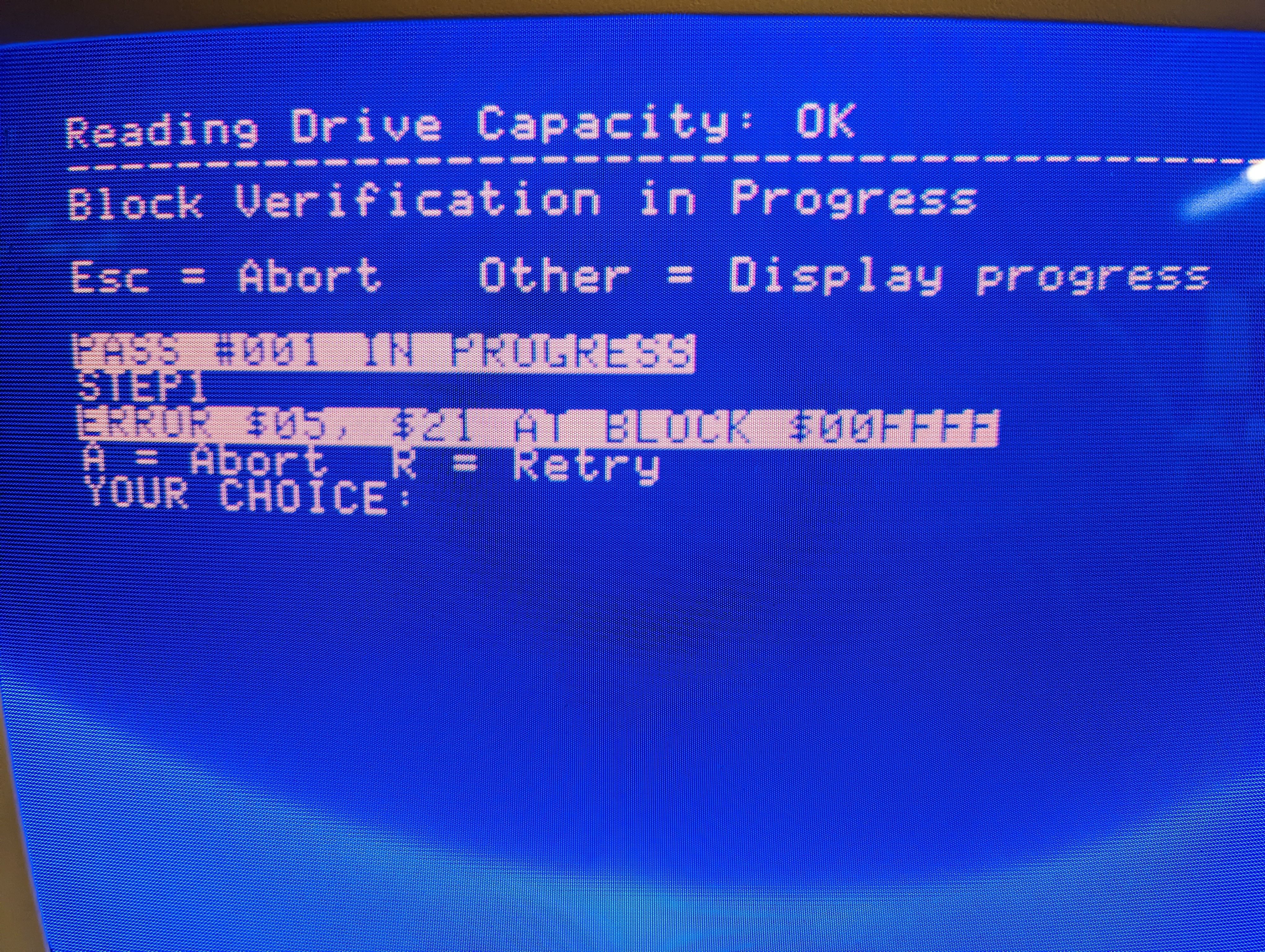

So I've been trying to get this card working with an external DB25 BlueSCSI in my IIgs and I'm stuck. Keep in mind, I've never used SCSI on an Apple II before. I found the manual for the card here:
All of the card's jumpers are in their default positions as-pictured in my first post. I created a blank 32MB hda file, named it "HD60_512 HD1.hda", and copied it to a freshly-formatted exFAT SD card. I put it in the BlueSCSI (which I've used successfully with multiple macs), plugged the BlueSCSI into the card, powered the BlueSCSI via USB since the card wasn't supplying enough power, and booted into the SCSI utility on the card's included floppy. The utility sees the "drive" at SCSI ID 6:
but it always shows those error codes and I'm not sure what they mean. The manual has an incomplete list of "Sense Key Errors" on the last page that describes $02 as "Not Ready - The SCSI device is not ready for access (slow device or removed media)"...don't know if that's what it's trying to tell me. Attempting to format the "drive" appears to succeed, but the optional post-format verification check immediately fails with this:
Attempting to use FILER to initialize/partition the drive after formatting as the manual describes fails as FILER doesn't seem to see the drive.
I've tried multiple SD cards, the BlueSCSI's log files always appear good...any ideas or suggestions?

Put of curiosity have you tried Eric's apple II bluescsi image? Or another compatible image?
KennyPowers
Jun 27, 2022
246
289
Ya, Eric suggested I make a 32MB ProDOS image with CiderPress...tried that and no change.
