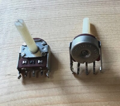

Here’s the power supply. There’s no need to test it, because someone already did it for me! 😂
I’ve installed it into the Lisa. Unfortunately, one of the knobs is broken on this one. Anyone know a source for these pots?
