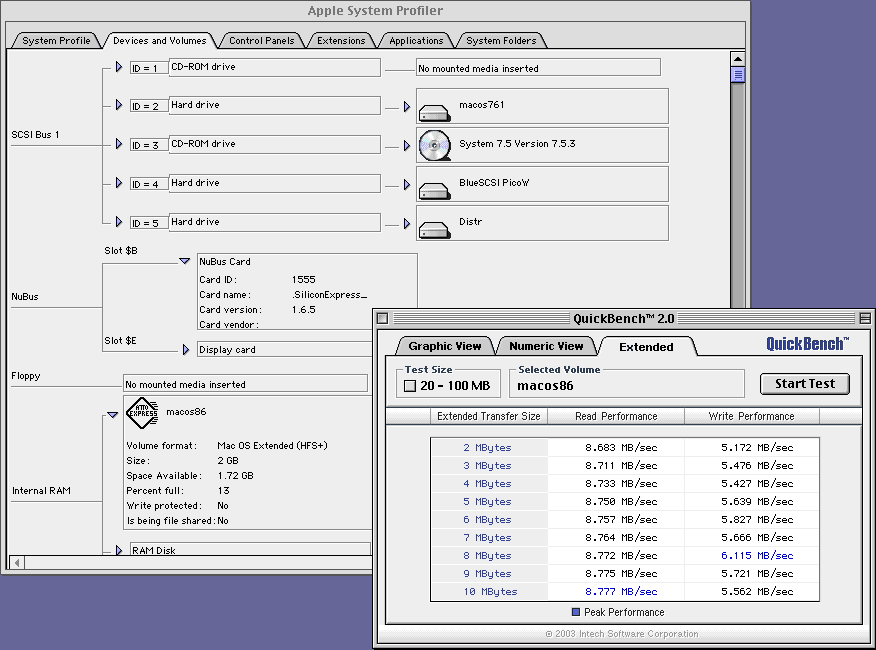

I did a disk subsystem speed test with QuickBench, and for some reason it works faster when the cache card is not installed.
What it looks like.
For the sake of a joke, I'm connecting an old 500 GB disk. And it works. However, I didn't format it, with an 80 Mhz processor... it's for a long time.

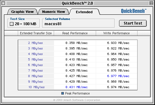

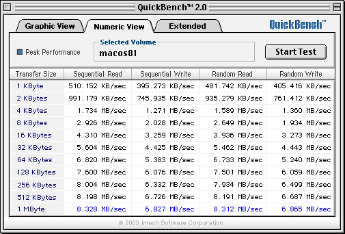

@lobust Yesterday I continued my experiments, and connected to SEIV BlueSCSIv2 through 50-pin, the reading speed was higher than when connecting an SSD through 68-pin and 2 adapters.
In this case, the cache card did not affect the performance of the disk system.

I checked the SCSI 68-pin adapter -> IDE -> SATA -> SSD on MMD with PCI-X Adaptec-29160-MAC installed - the disk read speed was 89 MB/s. o_O

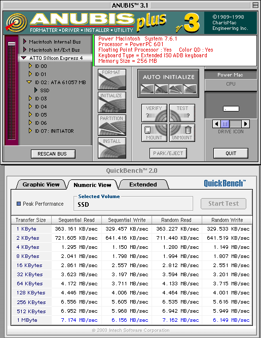

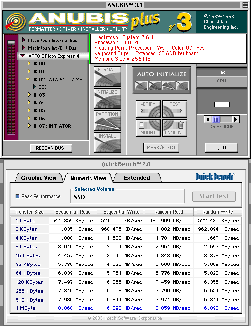

Finally, it's time when I can share the results of this card on the Macintosh Quadra 950.
Disk subsystem performance when using the stock processor 68040 33 Mhz
Disk subsystem performance when using the Apple PPC Upgrade card 66 Mhz
On average, SEIV increases the performance of the disk subsystem by ~1.5 times, which in my opinion is a good result. But I'm surprised! I was sure that PPC would add performance, but we have what we have.
