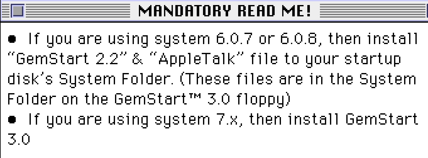

Separately from that, I see a README file...
It says...

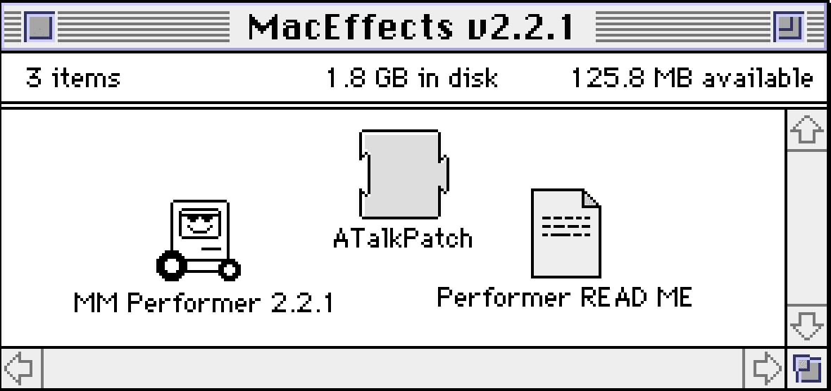

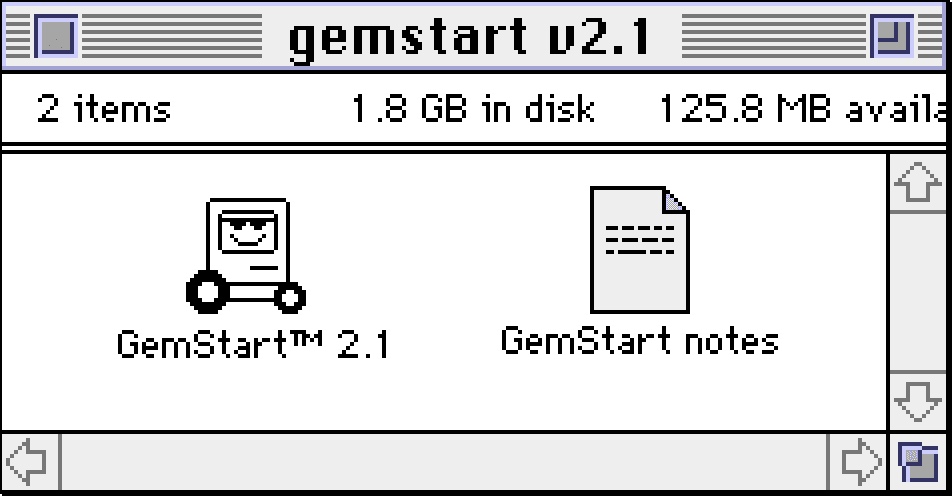

Interestingly, your recommended Macintosh Garden download contains v.2.1 (within "gemstart.sit"), not the recommended (above) v.2.2:
The MacEffects Performer product page links to a download containing these files (note v.2.2.1), but none of which have GemStart in the name:
So if the "GemStart" Control Panel (CP) is something very different from the "MM Performer" CP, then someone needs to find GemStart v.2.2 for the sake of using it in System 6. :)

There is no XTAL socket. I soldered the XTAL's 4 pins directly to the PCB pads.
It says...
2.1 will work. But if you really want 2.2 I have it on floppy disk somewhere, and I think I've uploaded it somewhere... I'll have a quick look (then I should get some sleep - I've spent the last couple of days migrating my website to a new host and am sick of DNS, WordPress and email server stuff).

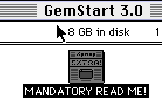

NOTE: All tests below were done with 33MHz Crystal (FPU only) installed in MacEffects Performer-SE.​
GemStart 3.0 Control Panel Info​
JDW's Speedometer 3.23 Results with GemStart 3.0 (System 7.1)​

NOTE: GemStart 3.0 is DL#14, and make sure you use version 3.0 in System 7.1: https://macintoshgarden.org/apps/accelerator-card-drivers
