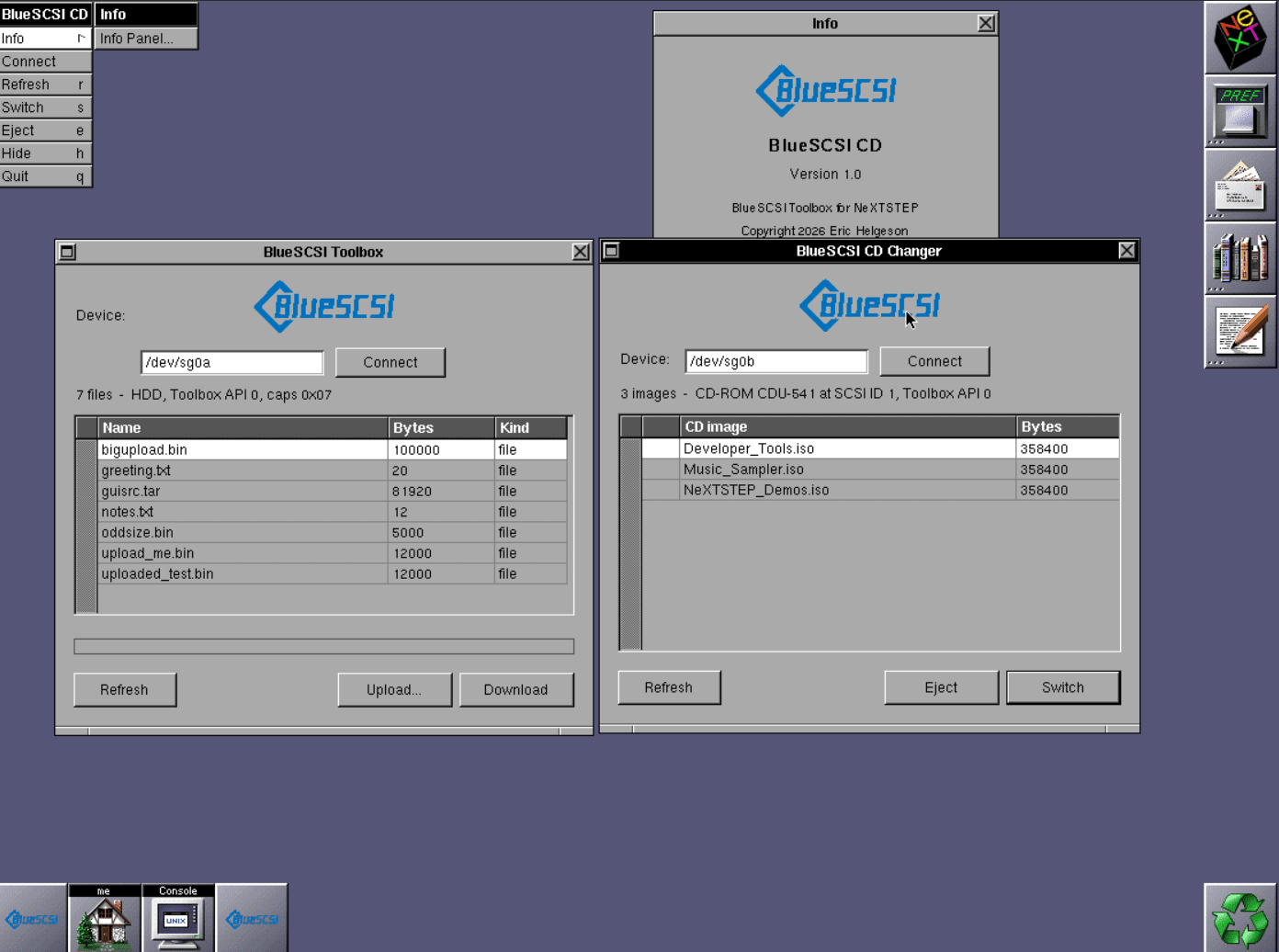

I have it on my TODO's for far too long, spent some time tonight and got almost everything done for a cli
Code:
# hostinfo
Mach kernel version:
NeXT Mach 4.2: Tue Jan 26 11:23:59 PST 1999; root(rcbuilder):Objects/mk-183.34.4.obj~2/RELEASE_M68K
Kernel configured for a single processor only.
1 processor is physically available.
Processor type: MC680x0 (68040)
Processor speed: 33 MHz
Processor active: 0
System type: 5
Board revision: 0xf
Primary memory available: 128.00 megabytes.
Default processor set: 41 tasks, 74 threads, 1 processors
Load average: 0.00, Mach factor: 0.99
# ./bluescsi --list-files /dev/sg0a
greeting.txt 20 bytes
notes.txt 12 bytes
So for sure a CLI very soon, and maybe I can resurrect the GUI work i did a while ago.

Have a FAT build for 68k,x86,SPARC that works on 4.2 - I'm going to guess 3.3 will need a lot different GUI/WM calls.... Obviously some cleanup to do but a lot of progress today.

Wow, was not expecting that level of polish!
I don't know your comfort level with sharing the source code, but i'd be glad to try and help with the back-port to earlier NextStep versions.
