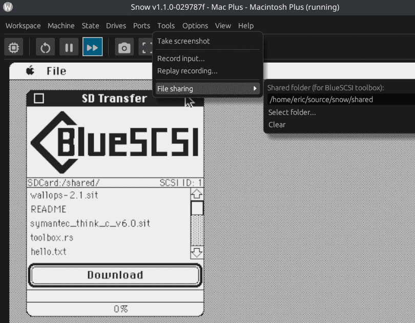

Updated to 1.0.2 - Few bug fixes.
Notable new feature that required no code changes is the SD Transfer app now works in the Snow emulator's bleeding edge build! I actually prepared the 1.0.2 release inside of Snow.

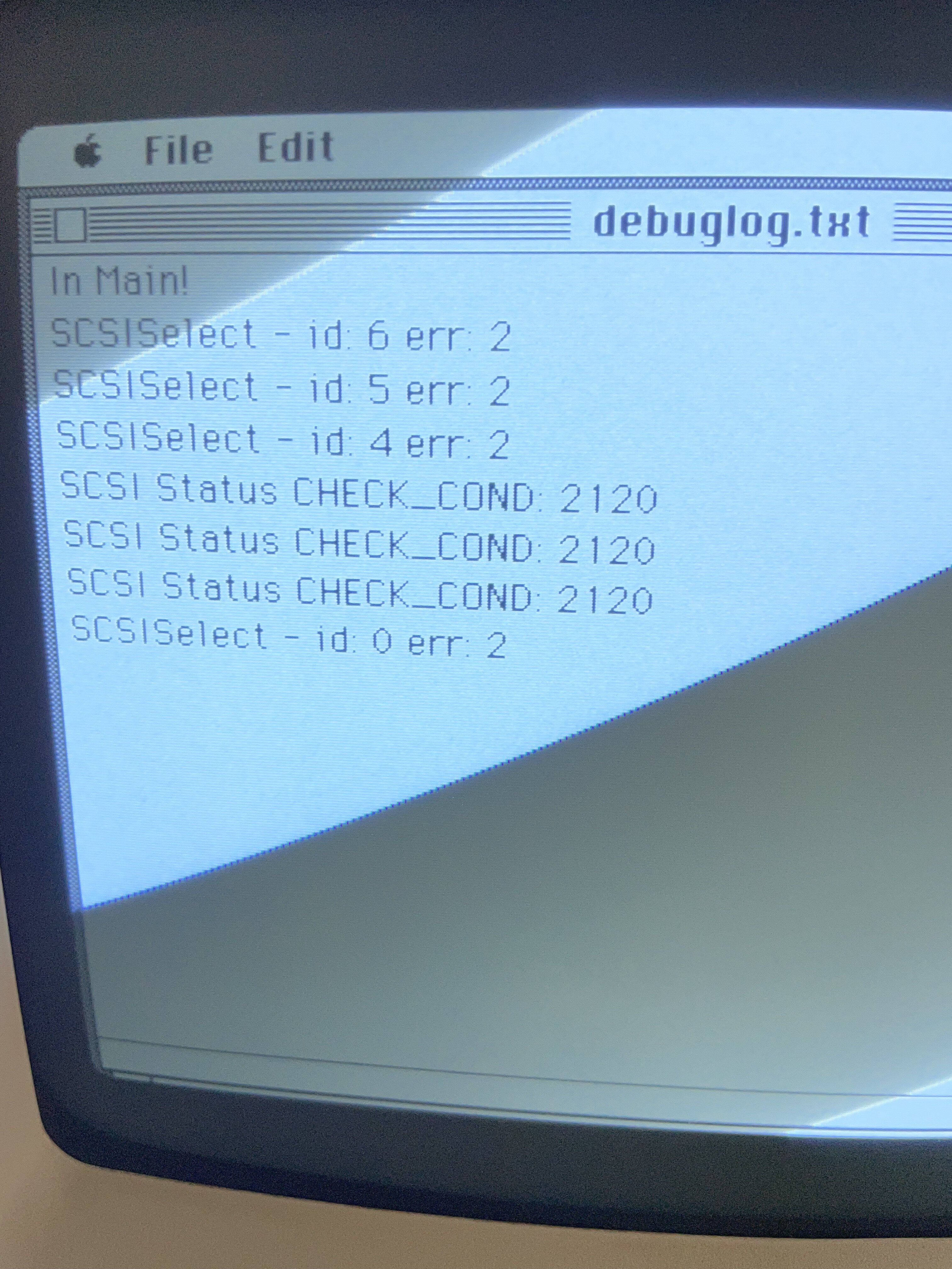

Trying to use the Bluescsi toolbox for the first time. I have a V2 external with the latest version of the firmware and toolbox and am running MacOS 7.1 on a Mac SE. I have a folder on root of the SD card called named shared where I have several files. When I launch the transfer app I get a ‘No compatable BlueSCSI’s found’ error. CD switcher app works fine. Any ideas what I might be doing wrong?
