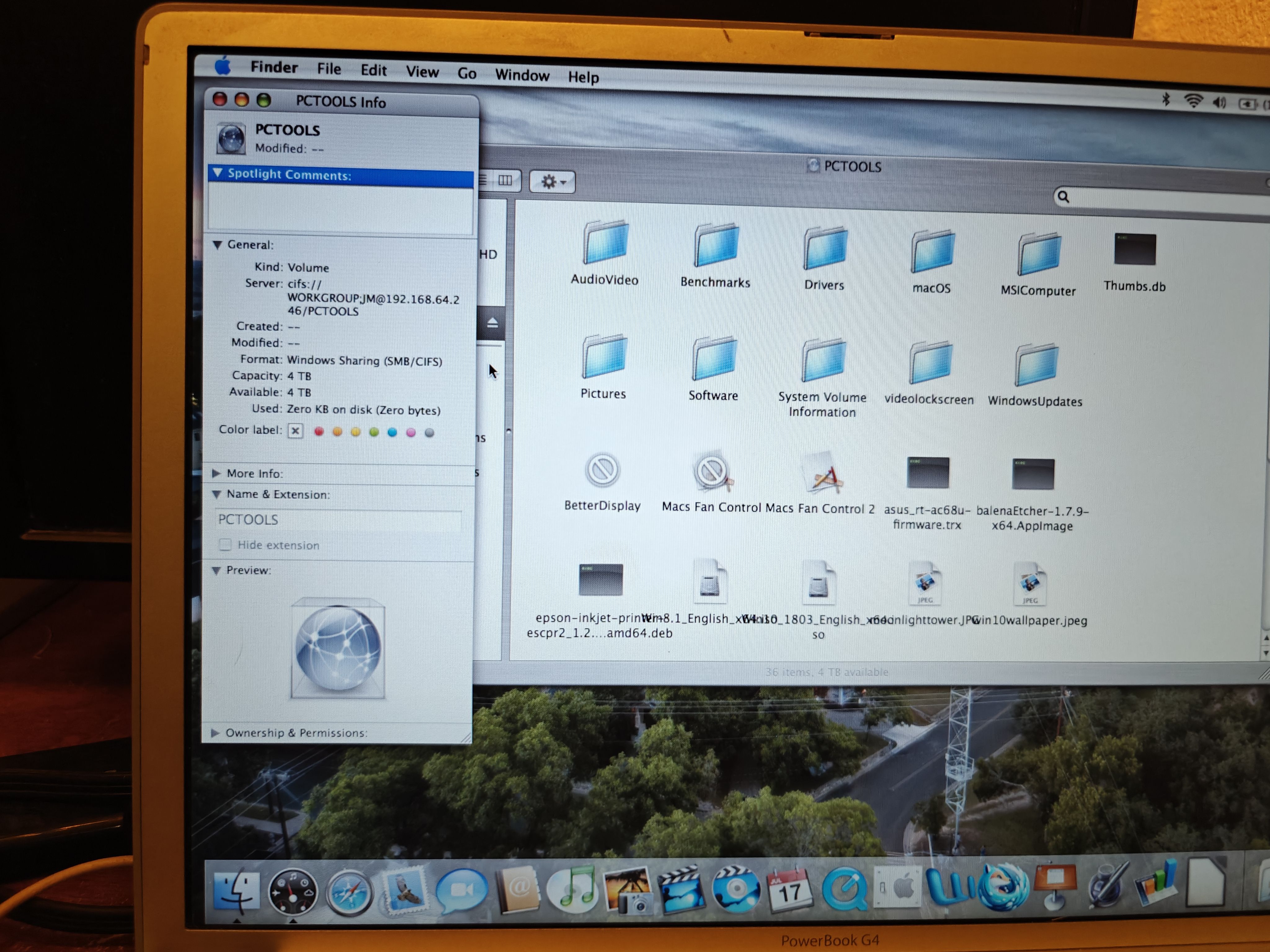

Maybe Mac OS doesn't like something about the size of the share? I noticed on Tiger (the only version that half-works) it only shows 4TB, even though I have 14TB in the NAS:
888
636
Tiger only supports up to 2.2T so while it might see a larger drive, it’s going to have problems accessing it. I have a 2T share for my old PPC macs and they see & connect to it without issue.

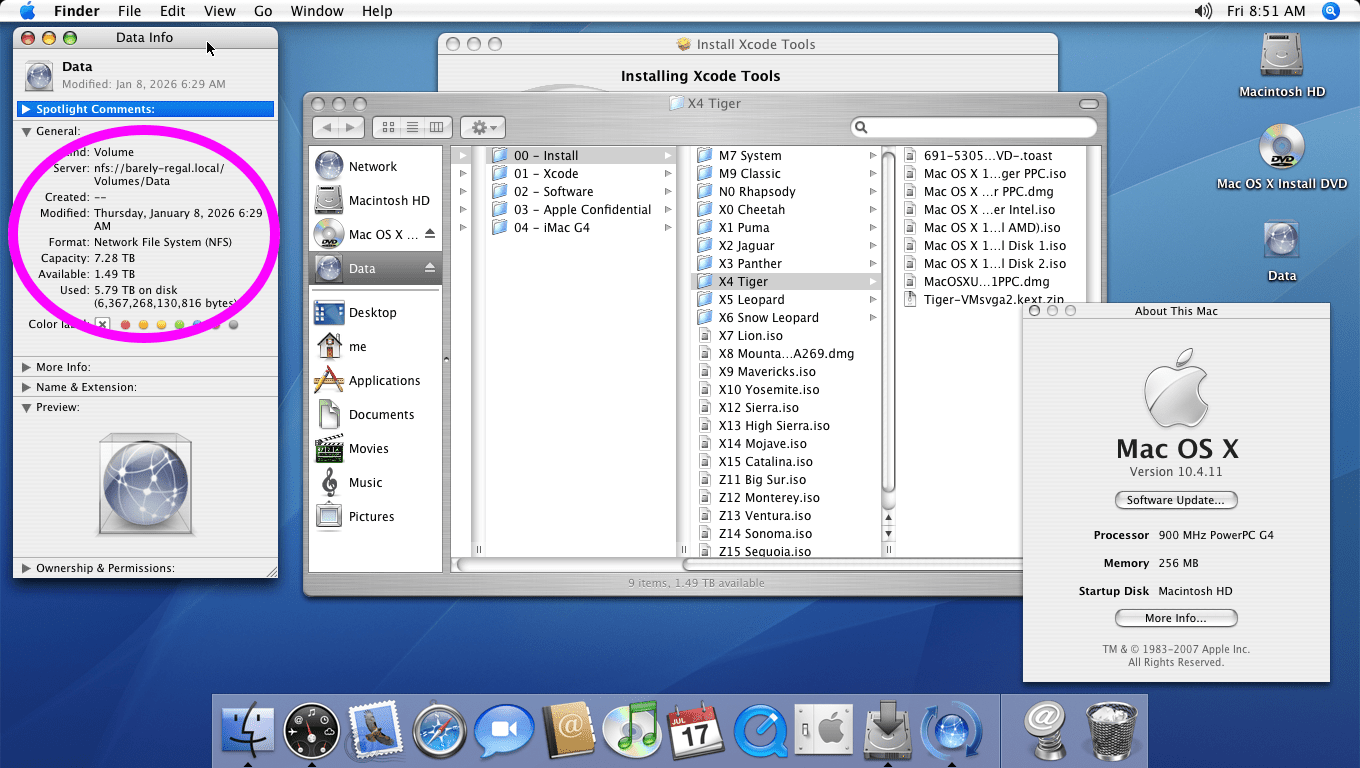

From the old OS, you connect by using connect to server and then typing: nfs://my-server.local/Path/To/Mount
I will provide the exports file from a modern Mac that allows these old systems to connect (but sorry I do not know how this is translated into truenas)
Also see attached screenshot that shows Tiger can easily see a network volume that is 8TB
Code:
me@Barely-Regal ~ % cat /etc/exports
/Users/me/Developer -mapall=me:staff -network 192.168.0.0 -mask 255.255.255.0
/Volumes/Data -mapall=me:staff -network 192.168.0.0 -mask 255.255.255.0
