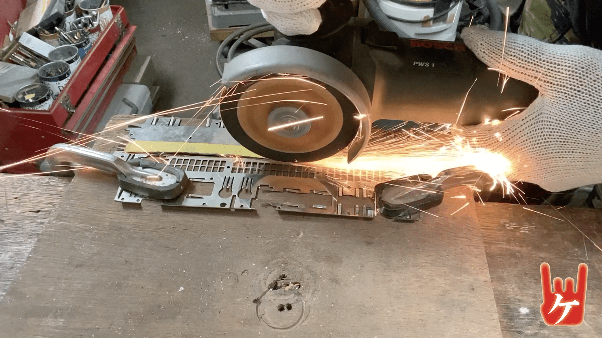

My next video, due out this week, is about recapping with OS-CON capacitors. I will then release a short video very soon after that, mostly filmed by @Kay K.M.Mods. It highlights some amazing work that Kay did on the back panel -- a custom, hand-crafted work of art! Stay tuned! :)
Nice, Mystic boards are definitely worthy of polymer caps! Looks like some fun fabrication going on with that panel as well.

I love how in the span of 3 posts it goes from opposing modifications to literal sparking cutting wheel. 😅
That is of course a modification of the back panel taken from my now defunct LC575 carcass. No such slicing and dicing is being done on the precious Color Classic! The LC575 was purchased primarily for its motherboard, but it just so happens to be useful for other parts too! Anyway, I think you'll enjoy the full video.
And with how many cracks and chips were in that LC575 case to begin with, I wouldn't feel bad about hacking it up. I've still yet to see one in person that didn't have at least one of those top corners chipped (where the faceplate meets the rest of the case).
