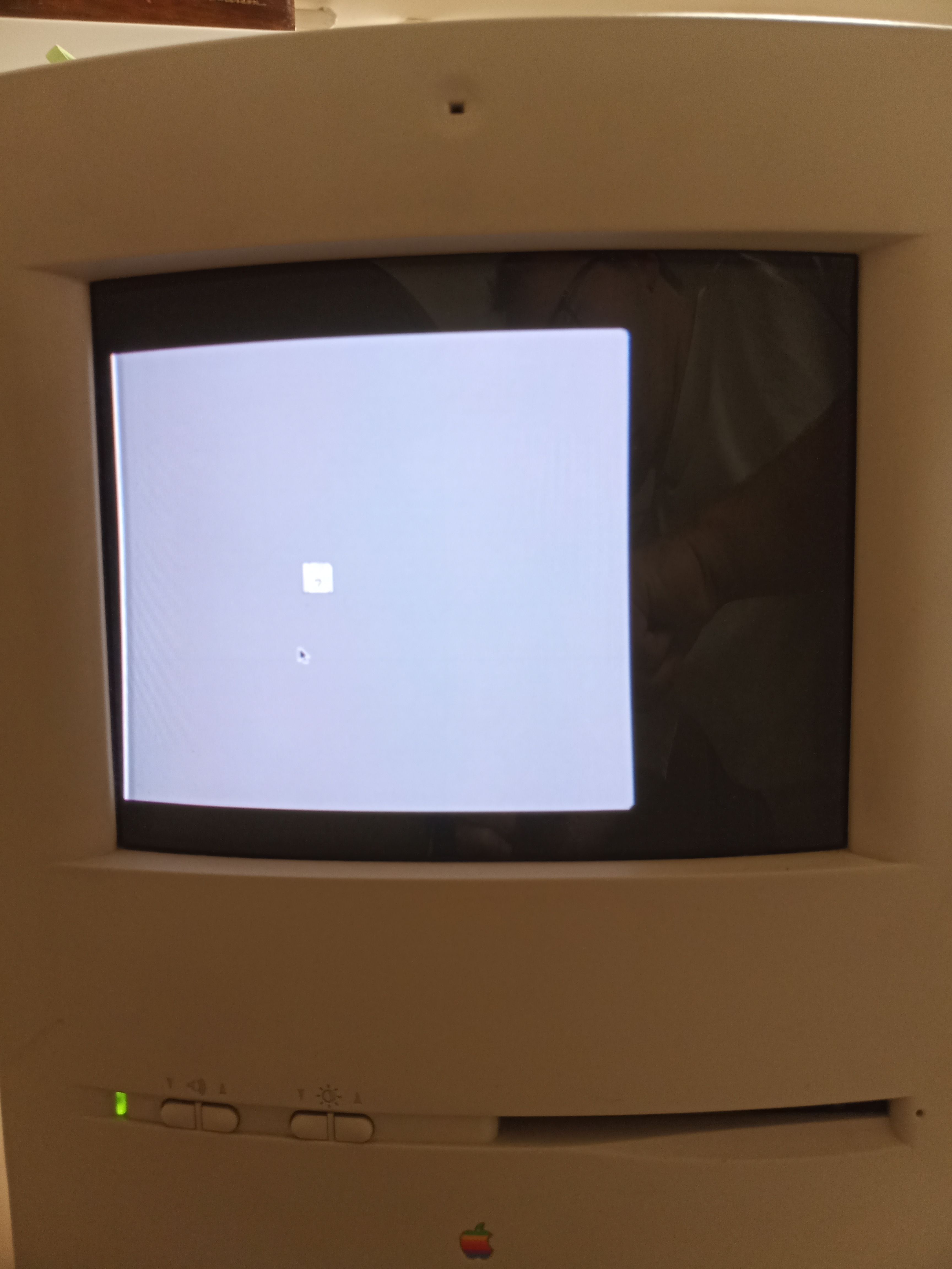

Hi Everyone, I recently attempted the 84v mod including the "beefy" upgrade as outlined by @JDW in his excellent youtube tutorials (thank you so much!). I also recapped a good portion of the analog board (the logic board was done by the previous owner). My CC was running flawlessly before my tinkering; it still boots fine, but I'm experiencing some major wonk on the display:

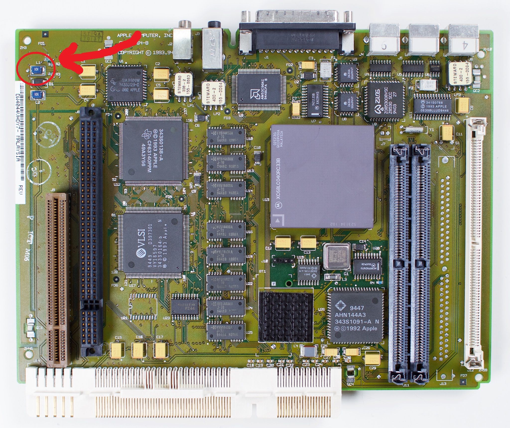

I am also looking for some advice on a small component that's detached on an LC 575 board. It is labeled L1 and need a replacement recommendation if possible:
Hopefully I can get some direction from someone more knowledgeable than I, thanks in advance.

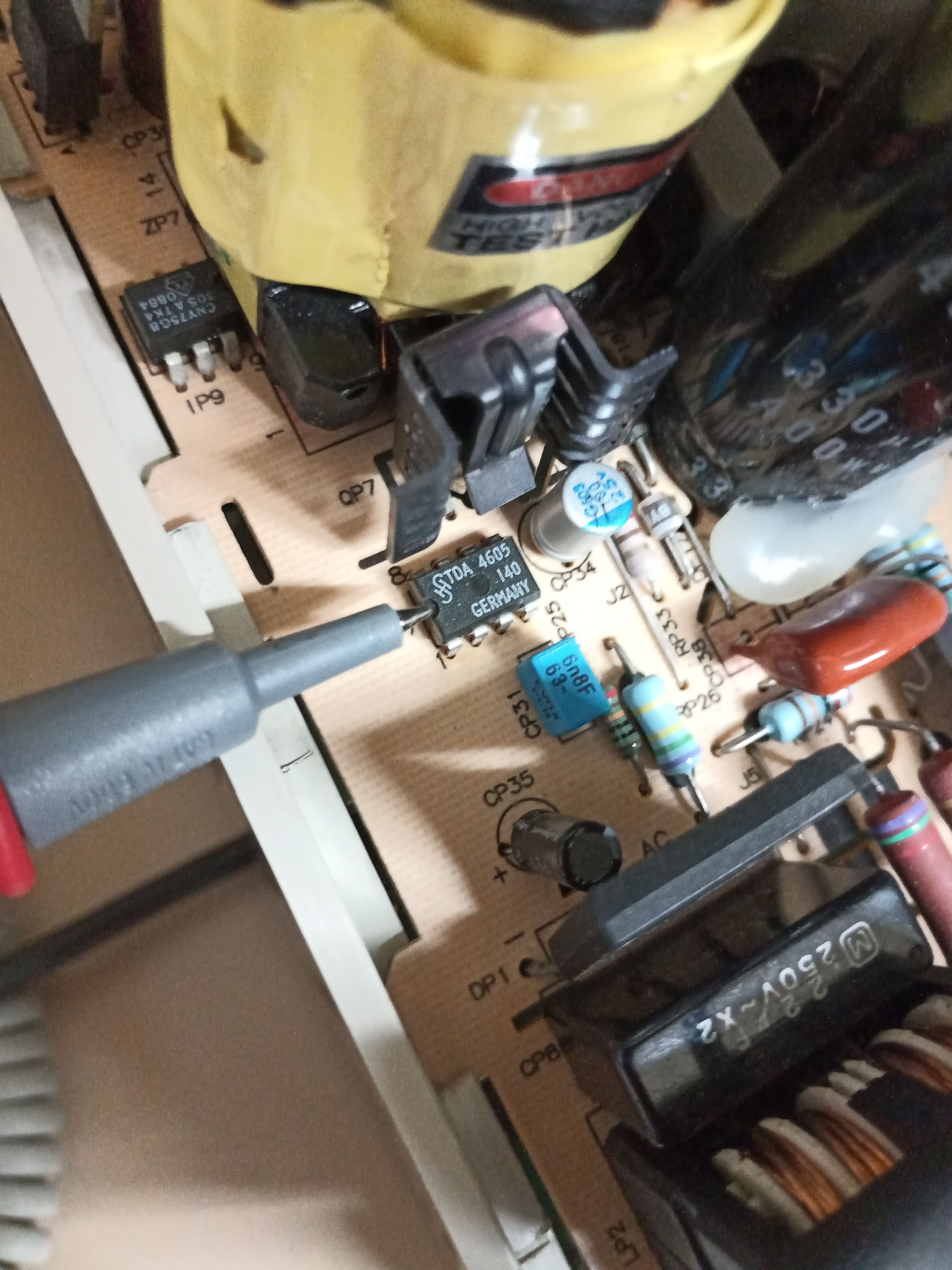

For IP7 pin 6 on my system, with hard-power on but soft-power off, I measure -55V relative to chassis ground and 0V relative to the bridge rectifier's (DP1) negative terminal. With soft-power on and the system booted, I measure about -32V relative to chassis ground and +10V relative to the bridge rectifier's negative terminal.

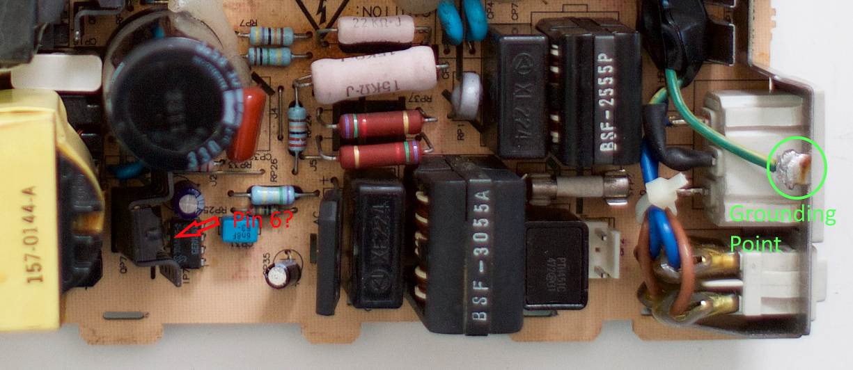

I measured pin six with my meter set to DCv & ground lead contacting the shroud surrounding the main supply plug socket. Attached a picture just to make sure I'm contacting the correct locations. Double checked and I'm receiving 53.8v still.
Yes basically what @jonschultz said, you are measuring the voltage regards to cold ground which is floating, you need to measure voltage across pin 6 and pin 4 on TDA4605.
Like I said, you need to verify whether QP11 turns off after receiving power on signal from logic board, and whether TDA4605 at IP7 receives power. If IP7 doesn't receive power at all you need to fix soft power circuit first.

I wasn't reading my meter correctly when I measured off of IP7 pin 6 and cold ground, it was in fact -53v, similar to @jonschultz reading.
When measuring between pin 4 & pin 6 I'm only reading 132mV, same if I measure off of DP1's negative terminal.
I suppose my next step will be replacing the previously discussed components and seeing if that improves the situation.

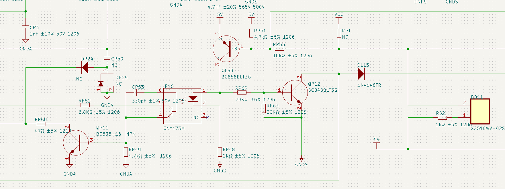

Did you short BD11 when taking these measurements? If so and voltage across pin 4/6 is still 0 then you found the problem. Soft power control for logic board psu isn't working, and you need to fix it first. Considering there are only 3 transistors and 1 optocoupler (CNY17-3) in the circuit iirc, should be fairly easy to troubleshoot.
You can also connect a scope to pin 2 of BD11 and look at the waveform. When you press power on button on keyboard, CUDA will pull this pin high, which turns off QP11 through the optocoupler and switch on logic board psu.

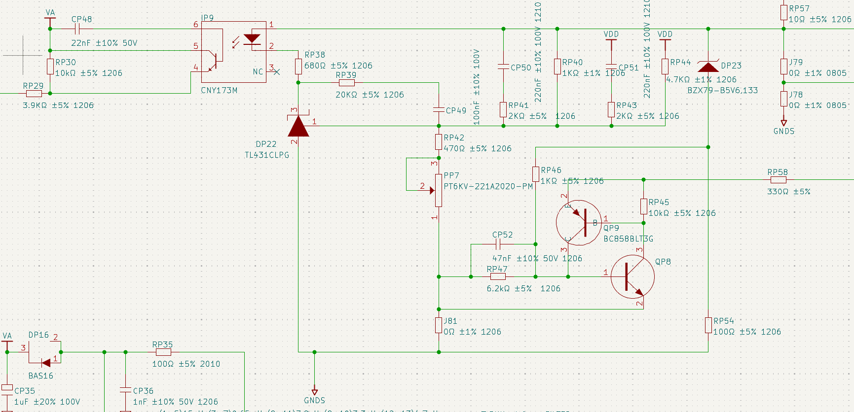

So like I said primary side should be ok, if you see around 10v across pin 4 and 6 on TDA4605 then it should try to start, and you should see the switching signal on mosfet's gate with an oscilloscope. You should also see DC voltage on secondary side as soon as the power supply starts, but seems like you are in the same situation as I did with my last CC, where TDA4605 enters protection mode immediately after start up.
First of all verify all DC output buses and make sure there's no short, also check schottky diodes on transformer outputs. If everything's ok then focus on the voltage feedback control circuit:
Note DP22 is a voltage reference ic, not a transistor, refer to its datasheet for more info, including test circuits. Also check the potentiometer at PP7, I've replaced a few of them which causes unstable voltage due to corrosion/oxidation.
