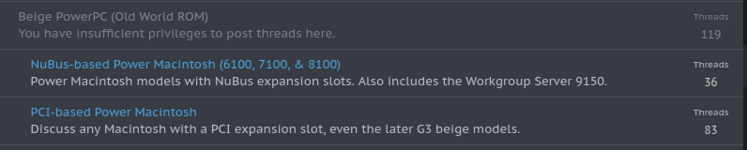

OK, I don't believe this should be under Nubus Macs, but there isn't a section that really matches the architecture of the 6200, 6300, 5200, 5300 family of machines.
