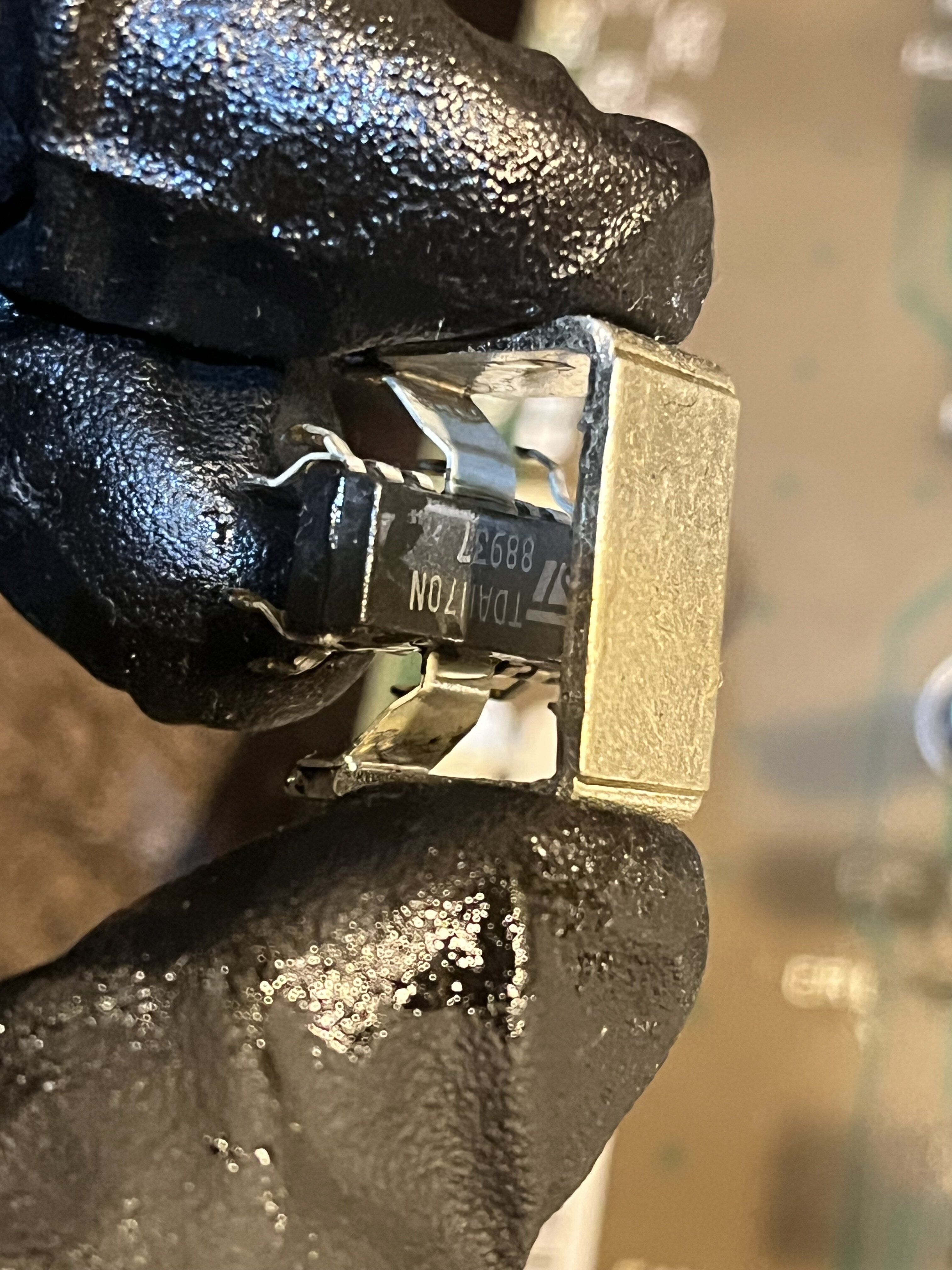

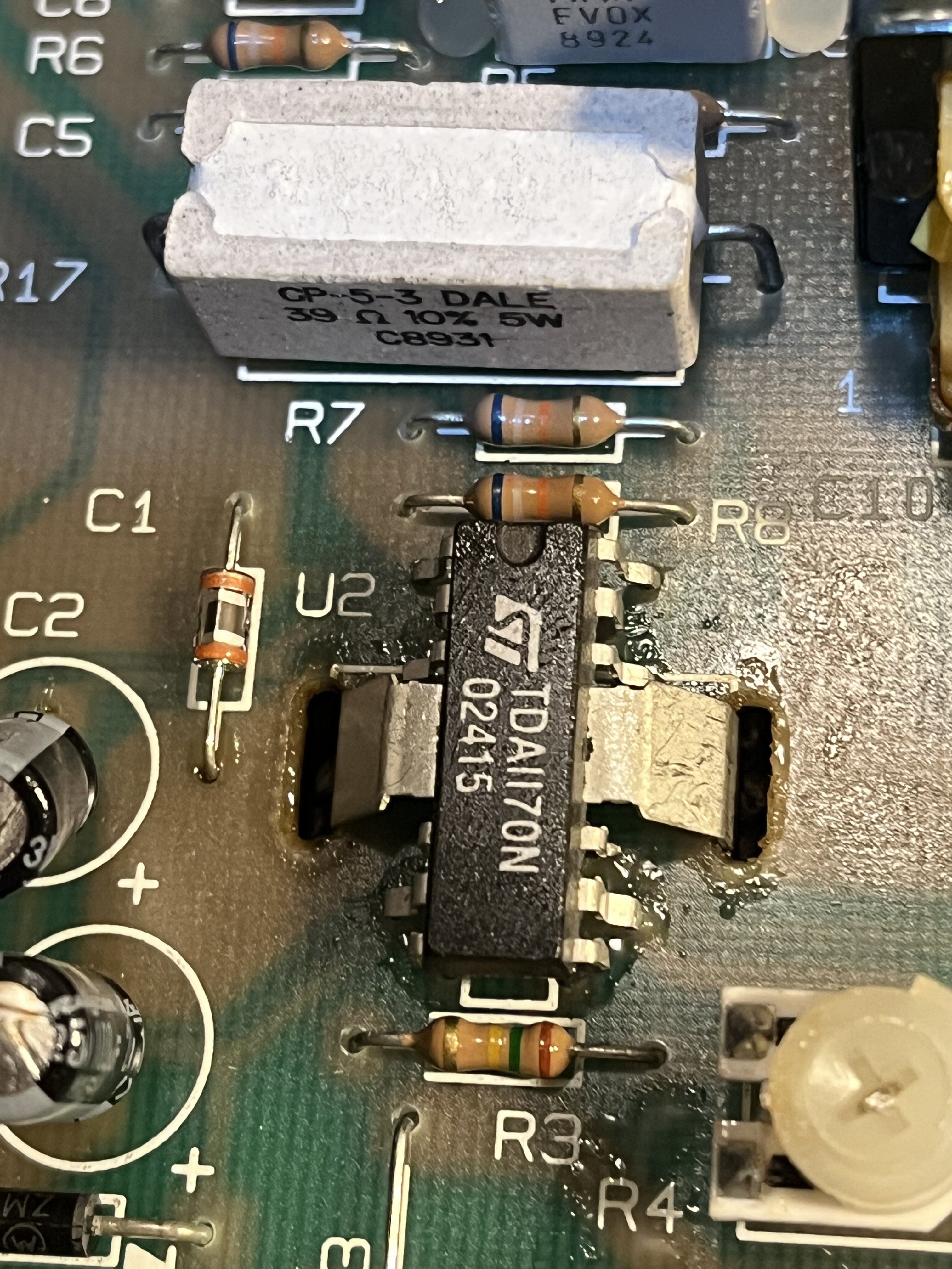

A tale of three analog boards:
Analog Board A was failing vertical raster. Flat horizontal line. Replaced the TDA1770N chip, reflowed the solder on the whole board. Still flat. Tried another board:
Analog Board B worked, but the geometry was off. I wasn't able to adjust the width coil with what I had, so I bought a universal CRT adjustment kit. The hex tool in the kit made it possible to adjust the width easily. But for some reason I'm getting no sound through the speaker with this board. Headphones are fine. I tried two different logic boards. Only swapping in the last analog board worked:
Analog Board Crecapped back in October, works, thank goodness. Sound + geometry.
I'll get back to figuring out A & B later. Any thoughts welcome.

I assume you are repairing the analog board of se30 right? Check -12v output of psu and on logic board. if there's no -12V you won't get any sound as the opamp used for audio amplification requires -12V.
For analog board A, trace Vsync signal with an oscilloscope, make sure it reaches TDA1770. Could be a dead NAND gate in U1. Also check +12v supply and surrounding circuit, there are only around 10 components in total iirc, should be easy to diagnose
