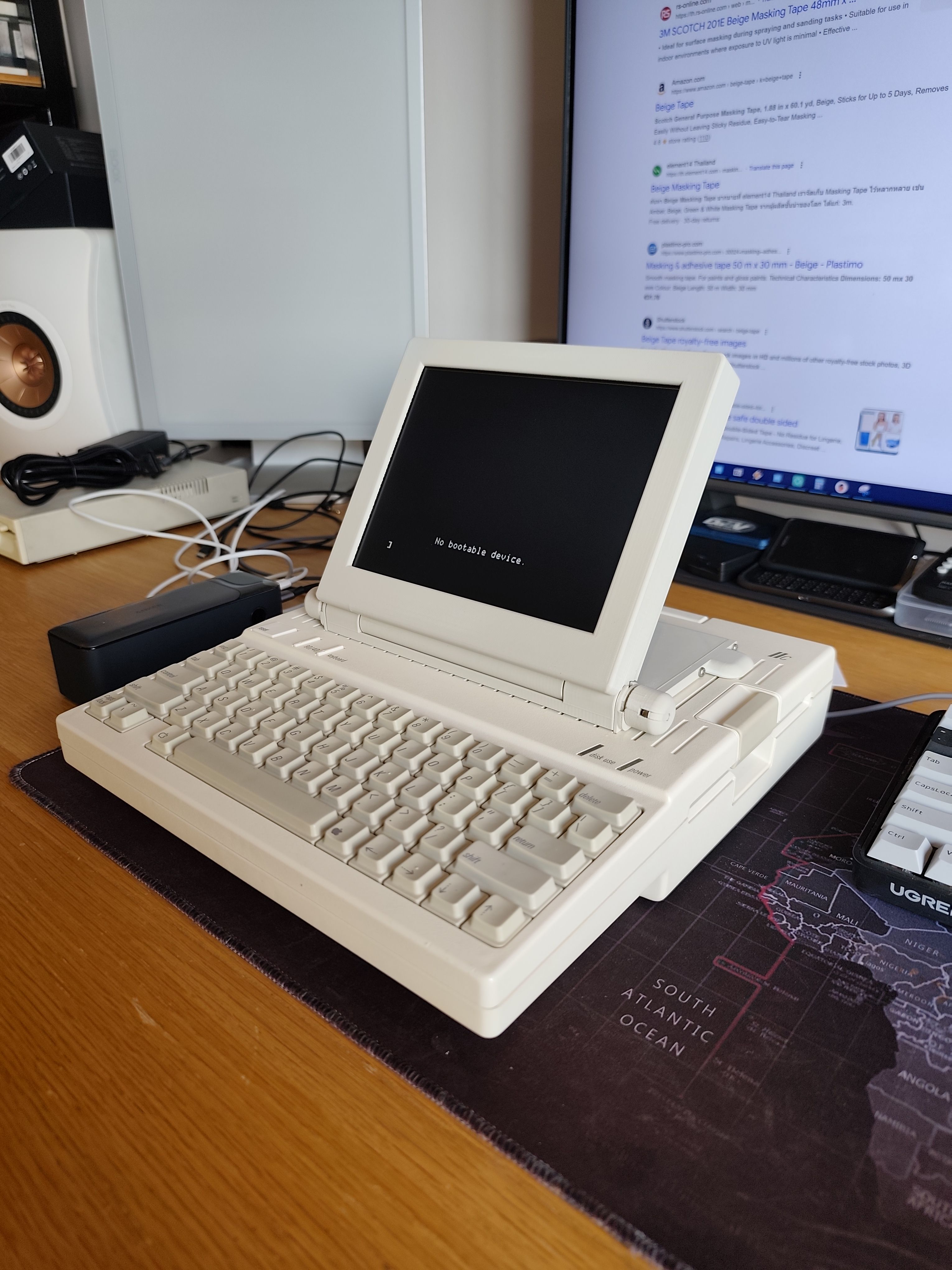

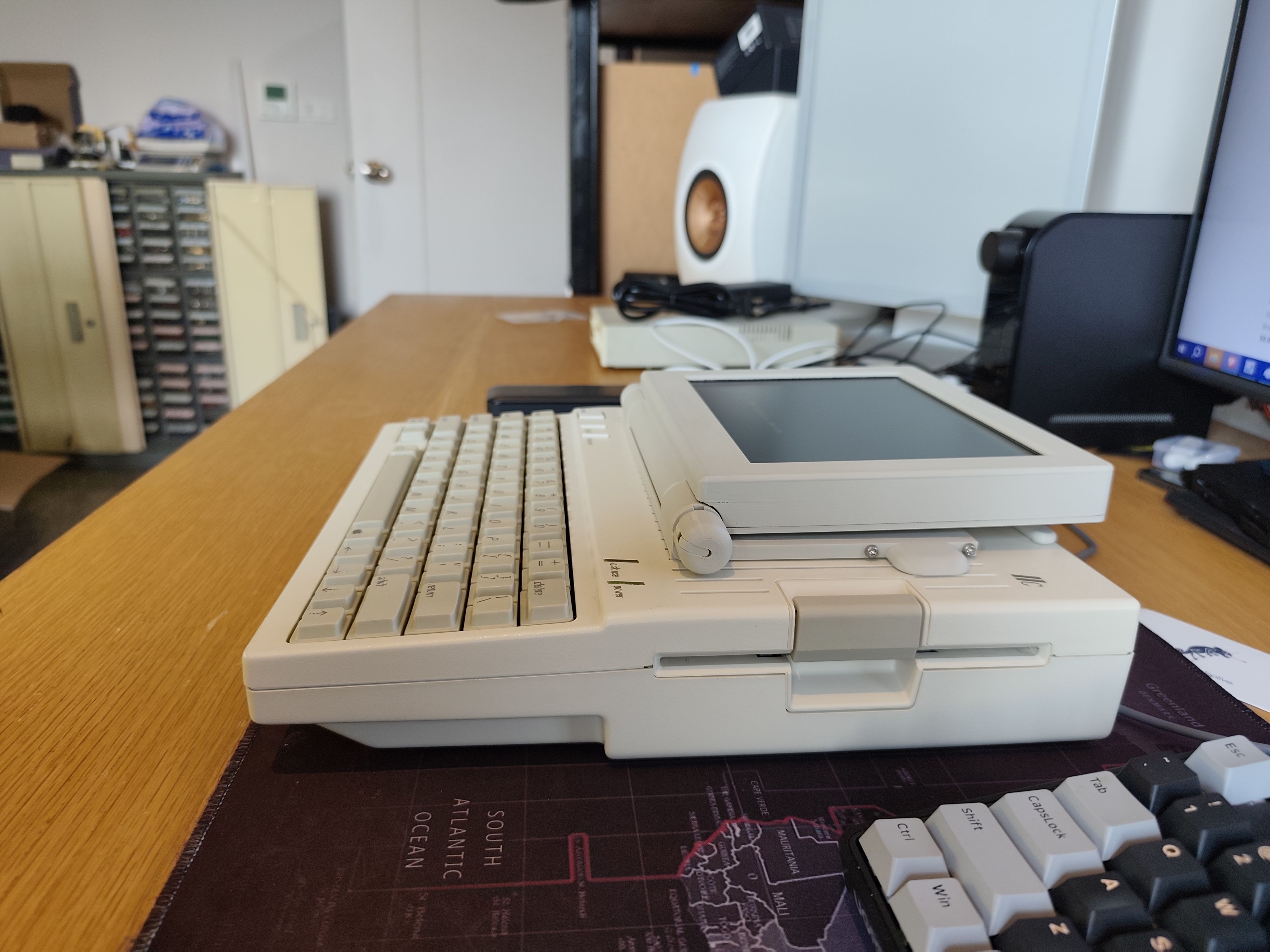

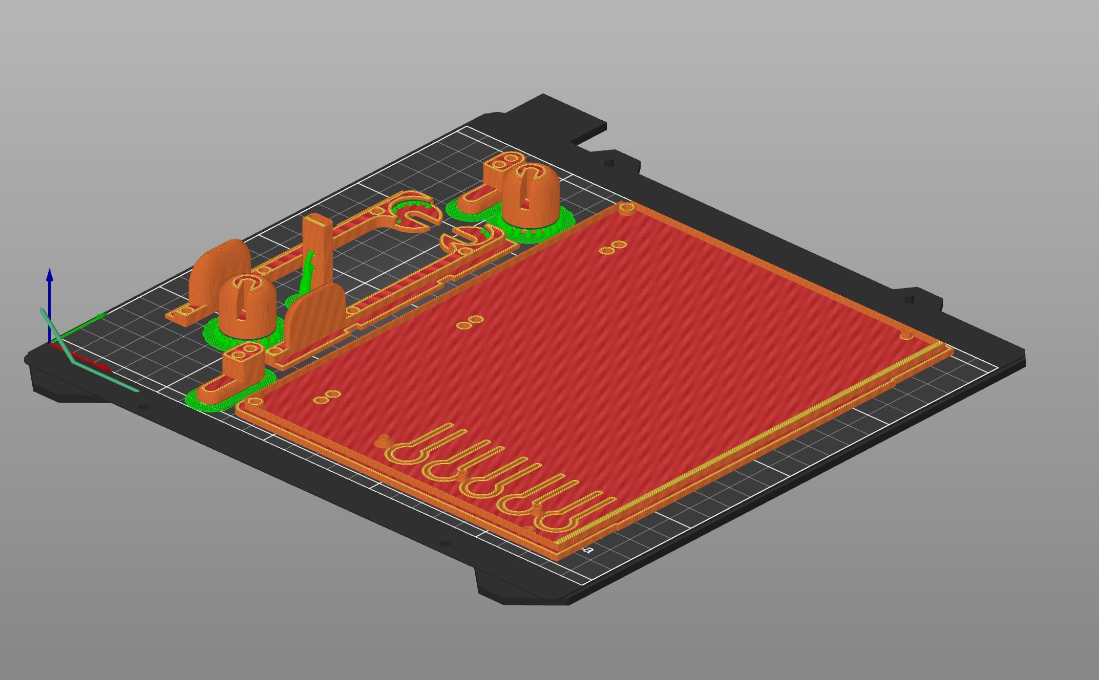

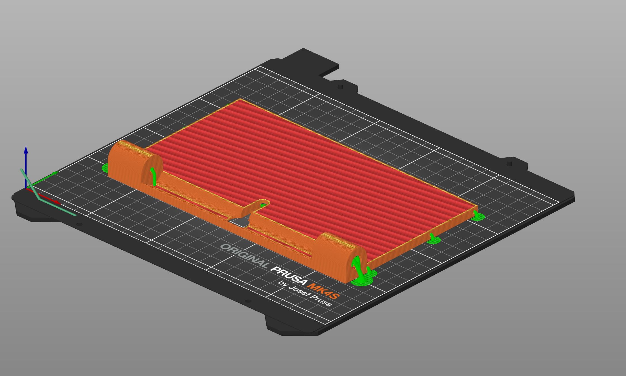

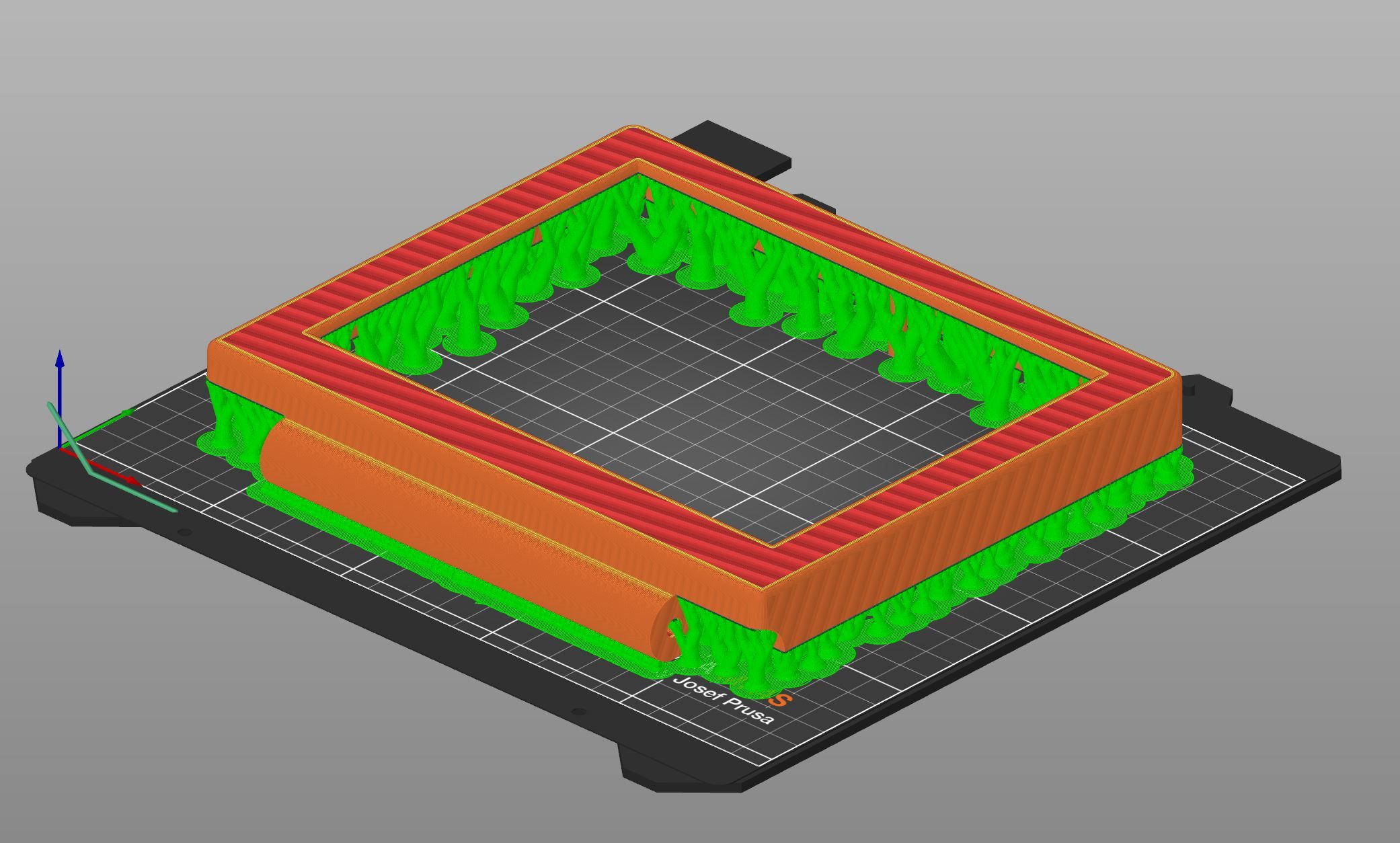

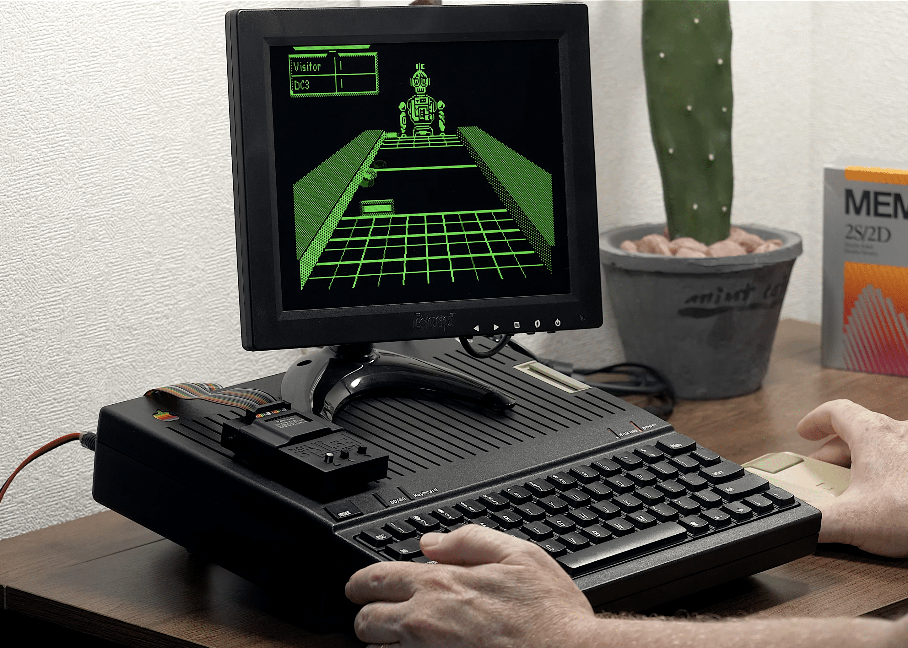

I like your idea better than my "as is" EYOYO because yours can be tilted more nicely, is collapsible, and won't slide off the top of the IIc.
Here's my setup ( @MacEffects black case)...
Your 8" EYOYO seems to be a genuine product, as shown here:
My 10" "EYOYO" is probably a knock-off because I cannot find it on the eyoyo website. I bought it off AliExpress here:
Reactions: ClassicHasClass
