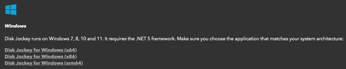

You'll be glad to know that I've just given the Windows version some love.
You can now partition your disk images and create HFS and ProDOS volumes. You can also inject existing volume images or add a bootable System 6.0.8 or 7.1 partition.
It's not parity with the Mac version yet. In my priorities, I'd rather focus the Windows version feature set on things that make DJ unique (like the partitioner).
https://diskjockey.onegeekarmy.eu
Reactions: Patrick and Mu0n
