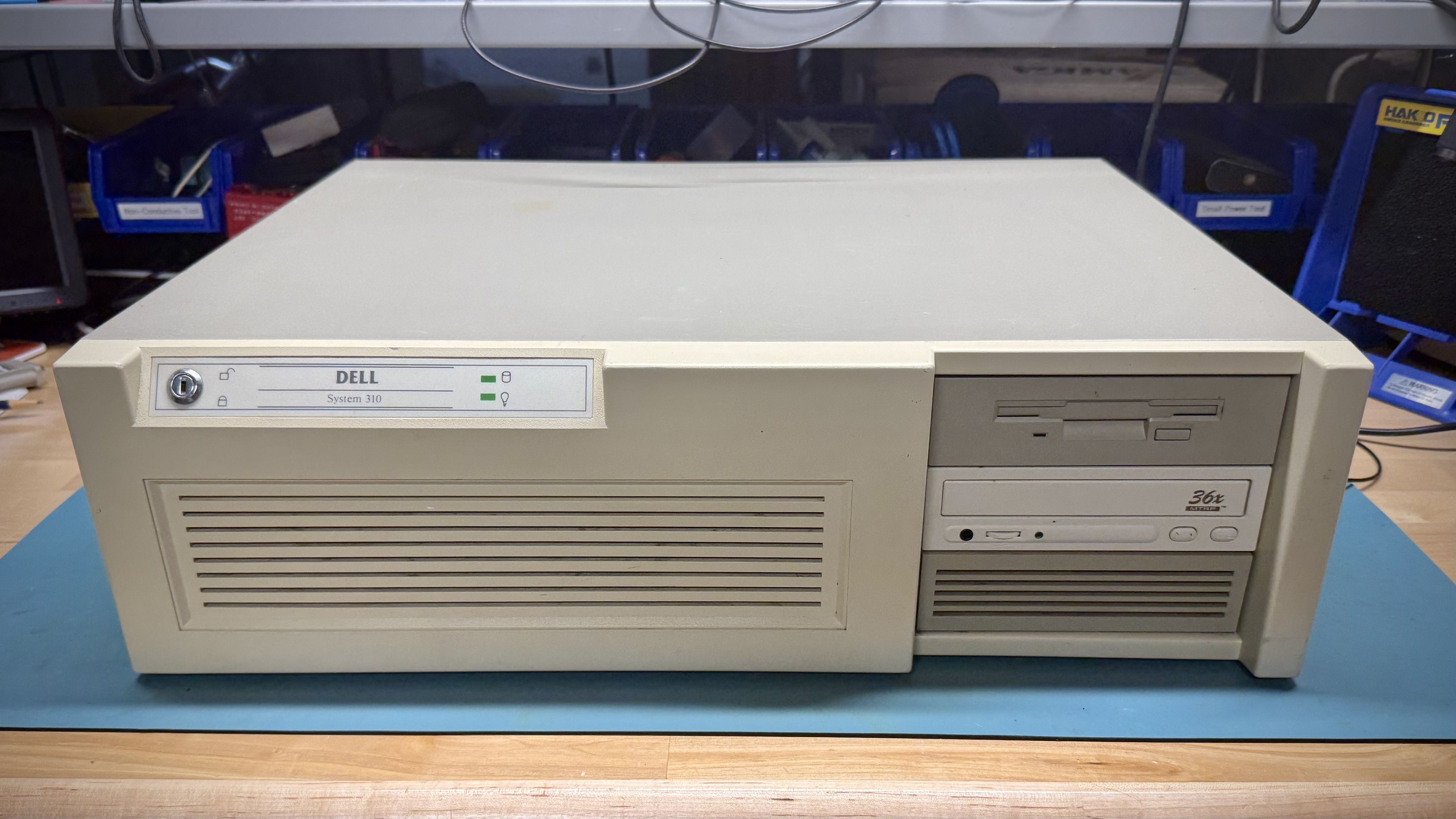

My company was cleaning out an old telecom closet when they decided to get rid of the "door stop" they had been using to prop open the door when working in the tight space. It was a Dell System 310, or so it seemed. The IT guys knew of my interest in old computers, and I was delighted when one day I walked into my office and found it sitting on my desk.

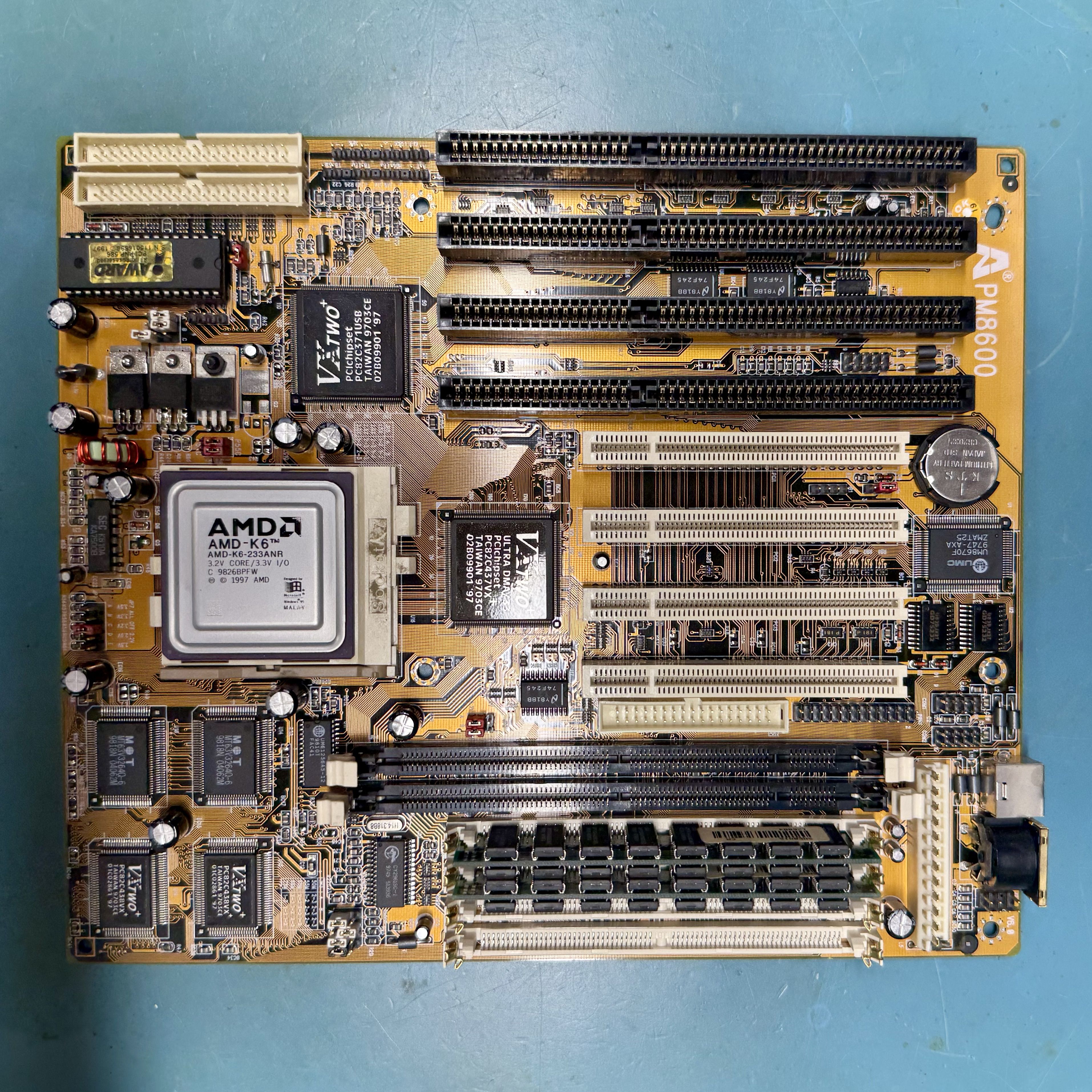

My excitement held until I got it home and discovered that its motherboard had been replaced. The original 1989 Dell motherboard with its 386DX was gone, replaced by an Amptron PM-8600 with a 233MHz AMD K6. I should have known something was up when I saw a 36x CD-ROM had replaced the original 5.25 floppy.

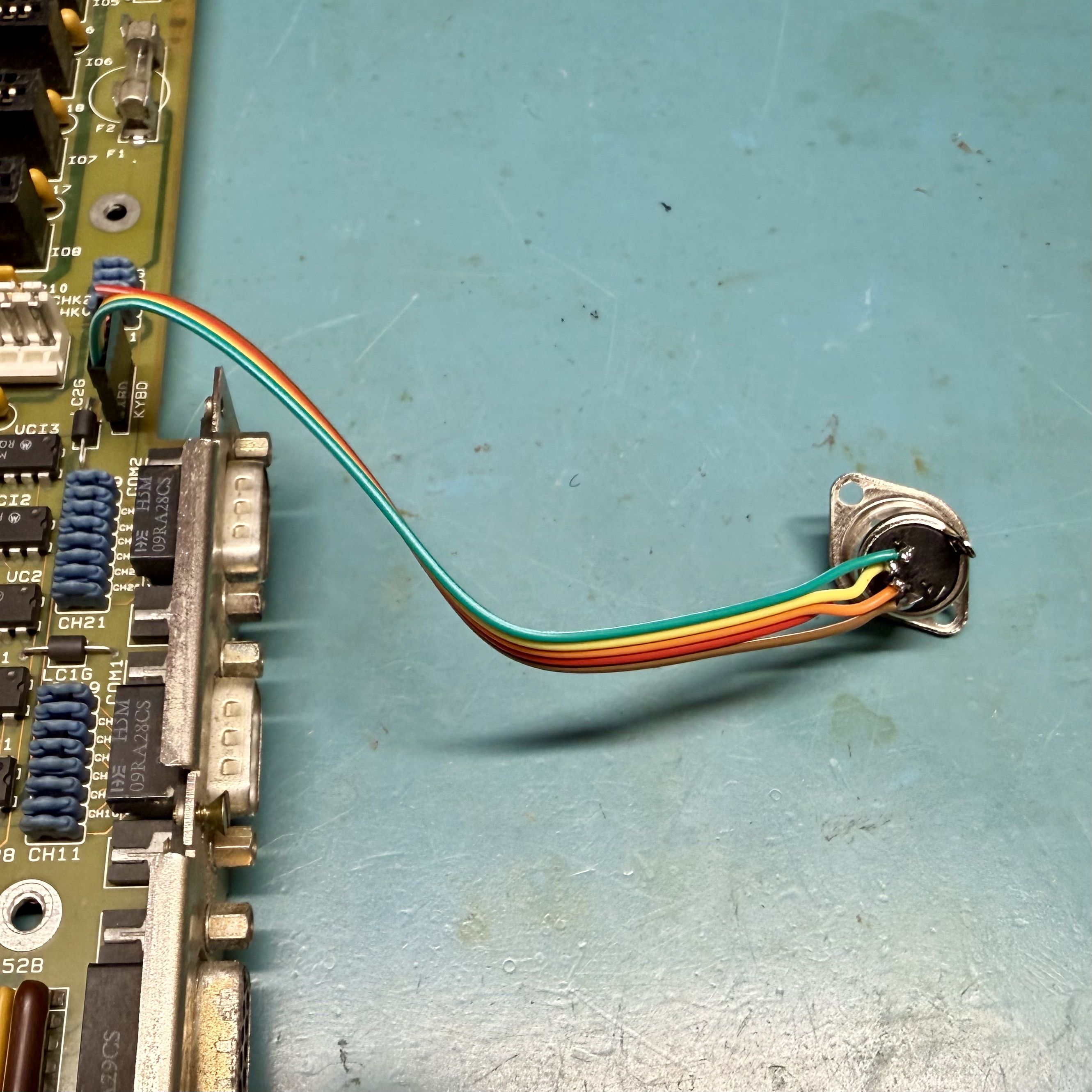

Now, I'm going to restore the computer to its proper configuration. The original motherboard looks good, though with plenty of tantalum caps waiting to pop. Its RAM is missing, but it should use standard 30-pin SIMMs — a real plus, considering many systems of this era used custom memory cards (it also has a custom memory expansion connector). One wrinkle is that the system lacks an onboard keyboard jack. The jack is supposed to be mounted in the case above the motherboard and connected using a 4-pin header. I'll have to figure that out.

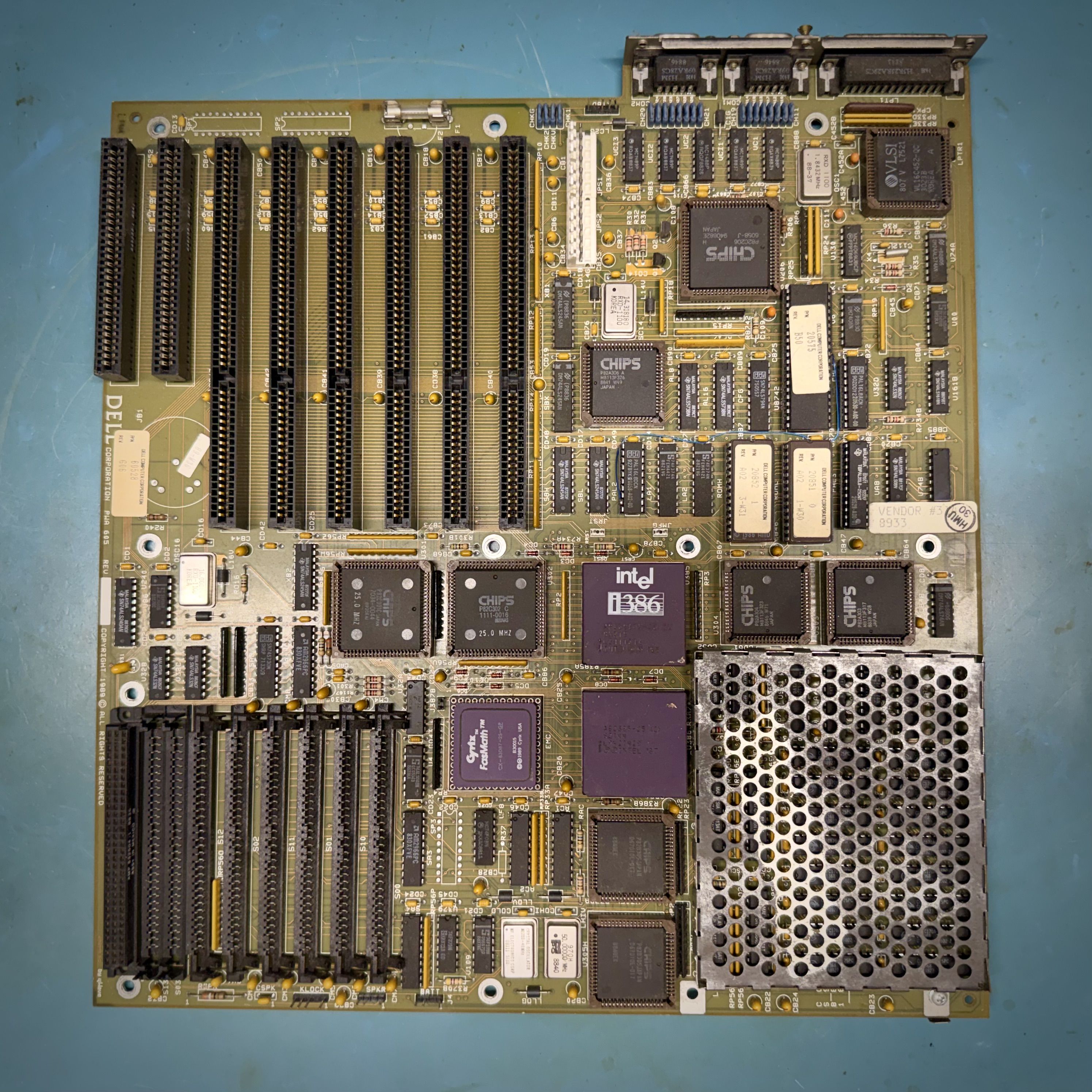

I did more research on the motherboard, and realized that I won't be restoring the System 310 to its original condition because I have the motherboard for its big sibling, the Dell System 325. The 310 is a 20MHz 386DX and the 325 runs at 25MHz. When released, the System 325 was Dell's flagship computer.
Luckily, I was able to find the original installation and troubleshooting manual on Archive.org. After uploading a high-resolution photo and other information to The Retro Web Discord, I sat down and studied the motherboard. It looks good, but when checking the AT power supply connector, I see the following:

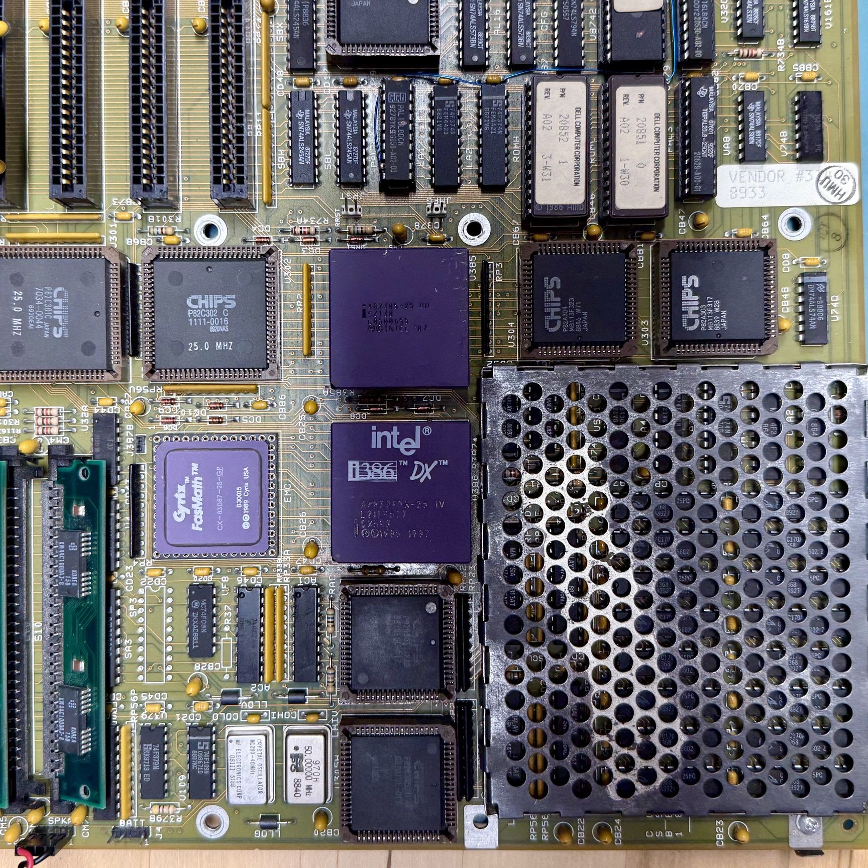

So, I have shorts on two of the +5V lines and the +12V line. I count more than 50 dipped tantalum caps and even more axial ceramic caps. Any cap I check is a dead short back to the power connector, so I don't have a good place to start. I tried removing a few of the caps nearest the power connector, and I found the ground plane makes it very challenging to get caps off the board, but when I lifted the positive leg, nothing changed.
Unless someone has a better idea, I may start with removing all the socketed chips, and see if that makes a difference.

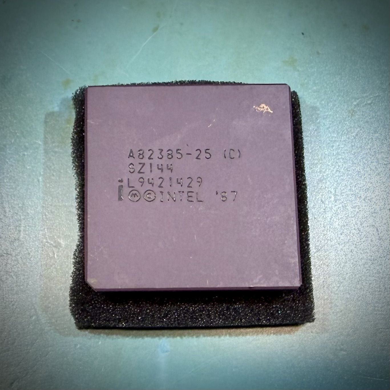

I found the culprit, and I was very lucky. I started pulling ICs, and I started with the 386DX, the Cyrix FastMath co-processor, and the Intel 82385 cache controller. I then tested for shorts before pulling more, and the resistance was up to 400 ohms on the previously shorted rails. So I reinstalled the ICs one at a time, and found that the dead short returned when I inserted the 82385. (With all the other ICs installed, the resistance was around 370 ohms.)
I tested the board by injecting current from my bench power supply on each of the previously shorted rails. Nothing popped or got hot at either 500ma or 1 amp.
I've now ordered a replacement 82385 from eBay, and I'm starting to think this board might boot.

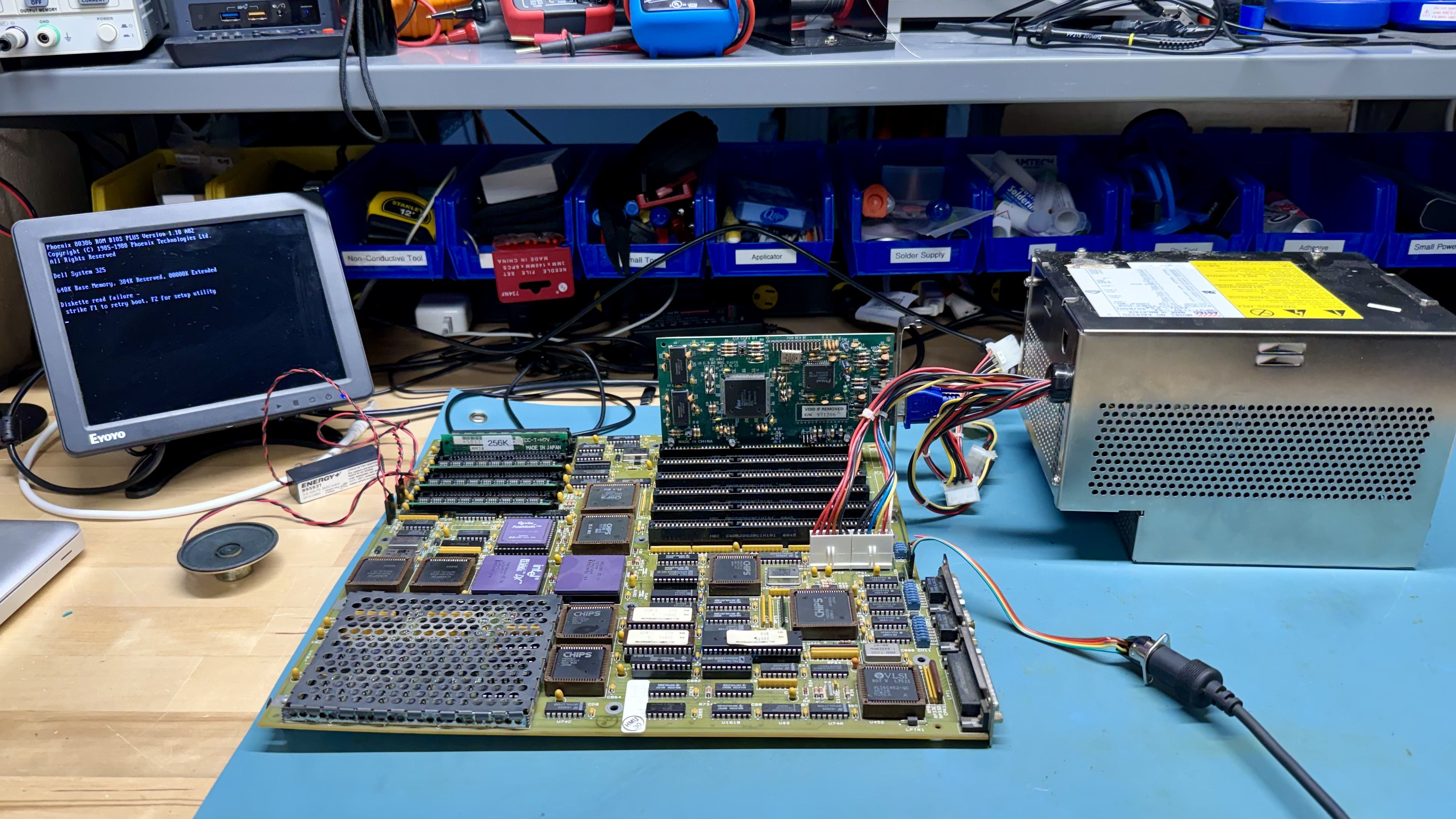

I opened the power supply and found it to be dusty and in otherwise good shape. I cleaned everything, oiled the fan, and tested the PSU. It ran just fine.
So I decided to plug it into the motherboard and see what happened--and nothing happened. The power protection kicked in. That got me thinking about something that had been nagging me. While removing the cache controller cleared the short to ground, how could removing the cache controller clear a short on the +12V line? And why do I have the same resistance between the +5V and +12V rails? Is it possible to have a short between +5V and +12V? What could bridge those power rails?
