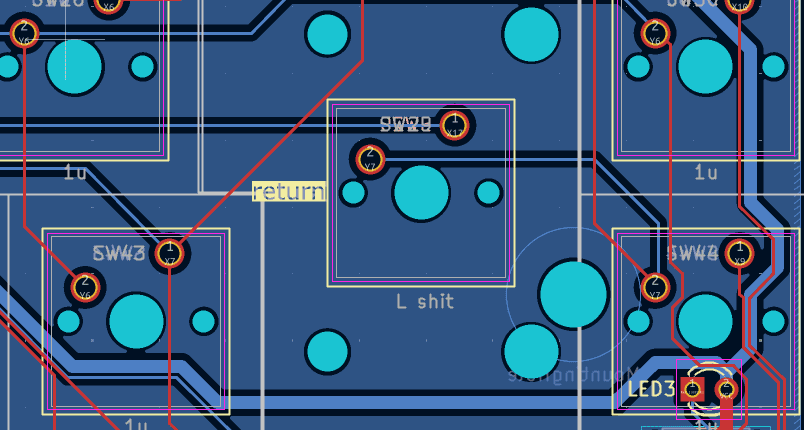

I'm considering to handwire the switches to the original ADK, but still use the Tester68 as base. So I'm now trying to get an idea how all the switches are wired for which the diagrams on GitHub are amazing. I took the ADK apart, but it has many plastic welds, so actually seeing the traces without breaking the keyboard is going to be annoying. To anyone with experience with the Tester68: how well are the keycaps retained in the plate itself?
Without a PCB I hope the plate keeps it all together and not my wiring.
One of the interesting finds in my KiCAD exploration thus far:
