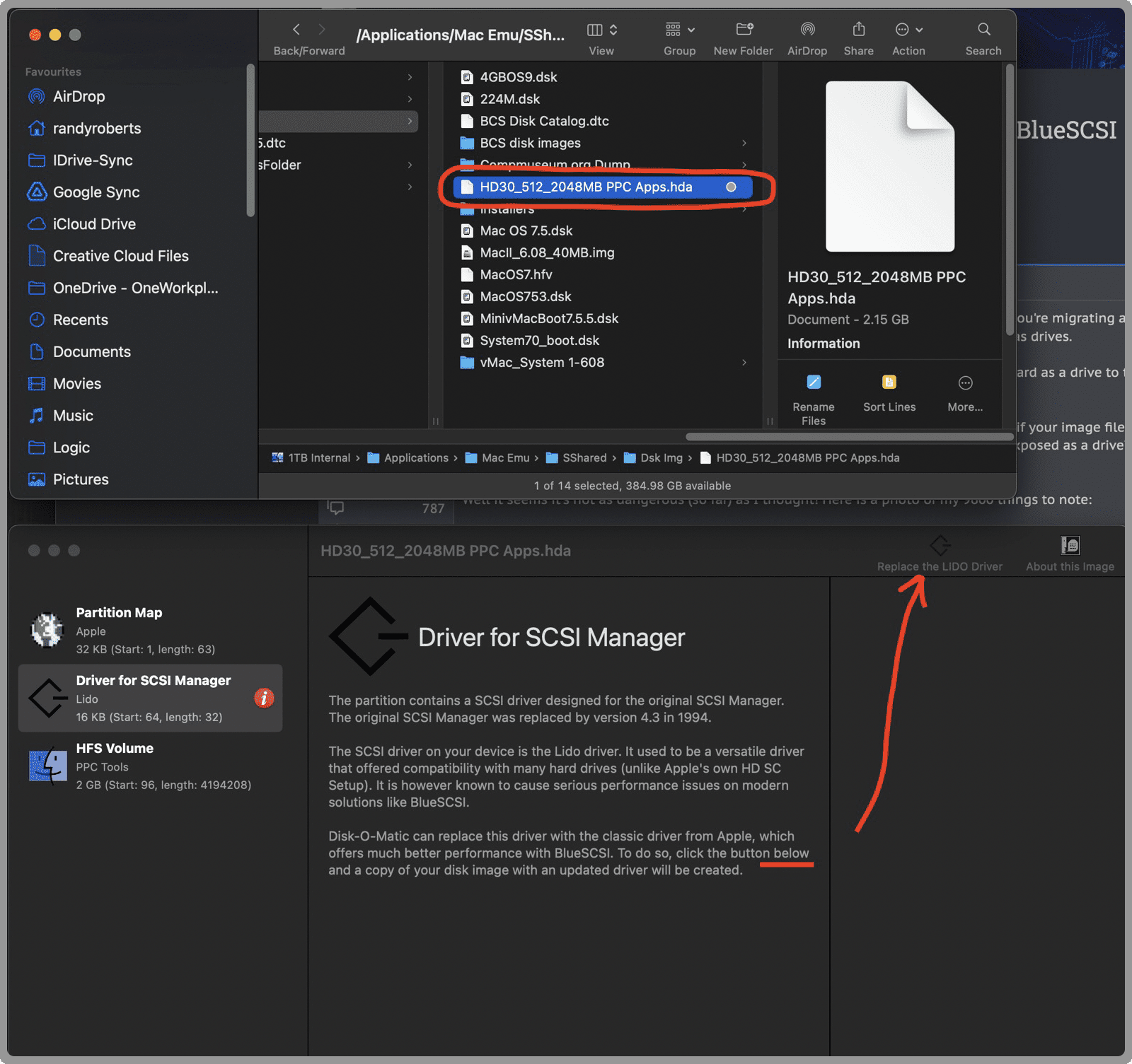

I absolutely do NOT see this as a complaint. It's a perfectly legitimate question :)

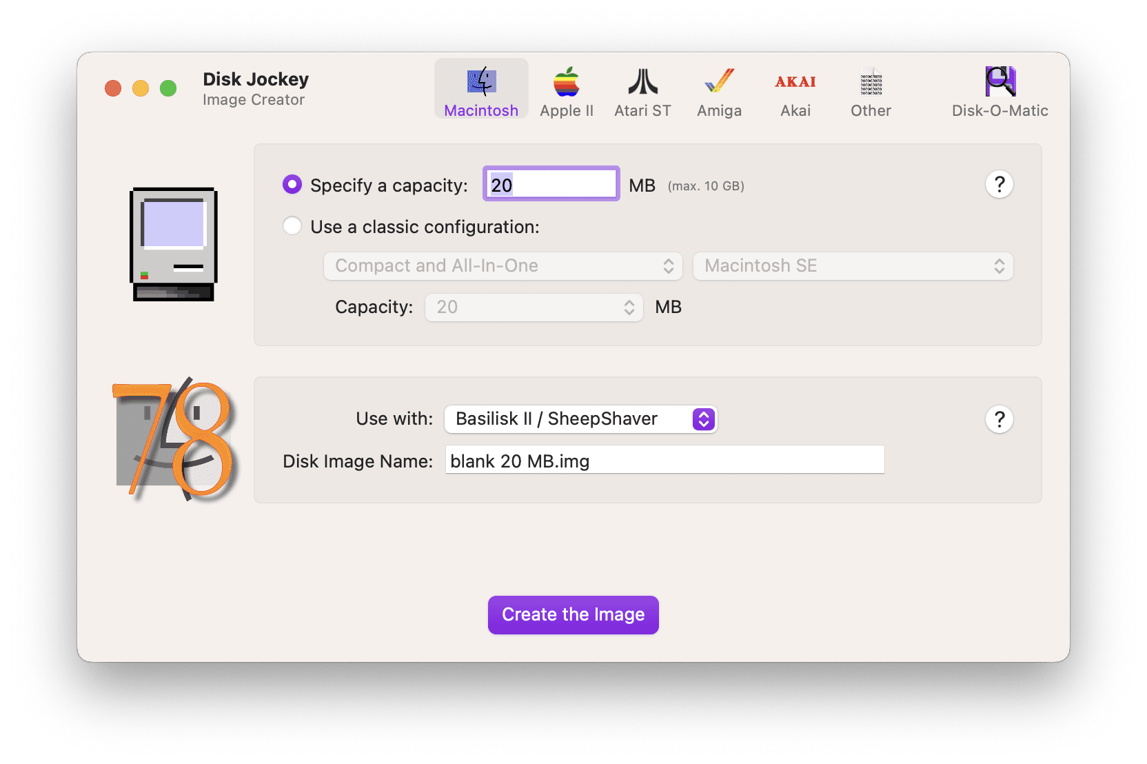

djjr is a good alternative. It can create new images: blanks (like dd does) or Mac devices with a SCSI driver and everything. If you only specify the SCSI ID you want, it will automatically generate a proper name for the output file. So, for example:
Bash:
djjr create mac-device -sM 20 --scsi-id 4
creates a new device image for Mac (with a SCSI driver) of 20 MB in size and will name it "HD40_512 20MB.hda”.

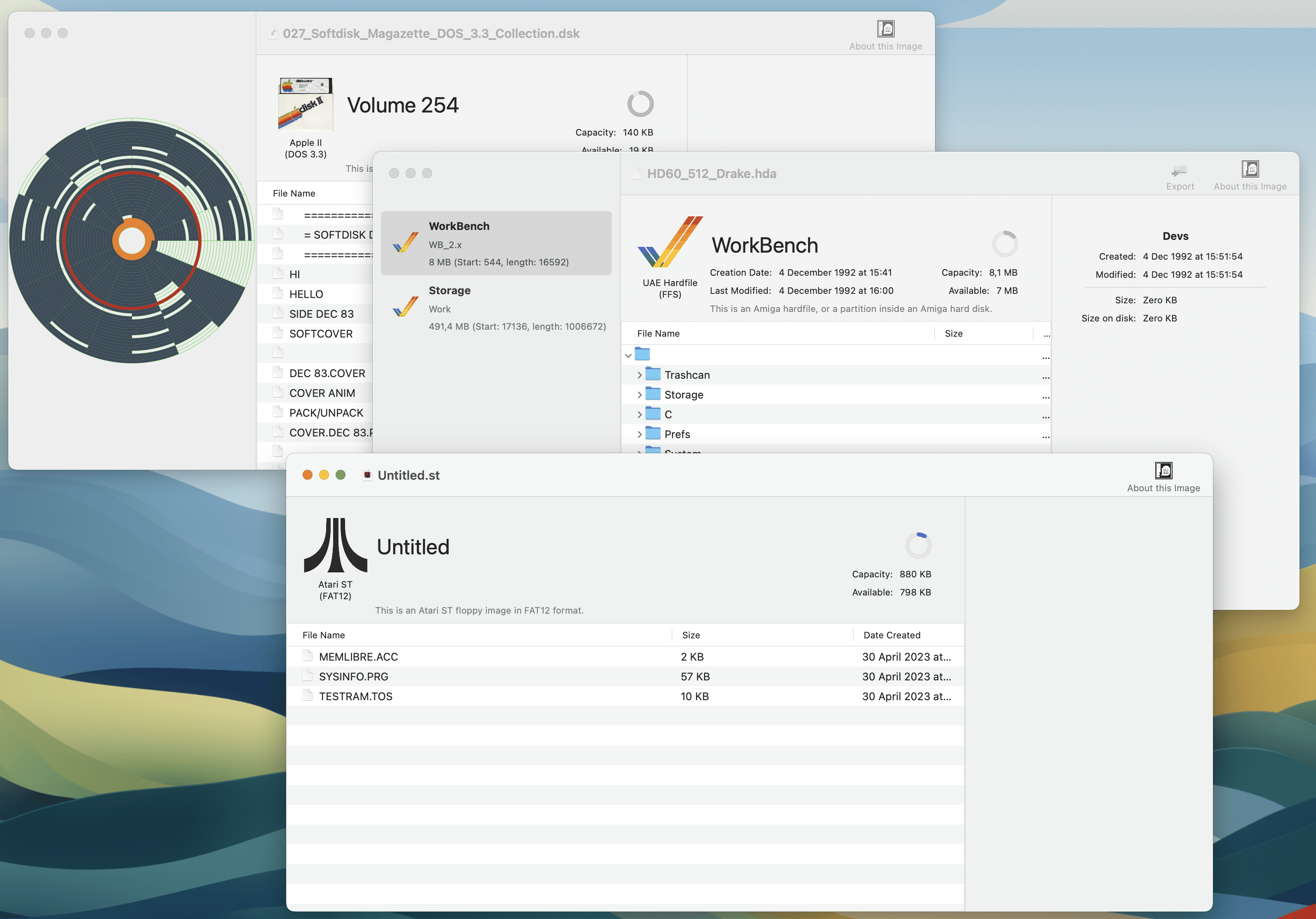

It can also analyze images (and dump all the details of your disk image as a JSON file if you want) and convert them: a volume image becomes a device image or vice-versa. And if you're suffering from the Curse of the LIDO Driver, it can substitute it for the standard Apple driver.
Here's a summary:
